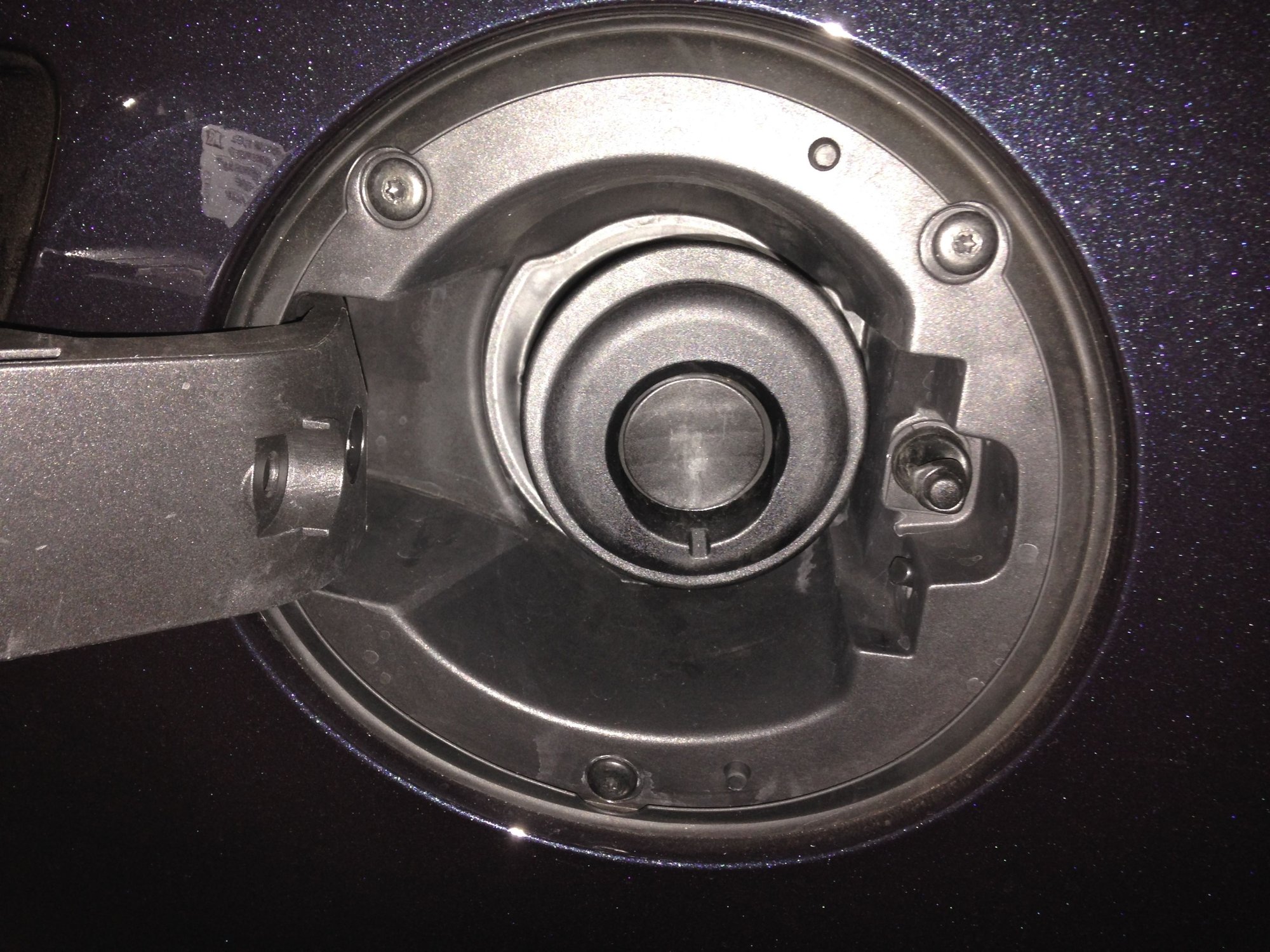

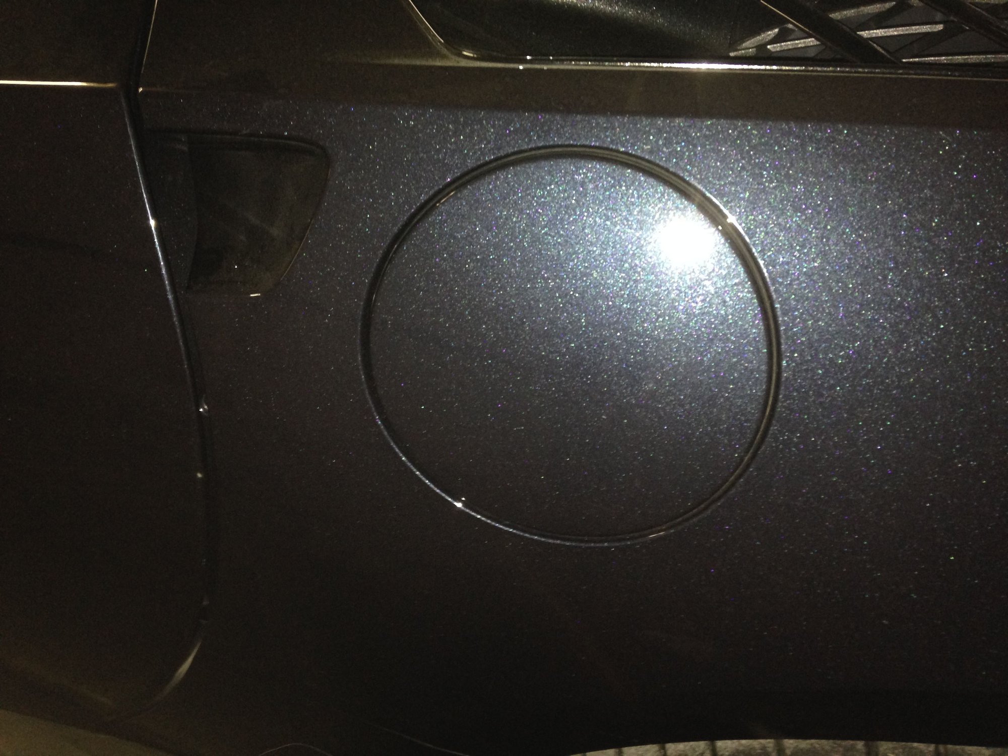

Thanks but the C7 doesn't really have a gas cap, it is just a hole with a latch in front, you juste stick the nozzle inside and pump the gas.
The light is off today i just refilled the tank last night, but has soon has i'll get to 1/2 tank the light will come back on.....Anyway let's hope i'm wrong and i don't need to take it back to the dealer for that
m
No gas cap !

not sure what I was thinking. I know there's no gas cap. However, the opening where you put the gas in must have a seal and possibly that seal is bad.
What is that called (the little hinged opening)? The gas flap?
Check the seal for small obstruction/dirt that might hold the "flappadoodle" slightly open enough to cause improper seal.
