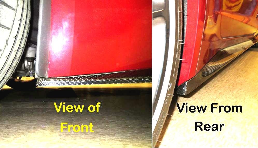

About 5k miles on carbon flash lashway skirts and splitter .......are fine. Its paint, nothing more so its just like your front end. My leading edge is xped'd, many xpel the whole thing.
