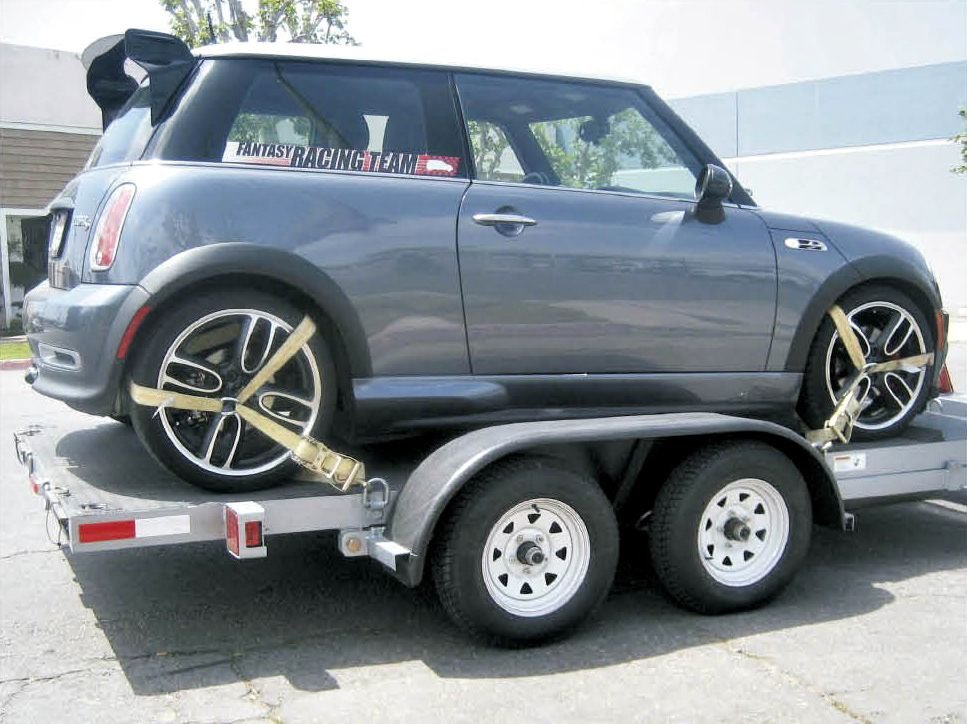

Get some thru the rim straps from Mac's Custom Tiedowns. Easy and safe way to haul a car. The rims are probably the strongest piece you can attach to. As long as the wheel openings are big enough, I always transport cars that way.

I trailer mine several times a year (from 600 to 1,200 miles each trip). Best method of tie down I found was putting the straps through the rims and back to the ratchet point. Each corner pulling in opposite direction keeps the car perfectly stable and this method was the fastest way to tie down, plus it was easiest way to monitor tightness during the trips. To eliminate any chance of "marking" the wheels with the straps I put a towel between the strap and wheel... Avoids any rubbing marks.
Wheel straps used to take me nearly 2 hours to attach, get right, tighten down and wiggle into the tight sides of the car hauler.... Doing it by putting the straps through the wheels and back to the attachment point takes under an hour and with no struggles. There is also very little tightening required during the trips.

Strapping the wheels down is the correct method. You DO NOT want to compress the suspension by strapping to the frame, let the car move on it's suspension as it's intended to. The loads placed on any sprung hard point can be intense when it's trying to hold down 3600 lbs and could easily rip the tie down points out of the trailer floor. When you tie down the wheels/tires there is no shock load, you are simply preventing the tires from losing contact with the trailer floor, the suspension of the car absorbs the load, which is what it's designed to do.
If you look at the way all the top tier car haulers secure the cars you will find then simply run a strap up over the tires to secure them to the floor of the hauler. Of course their trailers are designed for this with tracks where they can put the tie down points where they need to be.
This is what that looks like:
If you don't have a track where you can hook the straps where needed a tire cradle like this works well too. I like to keep the side force at a minimum and try to get most of the tension applied to holding the tire down, not pulling it to one side or the other.

I use the puck holes for the rear straps, kriss cross to D rings in floor. I use tire web across front wheels, car is backed into car hauler. Being a M6 C6 I winch it in to save the clutch. This is the way I plan to do my new Z06, but won't know if it will work until she gets here 1st week of march.

Ditto that. There is no load on the suspension like you would have attaching to the body. It will not mar the wheels. Just be careful if you cross the ties in the front.
