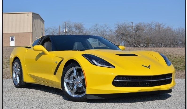

Here's a pic.

Looks GREAT -- I like the VY. Like I said, you will enjoy the heck out of it.

Thanks!! The last 4 I've had have been yellow, 2000 MY Conv, 2007 Z06, 2013 Grand Sport Conv, and this 2015.

gorgeous car!!! Really like VY - one of three finalists for me.
