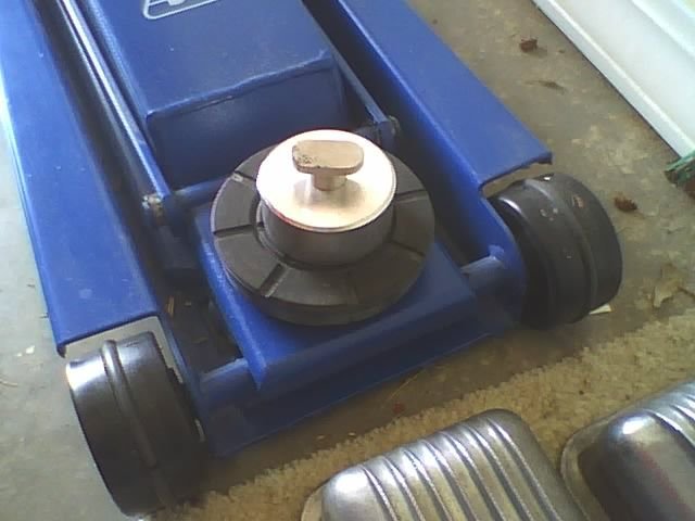

I made my own pads as soon as I got my C7. I made them less than the 2 1/2 inches OD mentioned in the Owners Manual (page 10-4) unlike the 3 inch OD ones I had for my C6 (my early view of a C7 at Laguna Seca in August 2013 and my own car showed some slots were much closer than my C6 slots to the rocker panels.) However I soon added side skirts that require higher pads/pucks to be sure my own jack or service lift arms cleared them. I bought mine from KaTech and they have both a 1 inch high and 2 inches high and 2 1/2 inch diameter model as does Reverse Logic mentioned in an above post. Katech had made there pads fro C6 Z06's that had side skirts. I like the feature of the Reverse Logic pads/pucks of being able to assemble them so temporarily they can be tightened and put in when bringing the car for service. Mine are just used at the time of jacking and must be removed to test drive etc.
I put my pads on the passenger seat in a clear plastic bag with a note. Will they be used? Can't be sure but I make whoever is going to work on the car that they must be. Cracking a carbon fiber side skirt would be a major issue. However if they crack a rocker panel you'll have to look after the work is done to find it!
To reinforce the need, when I got my C7 in October 2013 I received a GM notice to bring my car in to check the differential fluid level. I went to our local large Chevy/BMW/Mercedes dealer and talked with the service scheduler who I knew from work done on my C6- great person.
I mentioned I had my pads on the passenger front seat and to be sure they were used. She said; "Don't worry I will be sure they use our drive on alignment rack! We just cracked a Vette rocker panel and had to replace it!" They have about 12 center post lifts that require 4 arms to be placed on the frame and jack pads are needed so the lift arms do not touch the composite plastic rocker panels.
My home made pads 1" high x 2" OD: KaTech pads purchsed after installing CF side skirts, they are 2" high X 2 1/2" OD.
