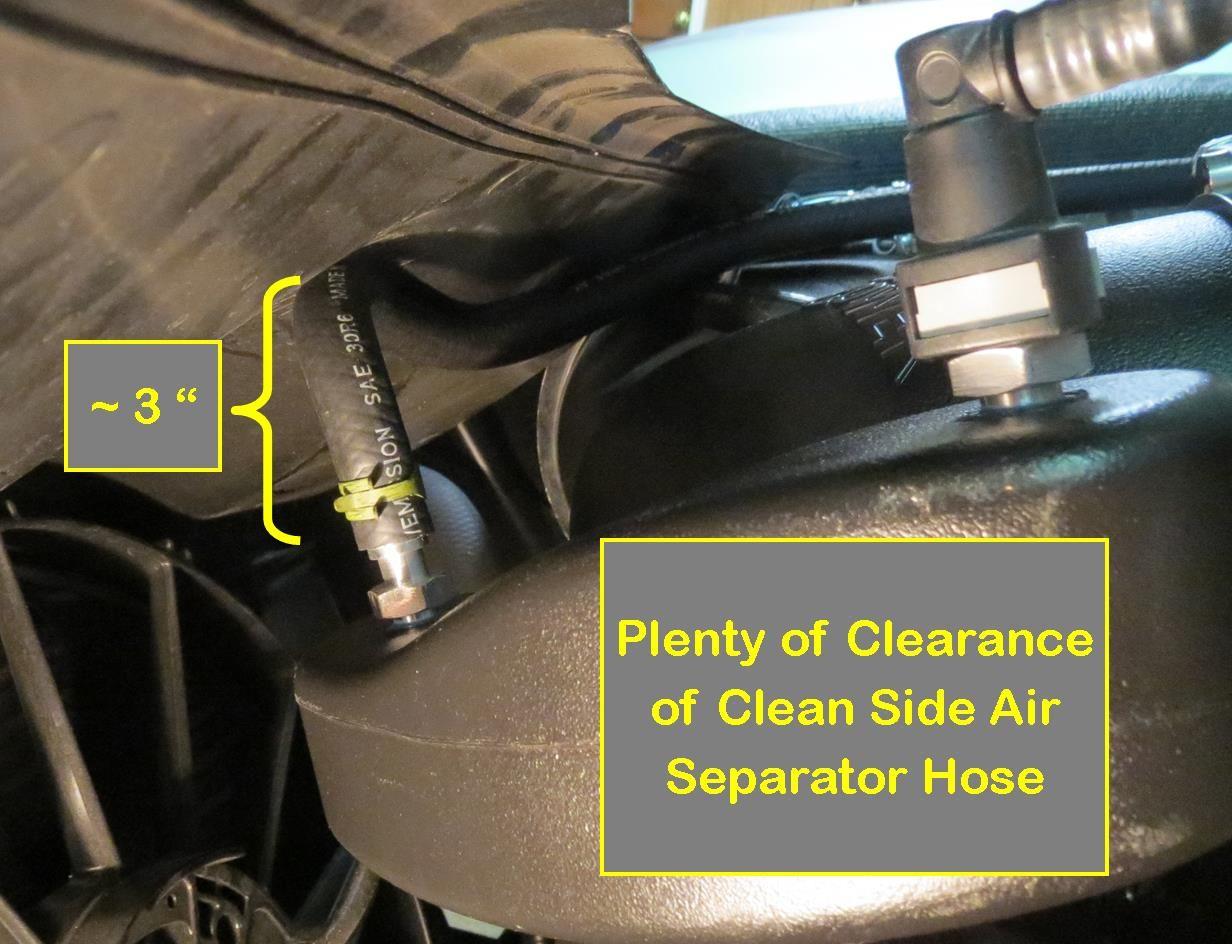

Below is a pic of where my clean air oil separator air vent hose goes. Bit different shape with my aFe Cold Air Intake System than the OEM but same location.
Dry Sump Air Vent Hose Shown on Left with ~3" Clearance.

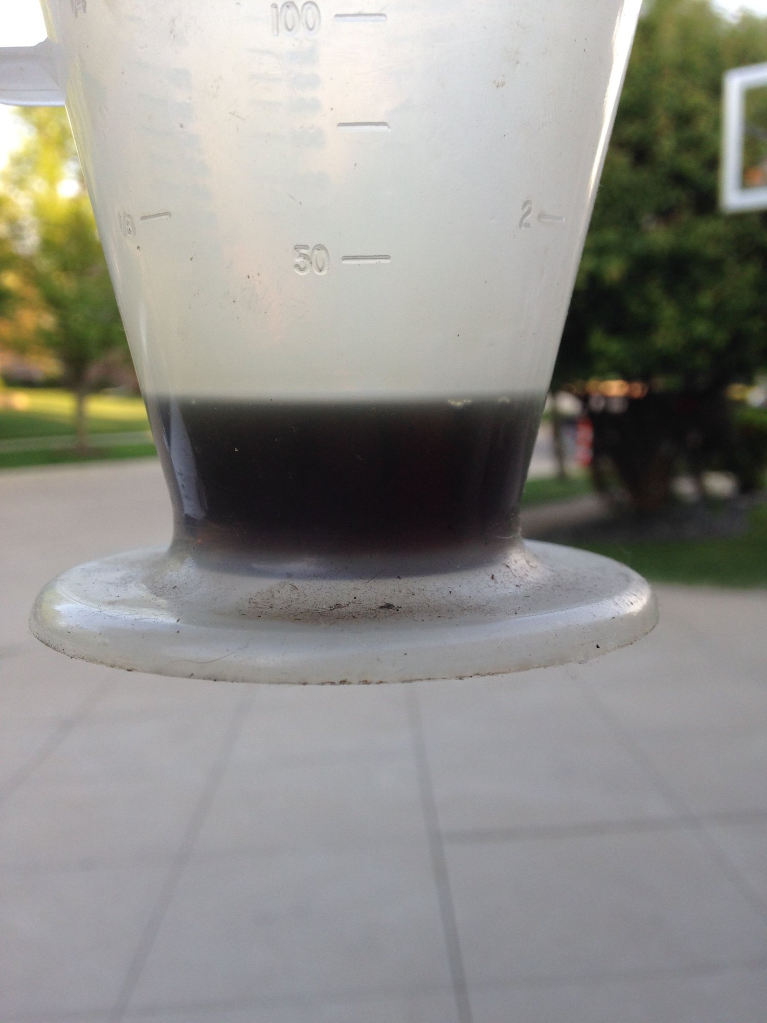

I agree very odd... Can you post pics of your install including exactly where each hose goes.
I too have the Elite E2, and my results are about 1oz every 1000 miles.
