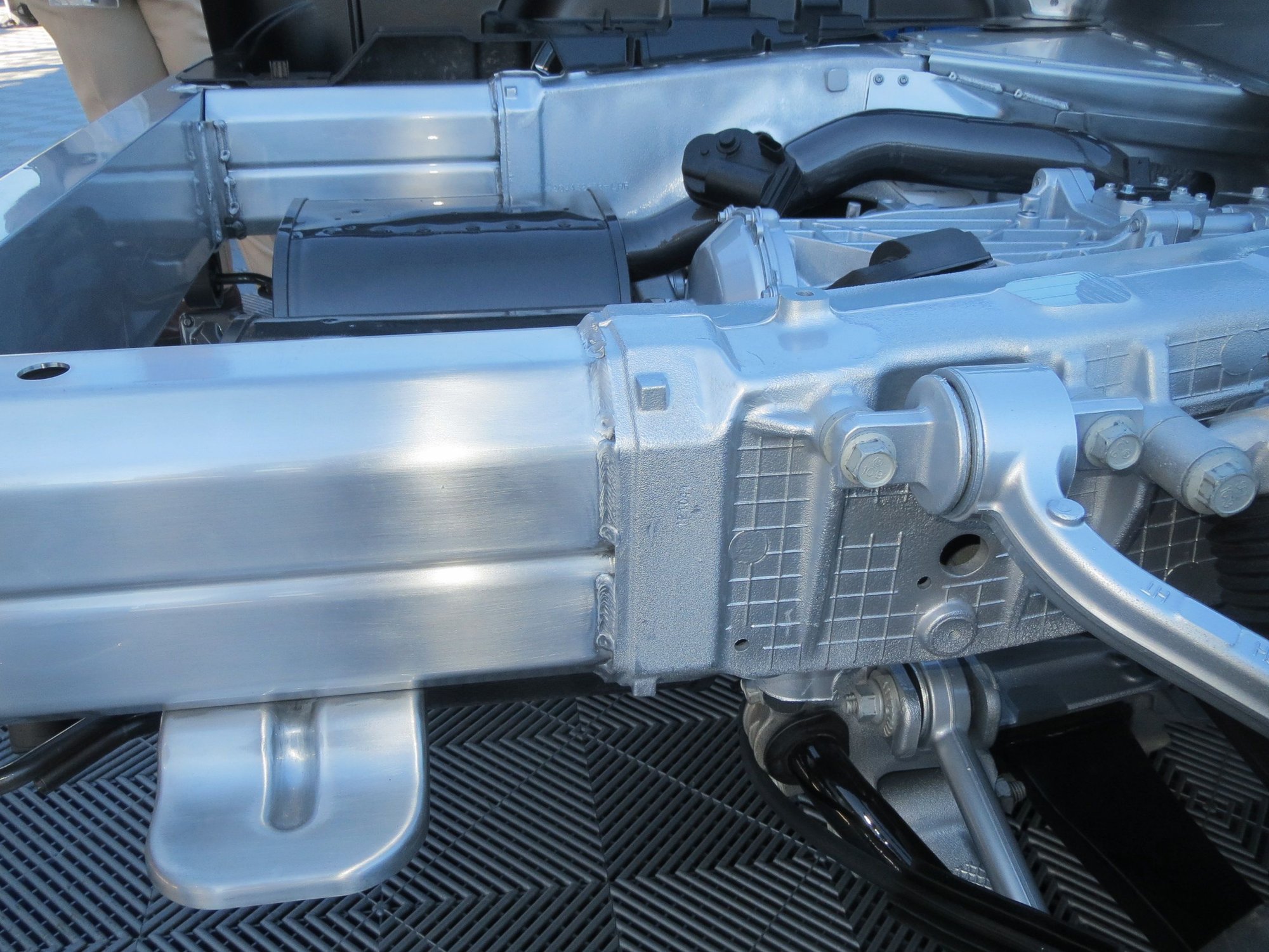

Sorry, have no info for the C7. As far as repairing the side frame, where the aluminum C6 Z06 had a one piece hydroformed aluminum tube that had to be purchased as the full length piece and then cut and welded replace a damaged frame section, the C7 had 8 parts that are welded together. Most of those welds are MIG welds versus the spot and laser welds that are are also used.
Below are a twopics I took at Laguna Seca in 2013 on a frame being displayed. Should be possible to remove these welds and and weld in new sections. However just what parts are offed for sale would have to be determined.
A good example of what should be repairable is the front and rear perimeter frame sections designed to crush in a crash that are welded to the cast sections that hold the suspension arms.
There are some resistance welds that are unique to GM, who developed a patented electrode that produces the concentric rings seen on these three welds. These would have to be cut out and a MIG plug weld used if those sections are available for purchase.

Thanks for those pictures they will come handy.
Can you tell me anything about or show pictures of the tub in a perfect state and a damaged one. And finally, how bad does the tub need to be in where it's job of holding the mid section to the rear section is compromised. Do you know I can find a expert down here in the south Florida area, maybe someone in the forum.
I have no direct information. However I recall there was a post about the tub and some comments about installation. As I recall it comes in one large piece and attaches with adhesive.
I did save a few pics from that post that was about a year ago if I recall correctly. Posting those below. They may be of help.
Sorry have no contacts, my tech expertise is welding not collision repair. In that regard GM requires the use of a special MIG process, called Pulsed MIG Welding and not every body shop would invest in this expensive welder or the training to use it. There should be a way to find out who is certificated to repair a C7 frame. I'd start by asking a large dealer.
