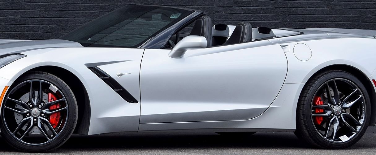

yea... If it was $285x4 that might be a bit much. Looking at all the little rock chips on my wheels after only 3800 miles has me thinking about what to do when they start looking beat up
Add: Here's a pic of the black chrome on Z51 wheels. Not too shabby. Was having trouble resizing the pic with the Windows 10 paint app, so I hacked off the ends to keep the size reasonable. You get the idea:

I'm liking those too, that looks good. For me to ship, be without rims, coat and ship back, new might be a better option. I'll call my local powder coater maybe they can do it or know someone closer. I'd like to see them too, I could see those looking really different in person.
