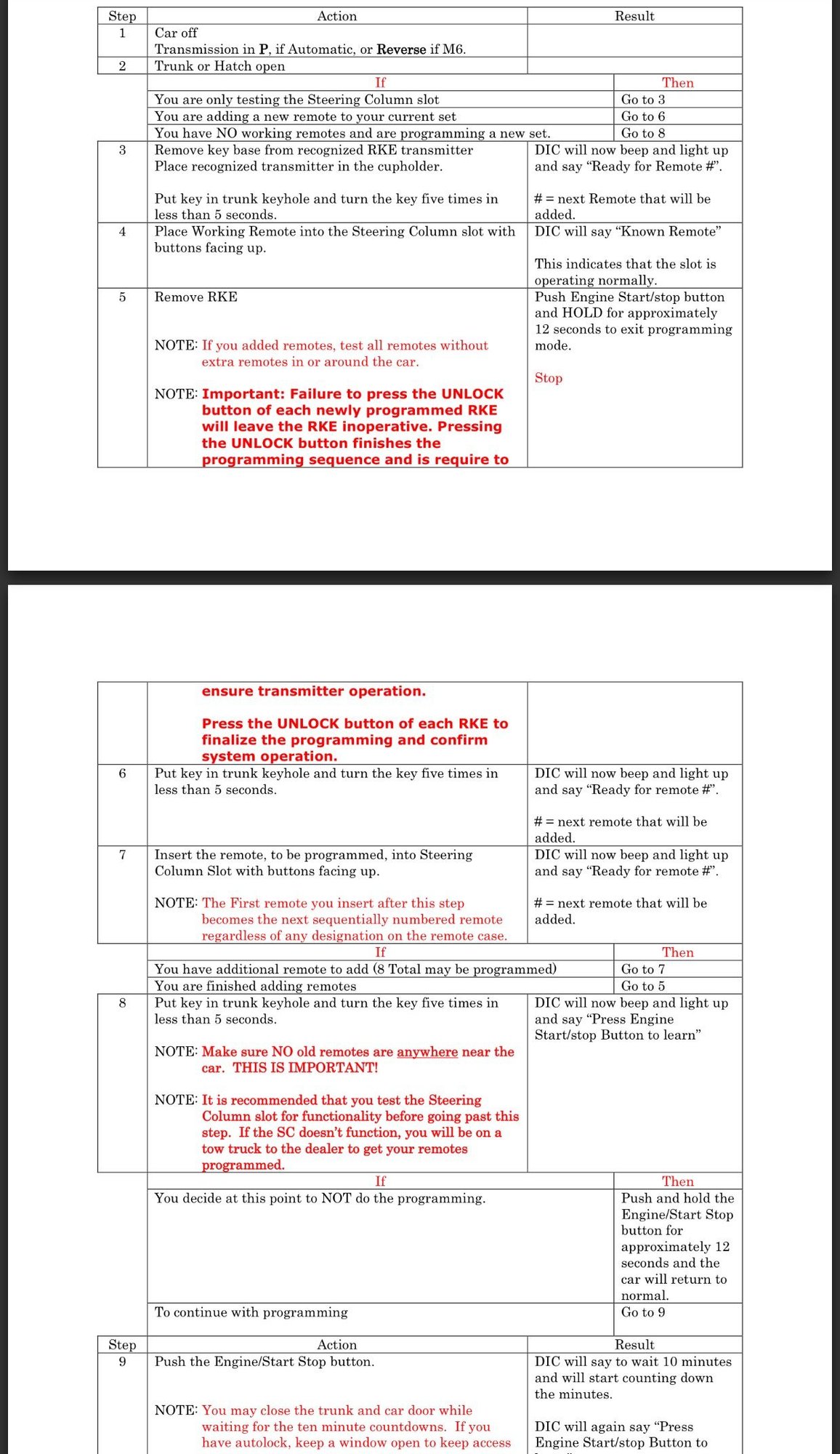

Ok about to give up on this. I tested the steering column slot to make sure it was working. Used #3 in these manual instructions(pic below). After key turns the display stated ready for remote 3. I put the original FOB in the column, every direction possible, but it would never state "known remote" as stated in the manual. This shows me that the column slot was not working properly.
So to test the column slot again I took out the battery of the original FOB and put it in the column slot to see if the car will start. It started! So that shows me that the column is working. Completely stumped. I feel like I'm doing something wrong, but I followed the manual to the "T" multiple times, and nothing.

If you can't get step 4 to work, I'd have the car checked. It should acknowledge your working RKE.
Elmer
