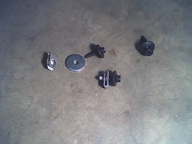

I used OEM bumper cover screws to attach the leading edge... stronger than plastic rivets and require only 1/8" hole...Use 1/4" plastic rivets only in the two center holes than cannot be reached to use a nut inside the bumper.. (use factory u-nuts because the bumper cover screws are an odd thread size ( M4.2-1.41 with 17mm washer) and are self-locking)
