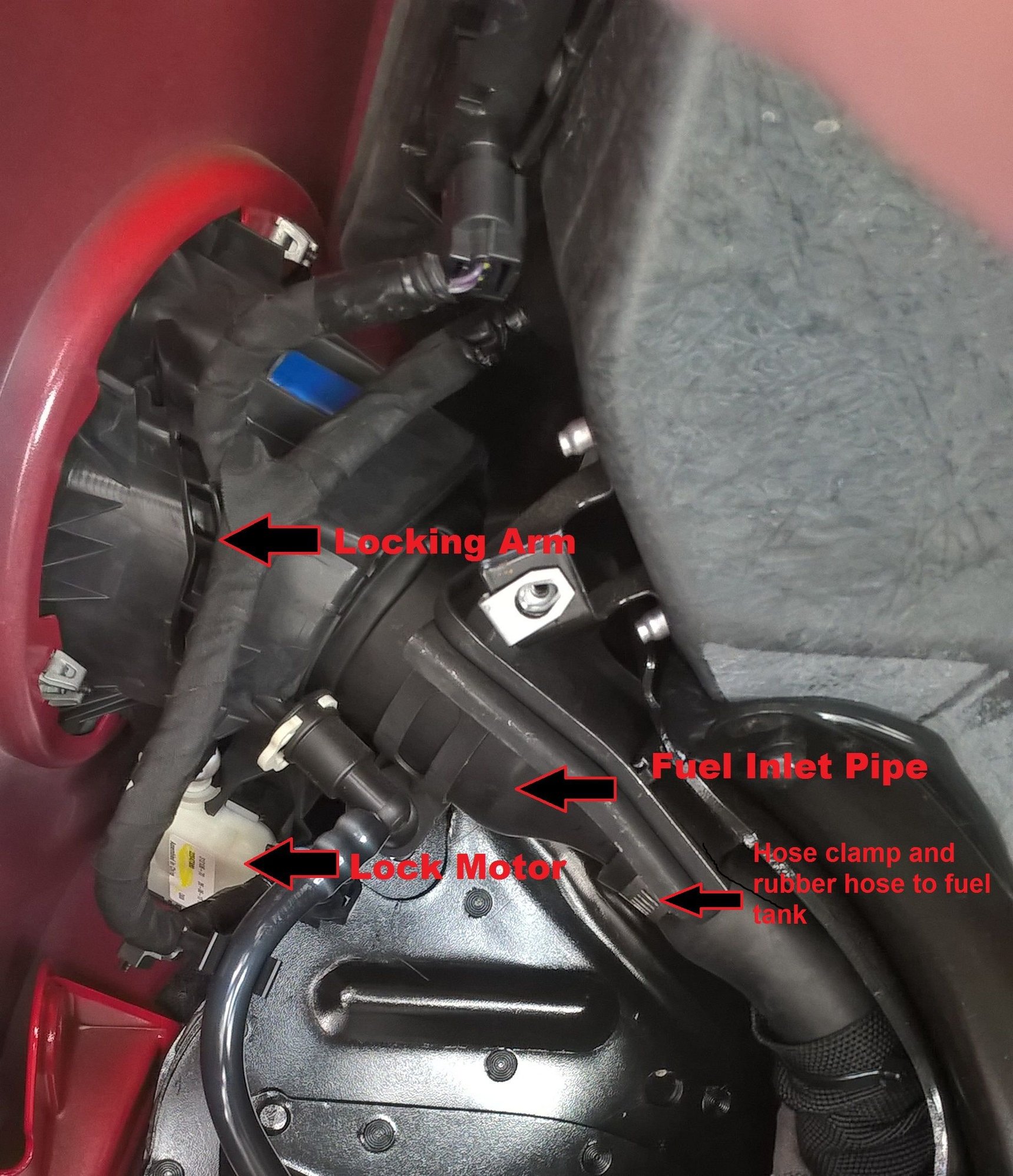

Anyone have any problems with door locks? 2015 z51.5000 mi on vehicle. Electric door unlock increasingly loud and grinding.theres always been some sound which we all hear.Eminates from just behind drivers door even using passenger side. Mechanism works but noisy sounds like something needs lubed.Havnt asked my dealer yet(not sure I want to,if you know what I mean!)

It's not the door lock, it's the solenoid locking the gas cap. That's why you hear it on the drivers side. If you're going to have your dealer look at it, they can check that mechanism.

Bumping an old thread because I remember seeing some people talk about this before and mine is starting to get loud also. Does this fail without replacement or just stay loud?
Anybody have a link to the solenoid part and replacement instructions? I am at 3+ years/32k miles and out of bumper to bumper warranty.

There's many more but check out this thread:
https://www.corvetteforum.com/forums...on-t-open.html
Most people just disconnect it

That won't stop the noise...
Just take fasteners out of wheel well liner, reach in, and unplug the fuel door actuator..If the noise goes away, that was the problem..
I got tired of hearing the actuator cycle multiple times, and was afraid it would fail with the door locked, so I just removed the complete actuator..

This sounds like the way to go... If you unplug this, will it always default to the "unlocked" position or do you need to unplug it when it's already unlocked?

Took out my actuator today. No more noise... Good to go
