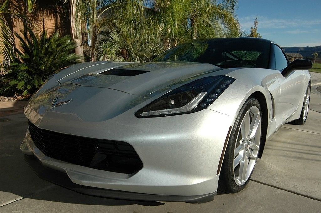

I have dropped mine the full amount (1") on stock bolts and still have enuf room to clear anything I have run into, including speed bumps and any parking ingot. YMMV....another member's car dropped just like mine, also with Lashway splitter:

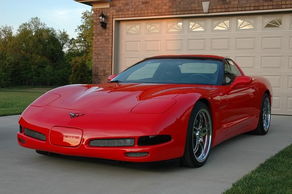

My C5 and C7 are both lowered as far as possible on the stock bolts and it's definitely easier to get the C7 over speed bumps and up my challenging driveway without scraping. I think my C7 looks lower than my C5 but I think it was designed with better obstacle-clearance in mind.
