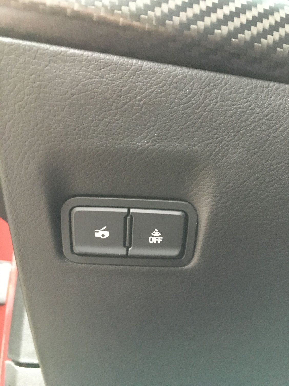

A follow up:
So, I finally got the dealer to check this out for me. According to them, it's working the way it should. ...ohhhkayyy... But, they showed me that the switch can be accessed and unplugged. Here's photos:

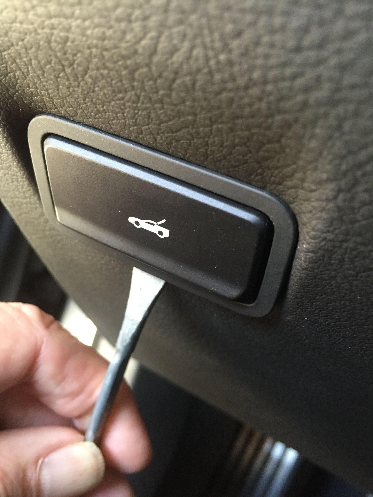

I'm using a paint can opener tool.
I've inserted the business end of the paint can opener into the space just under the switch housing.
The housing will pry out.

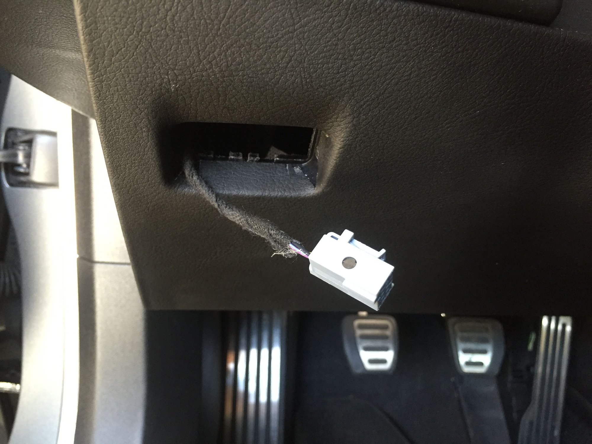

Disconnect the plug from the switch...

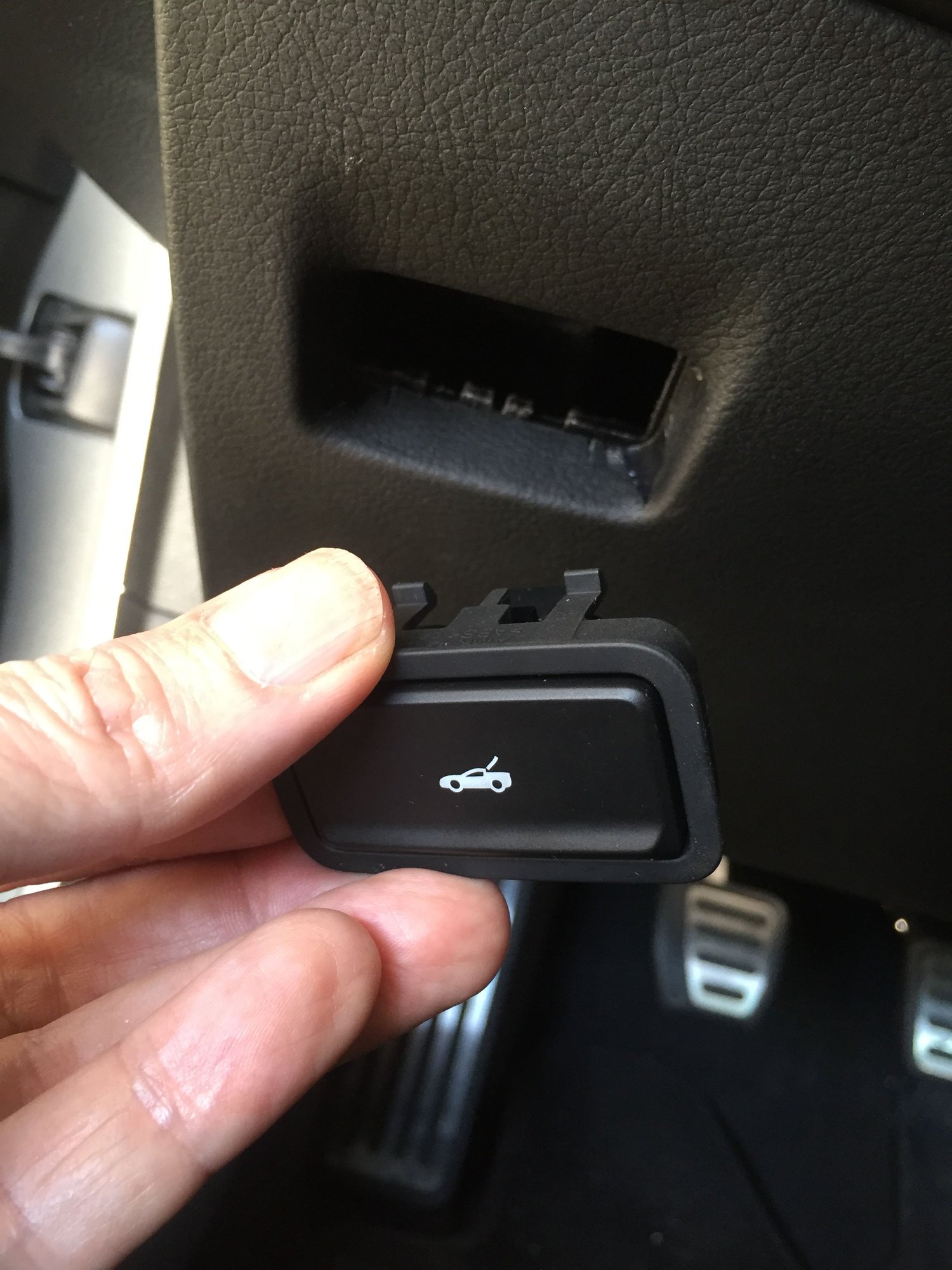

...shove the cable into the hole...
...pop the switch back in. And voila, no more trunk switch!
