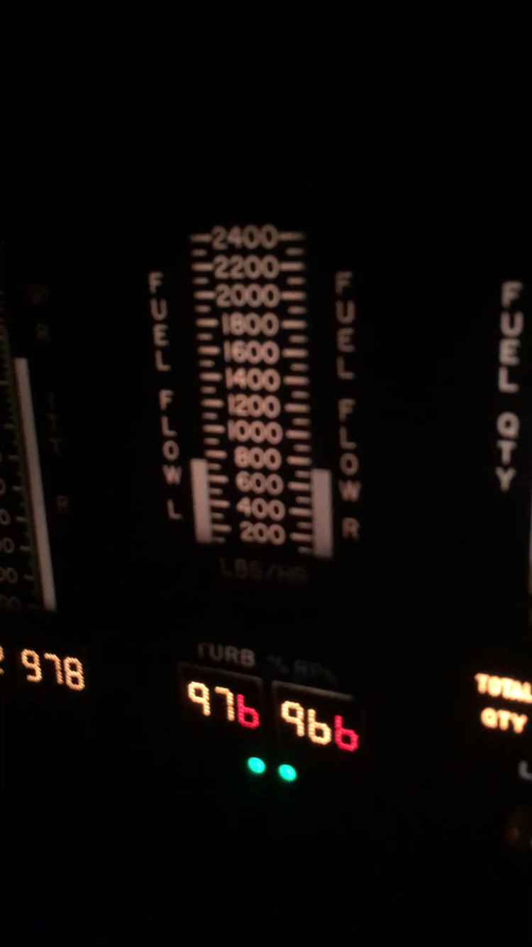

Screw any politician who talks about "Carbon Footprint". A lot of them fly around on private planes. I flew a trip last night from Venezuela to Fort Lauderdale and I was burning about 4 gal per MINUTE or about 2.3MPG if I did my math right
1500PPH at 6.8lb/gal = 221 gal/hr
At 440kts = 507mph
Thats 221 gal for every 507 miles.
Thats 507/221 = 2.3MPG.
To 4 cylinder mode
