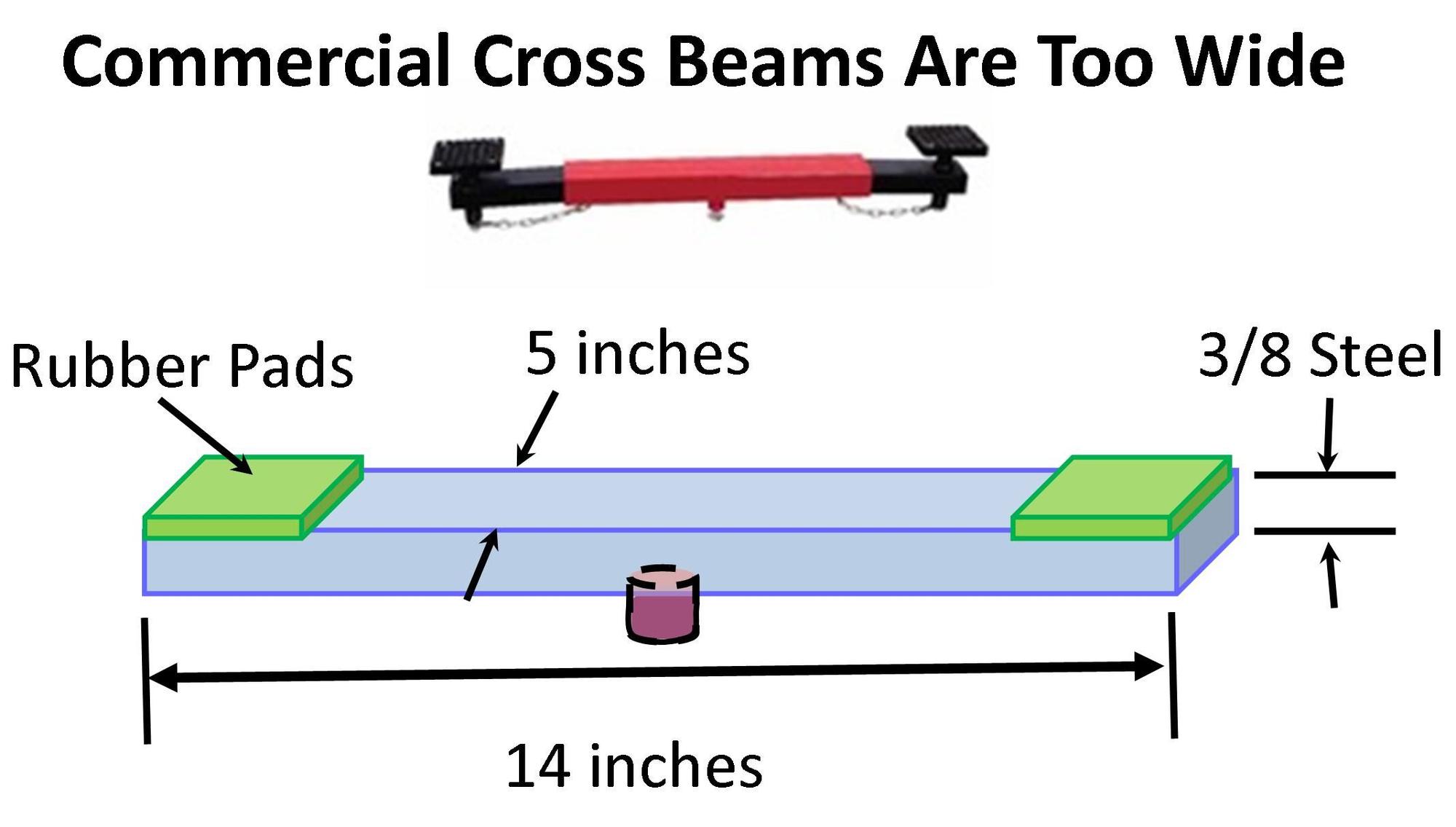

Originally Posted by Scoobydoobydoo
You guys jack up the rear to level it out when doing the oil ?
You should.
My C-6 would retain almost 1 quart if I didn't level it.
But, getting a jack and cross brace under the rear is not so easy.
Old Dec 28, 2015 | 08:55 AM
  #36
JerryU's Avatar
JerryU
E-Ray, 3LZ, ZER, LIFT
Joined: Sep 2007
Posts: 35,076
Likes: 12,434
From: NE South Carolina
Originally Posted by davekp78
You should.
Just added this idea to my PDF (post #9 in this thread) for a cross brace that if your low profile jack fits it should as well. When you remove the existing jack saddle this 3/8 inch thick cross brace should work! Did the deflection calculations and with rubber pads on the ends they will support the car from the ends. I'm looking for some 3/8 inch thick by 5 inch wide steel myself! Just tack weld a piece of pipe that fits your jack saddle hole.
Commercial Cross Beams or Braces are too wide. If fabricated from 3/8 inch thick steel it should be about the same height as the jack saddle that is removed.

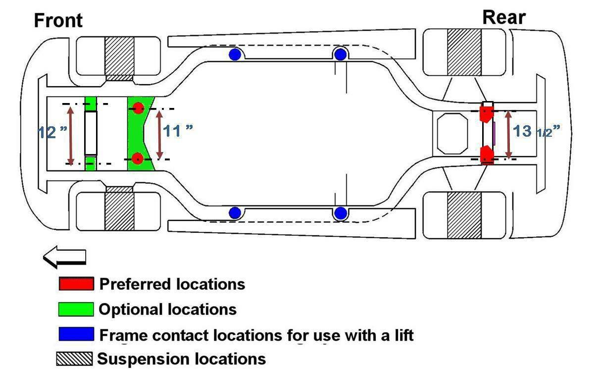

Originally Posted by JerryU
The figure in the 2016 manual is the same as the 2014/2015. One pic has an arrow that is incorrect or more accurately not showing specifically where to lift. There is only one cross brace on the front cradle that can be used to jack in the center, the rear most. The rear cradle should only be lifted at the outer edges as GM recommends. The C7 unlike prior Vettes uses hollow aluminum castings and it's a risk lifting at other that were GM says. I made a PDF of what I do to get my car up on all 4's and I don't use 4 jack stands. You'll see the warning label on one of my pairs of stands says jut that. Especially risky IMO if your getting underneath to remove a drain plug and oil filter.
http://netwelding.com/Jacking_A_C7.pdf
Below is one of the many pics in the PDF:
GM recommenced jacking points from 2014 Service Manual, which I colored for clarity
Does anyone know if I have to go to the selling dealer for the free il changes ? Or can I go to the dealer of my choice ?
