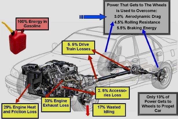

If it saves gas and doesn't dent performance a bit, why disable it? Because of ignorance and a belief in automotive conspiracies it'll wreck your engine right when the warranty is up?
A 6.2 liter V8 burns a lot of fuel idling.
I've rented cars with this feature, it's easy as chit to control, all you do is save money.
I am always impressed with what the GM engineers have been able to accomplish with the small block V8 compared to the one in my 1956, which I thought was great at the time.
The 1956 Vette weighed ~3000 lbs had a 265 cid engine with max hp of 240 gross (~200 net) and got about 15 mpg.
Compare that with the ~3500 pound C7 with a 376 cid engine, 460 hp that gets ~22 mpg average (and has much lower pollution and better crash capability.) All with the same bore spacing as the '56!
Consider on average only about 13% of the energy in gasoline gets to the rear wheels and 17% is wasted idling-why not!
I'm sure GM can make it as none intrusive as our X5 xDrive 35i BMW, SUV. Yes I can put it in sport and shut it off but I don't 95% of the time!
Here is a rough breakdown of how the energy in gasoline is used and wasted!
Typical Use of Energy in Gasoline. Only ~13% gets to the rear wheels; ~17% is wasted idling. Of the 13% sent to the rear wheels about a 1/3 goes to heat when braking! Regenerative braking is even being used in F1. Bet it will be in our Vette's and why not!

No problem in our BMW SUV, there is an electric water pump and that wasted heat in the cooling system fluid will keep you warm for a long time! (Also less parasitic waste.) In the summer, for a normal stop light the fan blows over the cold evaporator and provides cool air. If it can't keep it cool enough it just starts the engine.
Regenerative braking uses some of that wasted energy and helps keep the more highly utilized battery charged!
