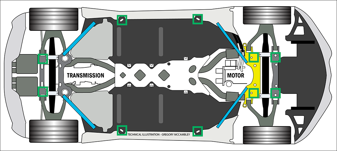

A forum member made this more specific diagram for the c7:

Big difference in the C7 from the C6!! The C7 has "hollow aluminum casting front and rear cradles (to save weight over the C6)" and GM warns only to lift where they say! I made the pic with the colors from the 2014 Service Manual. You can lift where you wish but risk cracking the hollow castings.
I repeated the picture below. Those dimensions are for the Cross Brace I fabricated. You are only supposed to lift from the center of the rear most front cross member-not my words, GM's!
First, no need to jack up very far for a splitter install. Since you have only one jack (I use 2) and you're concerned about jacking the other side after putting in one jack stand on an appropriate GM spot, then do it in two steps! Jack up from one side 1/2 way putting a jack pad in a shipping slots (blue circles,) install the jack stand then do the other side lifting fully, install that jack stand. Then go back to the first side and lift it so both jack stands are even. Depends how safe you want to be, I favor max safety!
GM Suggested Lifting Locations from 2104 Service Manual, I Colored for Clarity.
Yep, he had contacted me. Pic is better just needs Symbols and Colors defined, which I believe he did!

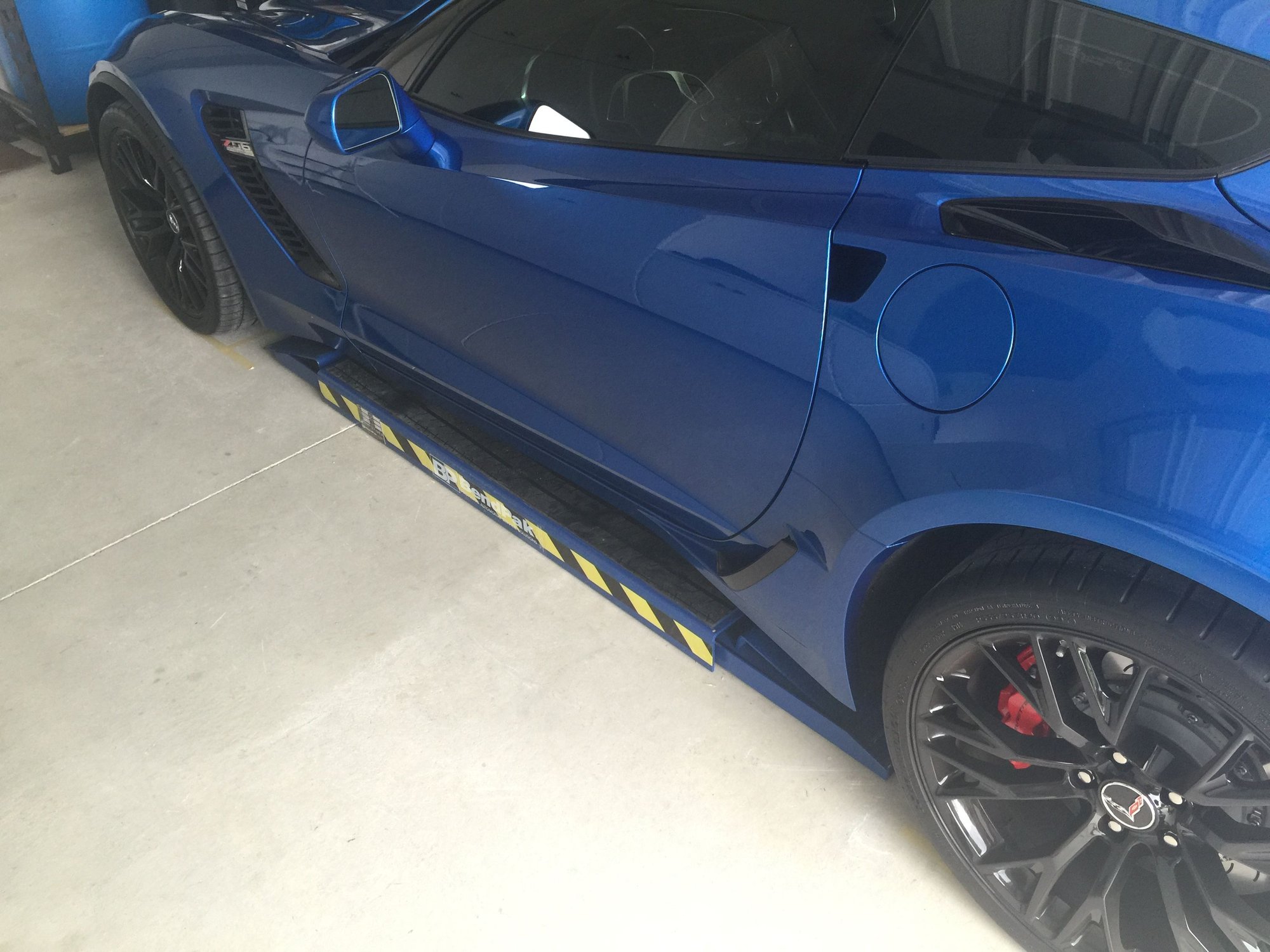

Not sure how much you want to spend or what your space requirements are but here is another option. I just park over it so its not really in the way and when I need to lift the car, put on the pucks and hit the button.
What lift is that?

LR-60P
http://www.bendpak.com/car-lifts/spe...ts/lr-60p.aspx
