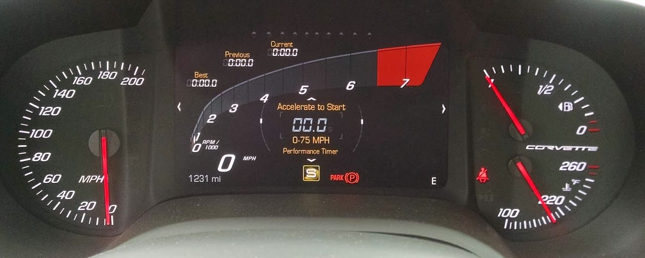

Please have your dealer refer to GM Bulletin # 15814 that came out this month.
This will instruct the dealers of the fix in the IPC (Instrument Panel Cluster) of reprogramming the computer.
You're welcome

Some 16 C7s were missing the 0-60 performance timer in the Driver Info Center. This is just a software update that adds it back.

My brand new C7 has the "Performance Timer", but not the "Lap Timer".
Apparently the reprogramming adds the Perf Timer, but still does not bring back the Lap Timer!!

I requested my dealer do the update as I got my oil change (and Android Auto). I haven't tried to test it out but it does show on the screen now. It is a bit different than the '15 because my '15 I couldn't do a 30-130, it set the higher one at a 125 limit, this one goes to at least 135

With an oil change, the Android update and the timer software my total time at the dealer was 4.5 hours
Well..... It lets you go all the way up to 250, however, if you select anything over 125 it defaults back to 125. How disappointing... I was hoping to get 30-130 runs timed.

I had the Performance Timer update done today along with the Android Auto upgrade. It took 90 mins to do and the tech showed me how to set it up.

I had mine done today at Henna Chevrolet in Austin. No issues... Just had to reset some of my dash settings and re-pair my phone on Bluetooth.
