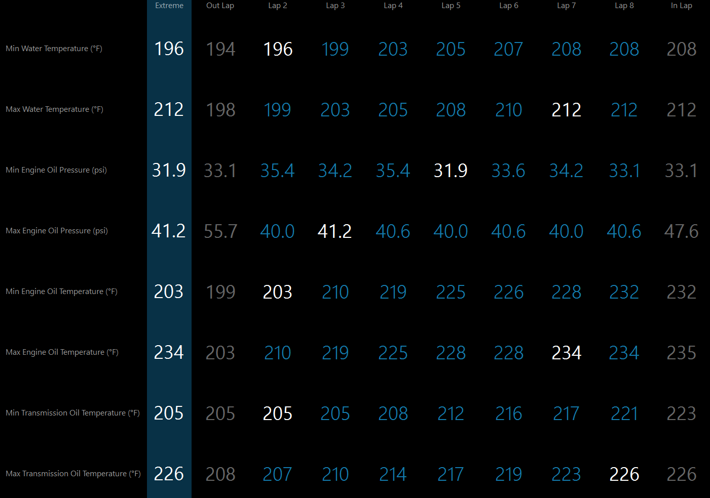

This chart I recorded at spring mountain a few weeks ago, outside temperature was about 75 degrees. 2015 Z51 A8. Gives you an idea of the temperatures after 9 laps.
Thanks for posting; this gives me a good comparison to my '15 Z51 A8 last weekend at TWS.....a much faster 2.9 mile track with 80 degrees (full sun) ambient temp. I'm also running a Z06 front grille (no front plate.) and rear air scoops; I was trying to see if the addition air flow would help on cooling. The temps are after 15 minutes of running at 7/10s with my student in the right seat;
I can probably contribute the slightly higher trans temp to running at higher rev's....I was purposely trying see how high I could get the engine oil and trans temps. Note how low the water temp stayed, I feel very good about that one.

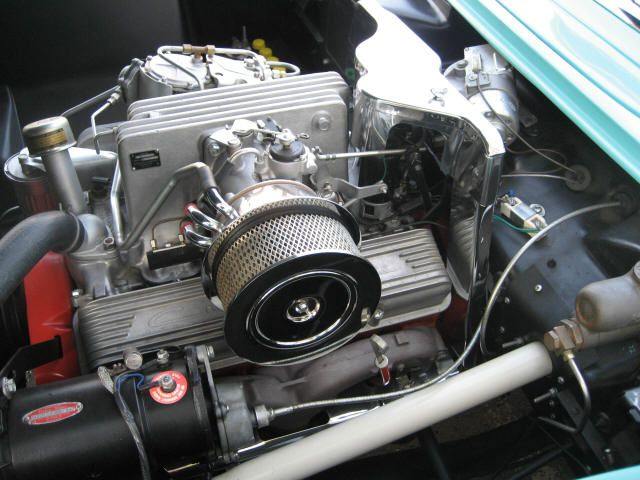

Originally Posted by HAD2HAV2
Nice red Vette. Z51 has no center plastic dam. Be glad you have no problems.
What's under the covers?
1957 Fuel Injected/NCRS Top flight car.
1954 Pennant Blue with original Blue Flame six.
1962 with 383 crate motor and 700R4 4 speed auto overdrive trans. This is the one I take on the freeway, including today.
