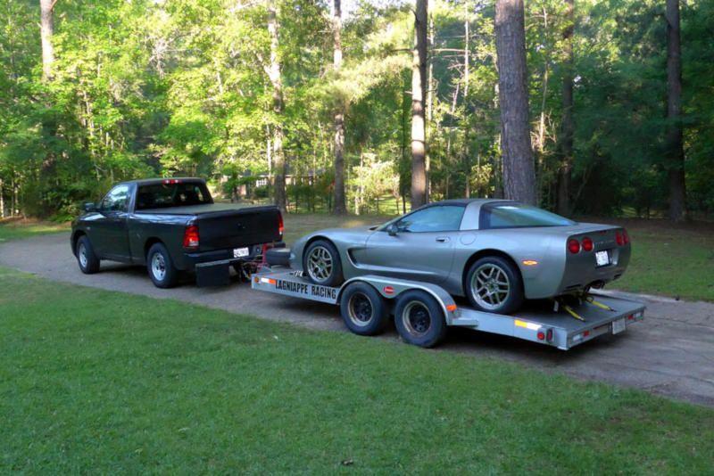

There's a slew of options. Here's my 16' all aluminum from a Bowling Green builder (no less) with my C5 on it, but works just as well for my C7 St'ray.
