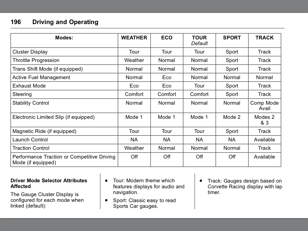

This may help.
Old May 19, 2016 | 03:34 PM
Maxie2U's Avatar
Maxie2U
Joined: Aug 2015
Posts: 8,243
Likes: 4,618
From: Southwest Florida
This too.
This too.

Since my experience is with Magnetic Shocks, it may or may not apply. But there's something that I don't think you'll find in the book.
I, too was frustrated by the delay in throttle response exiting turns. It persisted even when I thought I had all nannies off. By that, I mean, Traction Control turned off with the two pushes of the button (per the manual), then, in PTM mode, dial it all the way to Race mode, which also eliminates active handling. Still, there was a lag.
Then a friend showed me that all nannies can truly be turned off if I hold down the center button, once, for about 7 seconds and then release. Try at your own risk. It will definitely show how much help you've been getting.
I started out doing this on autocross only, where the only thing I could hit were some cones. (And I sure did take out my share.) I still don't do it all the time on the track. Hopefully soon my skills will improve to that level, but not yet.
