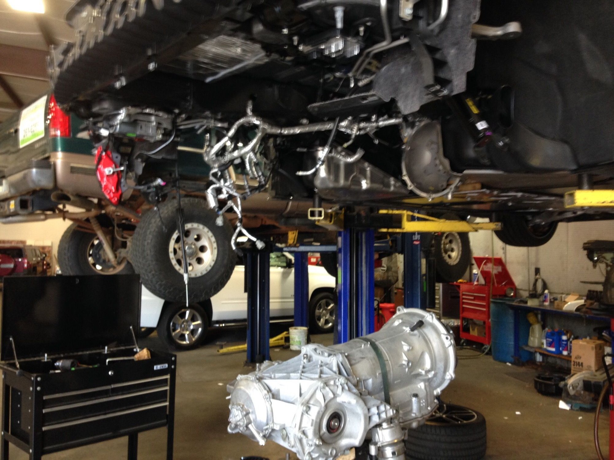

Here is what your Vette will look like just to get to the TC. It's a HUGE job, but a necessary evil if you experience symptoms described in previous threads. My symptoms were mostly shuddering.
Many thanks to Charlie at Lou Sobh Chevrolet in Milton, FL for taking on this project. The car runs like butter now. Well done!

Thanks for the pics. I replaced a clutch in a C5 in my garage so I know what a job it is.
I had the torque converter in my C7 replaced and I am still having shuddering and slipping with the cruise set. Good luck!

Man that doesnt look like a diy project at all! Do you happen to have the part # for the new torque converter?

I have lost all my faith in GM after this crap. Mine still isn't working right after BOTH the stator and T/C fix. This is a pic of mine a few weeks ago in the same position.

One word comes to mind..... DAYUMMM. I hope my A8 continues to operate correctly.
