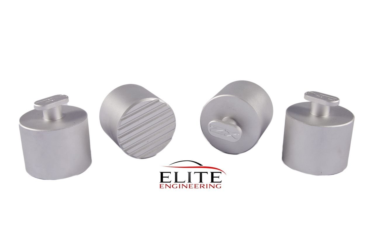

I use the Elite Engineering tall pucks to clear the side skirts. Keep them in the rear storage.
http://www.eliteengineeringusa.com/c...pads-set-of-4/

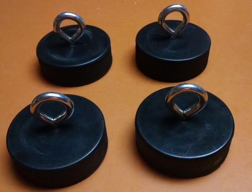

Originally Posted by B-Myster
I use hockey pucks with an eye bolt that I made for my previous vettes. I remove them after each use. They work fine with the side skirts on my car.
..Me TOO
