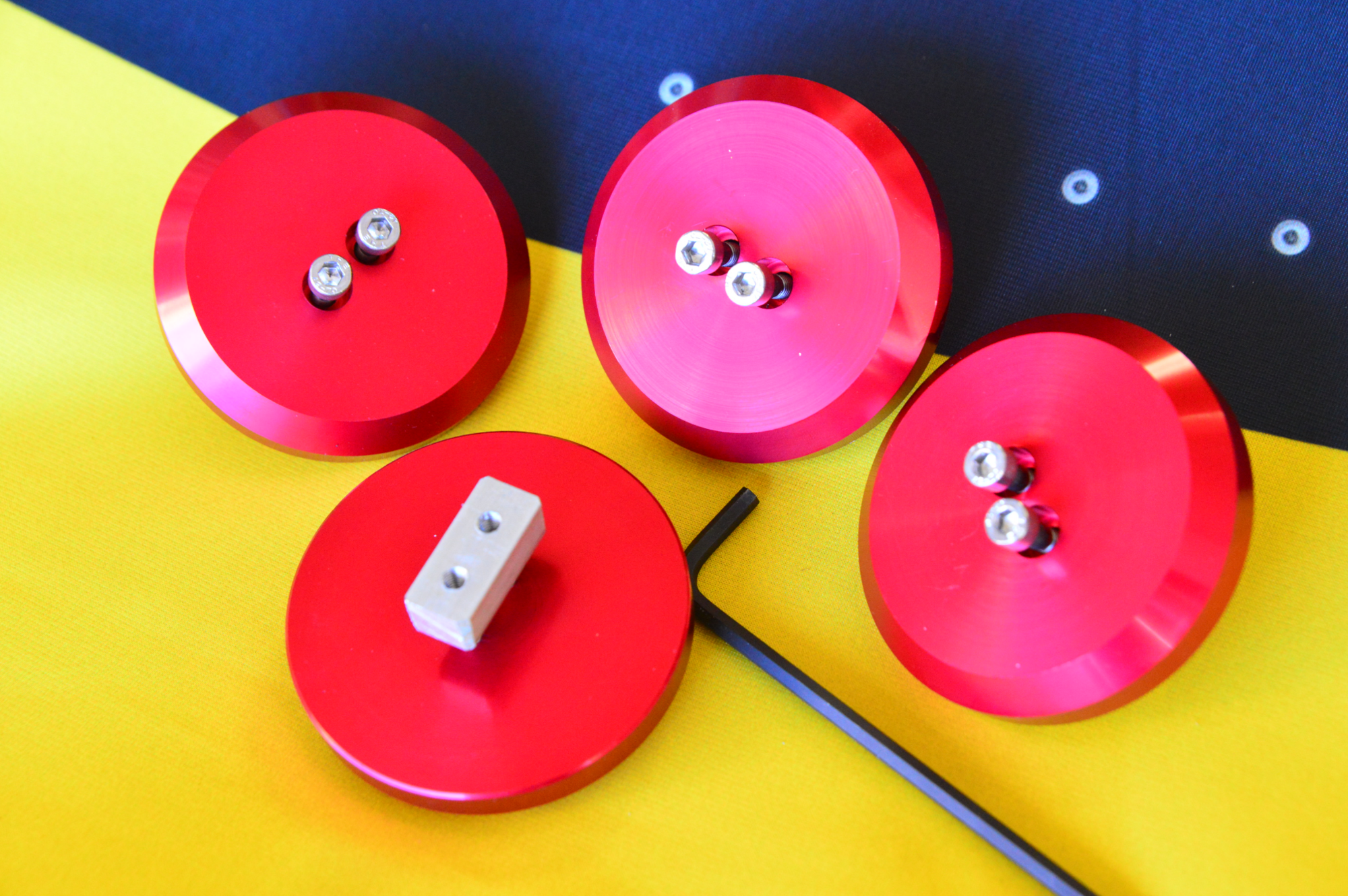

I wanted leave-in pucks but the plastic ones can break sometimes. To be clear, there are only a few cases of this happening with the RPI and SCP ones, but they occasionally happen and you can find a couple on the forum. Most people use them with no issues.
I ended up going with the ones from ZL1Addons (they are leave-in as well). They are aluminum and made to be left-in. You can get them both in red (anodized) and in a plain aluminum finish. PM if you want a discount code. I believe they are a forum vendor.

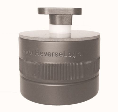

I have 2 1/2 inch high aluminum pucks from KaTech and need that height to clear my side skirts with the jacks I use.
However I would buy the best of both worlds from ReverseLogic.
They are 2 1/2 inches high and have a unique construction that lets you install them temporally by locking them into the slots. I'd get 4 so if your car dealer or when you get tires or have a flat fixed and they have a center post lift they will not crack your side skirts or rocket panels! Can't leave them in but fine for driving to a dealer.

ReverseLogic pucks can be screwed in temporarily when going to a dealer.

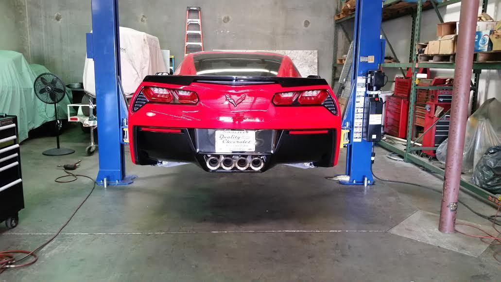

Plastic snap in pucks from forum vendor. No problems. I have a 10,000 pound Bendpack lift with the low profile arms and round poly pads and the smaller diameter pucks sit perfect on them.

I put the zl1addons aluminum pucks in seven months ago and forget they're even there.

Rooster, can you explain how the Zl-1 pucks attach?
