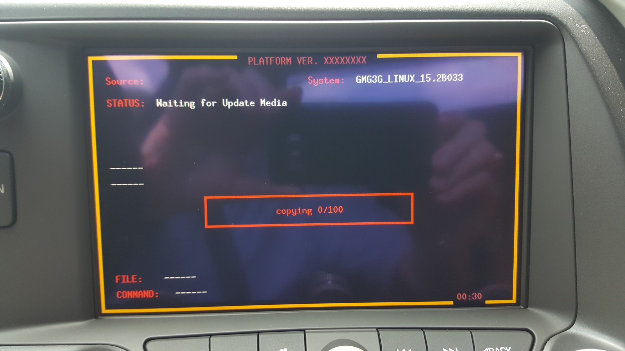

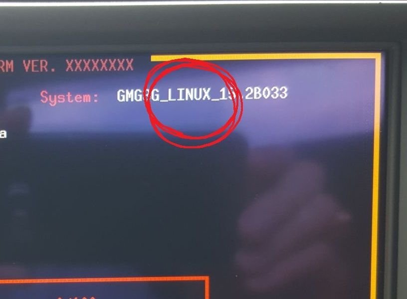

I've been reading a few threads that I found in Search, but I haven't read anything about my problem. The infotainment screen went BLACK last night. This morning, the screen was still BLACK, but then, while driving to the Dealer this popped up. I snapped a photo. Just as quickly
it went BLACK again. Then it popped up again, then BLACK again where it remains. Any idea what this means and how to get the infotainment screen working again?

An update from the Dealer on my infotainment screen. My car is only eight (8) weeks old and has 2,250 miles on it.
After two full days of work and consultation with Chevy, they have diagnosed my problem as a bad "HMIM". They are calling it a "Human Machine Interface Module". I asked him to repeat it twice. They tell me mine is BAD, but Chevrolet does not have one to replace it with. They tell me HMIMs are VIN specific, so they can not remove one from one of the six unsold Vettes that are sitting in their lot. They "put the car back together" and told me to come in to pick it up. They have no idea when Chevrolet will be sending the replacement unit. So, I have no radio, navigation, back up camera, front camera, PDR, hands-free phone, blue tooth connection, etc.
I've googled HMIM, but nothing turns up. I think they are handing me a line of BS. Either that or they don't know much about Vettes.
If ANYONE from Chevrolet Customer Care is monitoring this sight, some insight into this problem would be helpful.
Oh, and one more thing. They asked if I had a battery tender for the car. I asked why they were asking. They said that the unit was powering up all by itself looking for an update. (That is the photo which is in my original post). They said that this powering up mode will likely drain the battery if the car is sitting too long, so they recommend using the battery tender until the repairs are made.
I asked if there are none of these units available, how can the production lines in Bowling Green be running? Why can't they pull one of these off the assembly line in Bowling Green, and send it to the dealer? He didn't know whether to shift or wind his watch with that one.
My frustration is growing by the minute.
