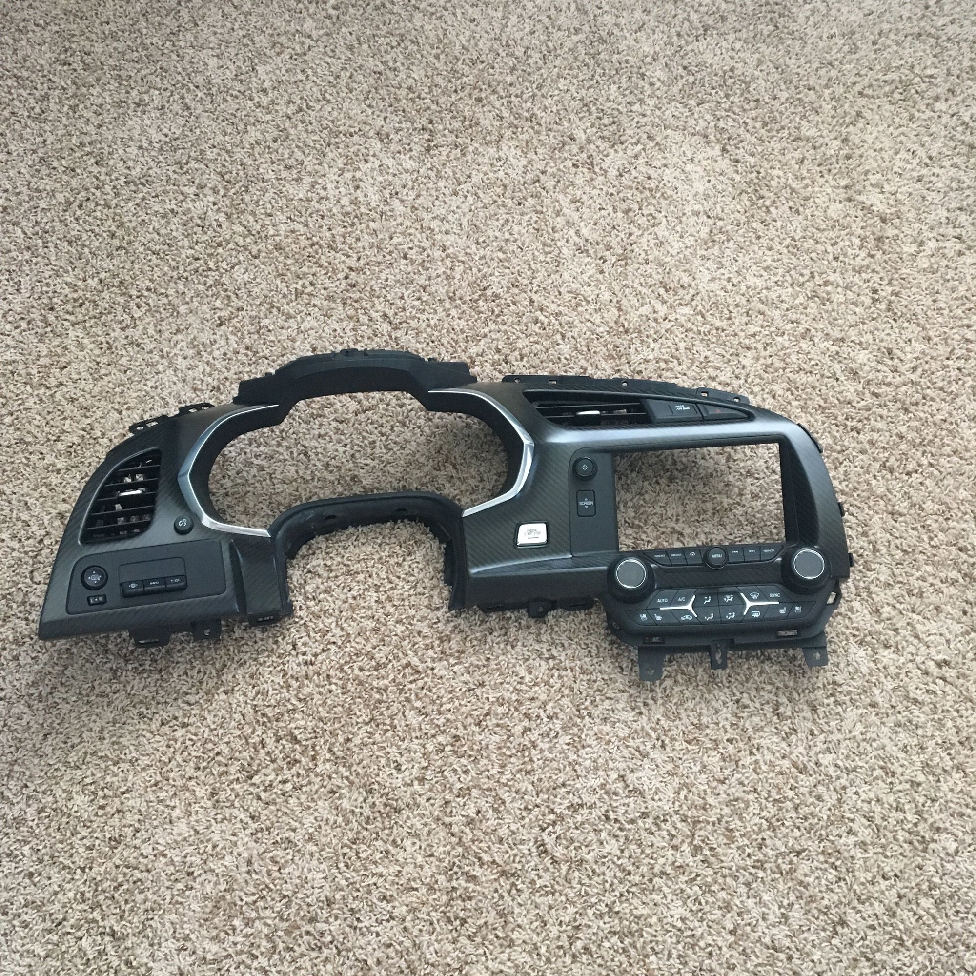

Gentleman, It took 2 hours this time. I decided to go about it a little bit different this time as I know where all the attachment points for the dash are.
Basically you remove everything you have to to "PREP" the existing dash for removal and it will cut most of the time in half. I will say the hardest part of all is reaching behind and unhooking all the wire harnesses to all the controls. Other than that, its a piece of cake. DO NOT WORRY ABOUT ANYTHING RATTLING. NOTHING WILL!! THIS DASH IS HELD IN WITH 11 BOLTS AND A BUNCH OF CLIPS:

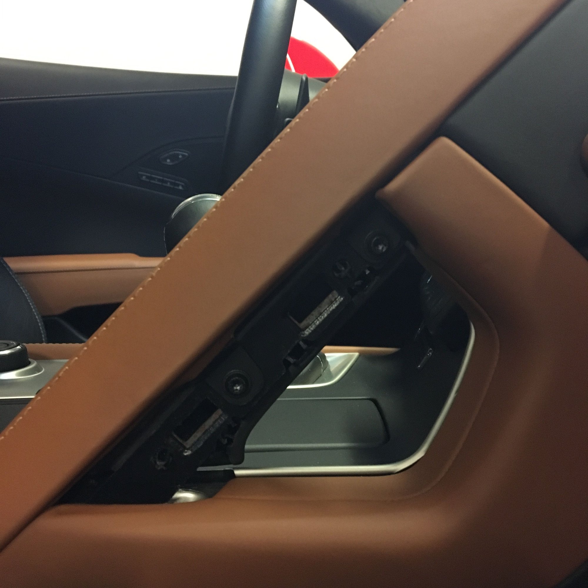

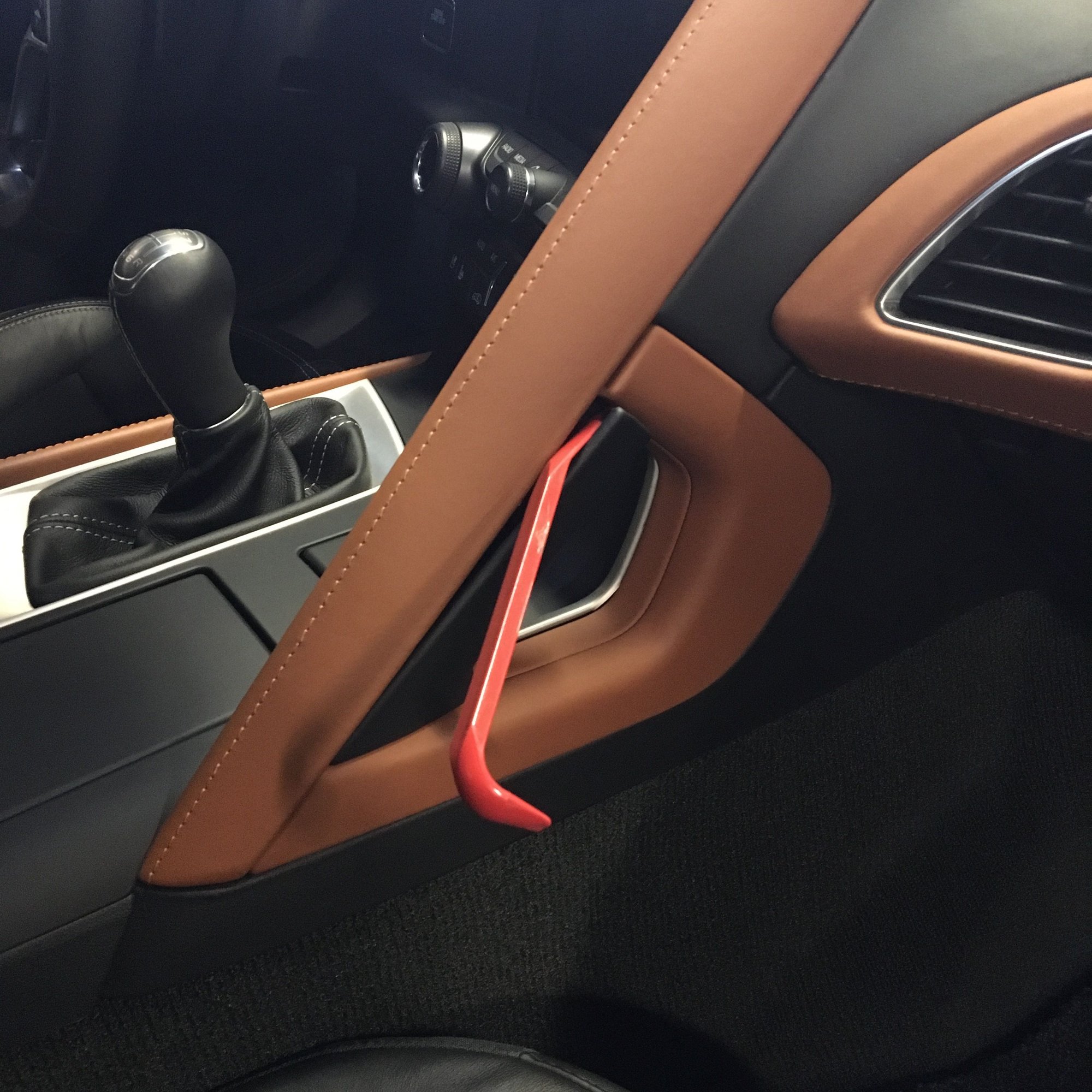

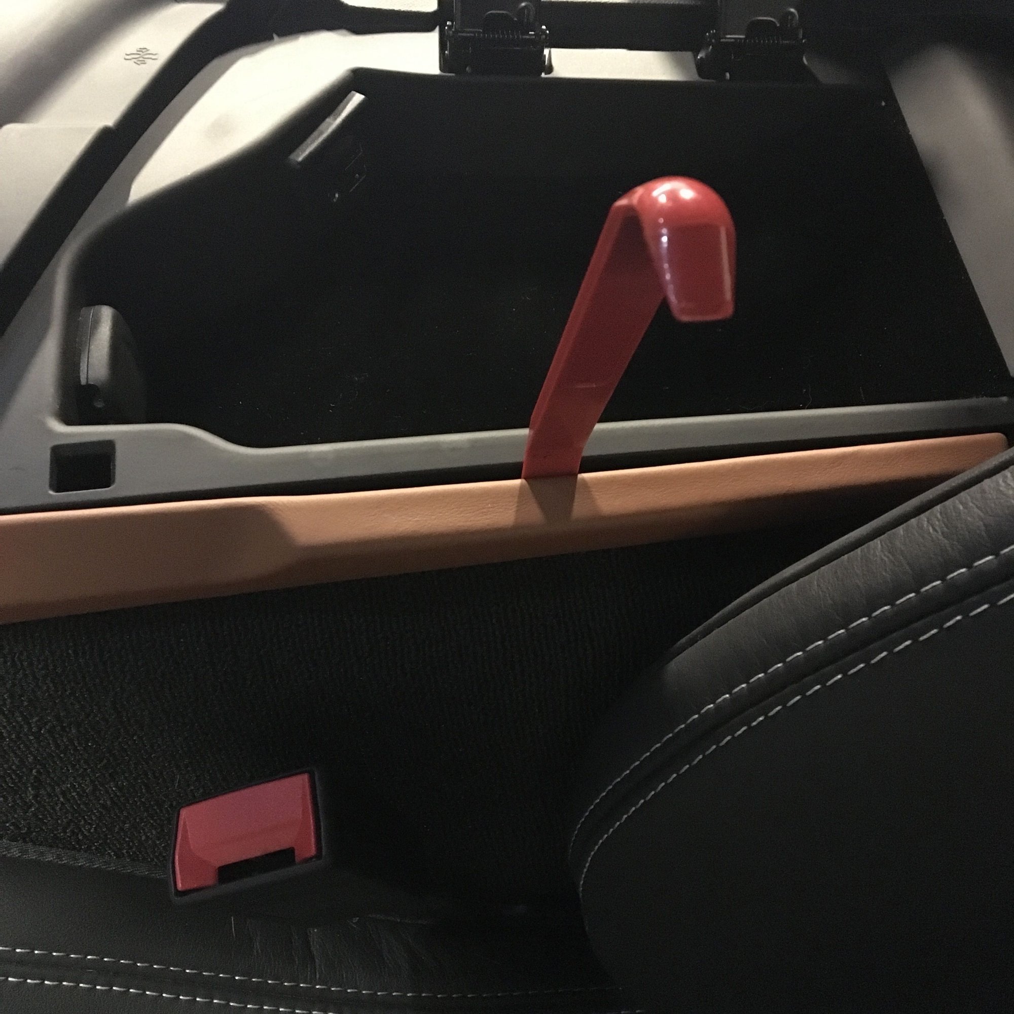

STEP 1: REMOVE PASSENGER GRAB HANDLE WITH PRY TOOL. This is where you will need the TORX 25 screwdriver:

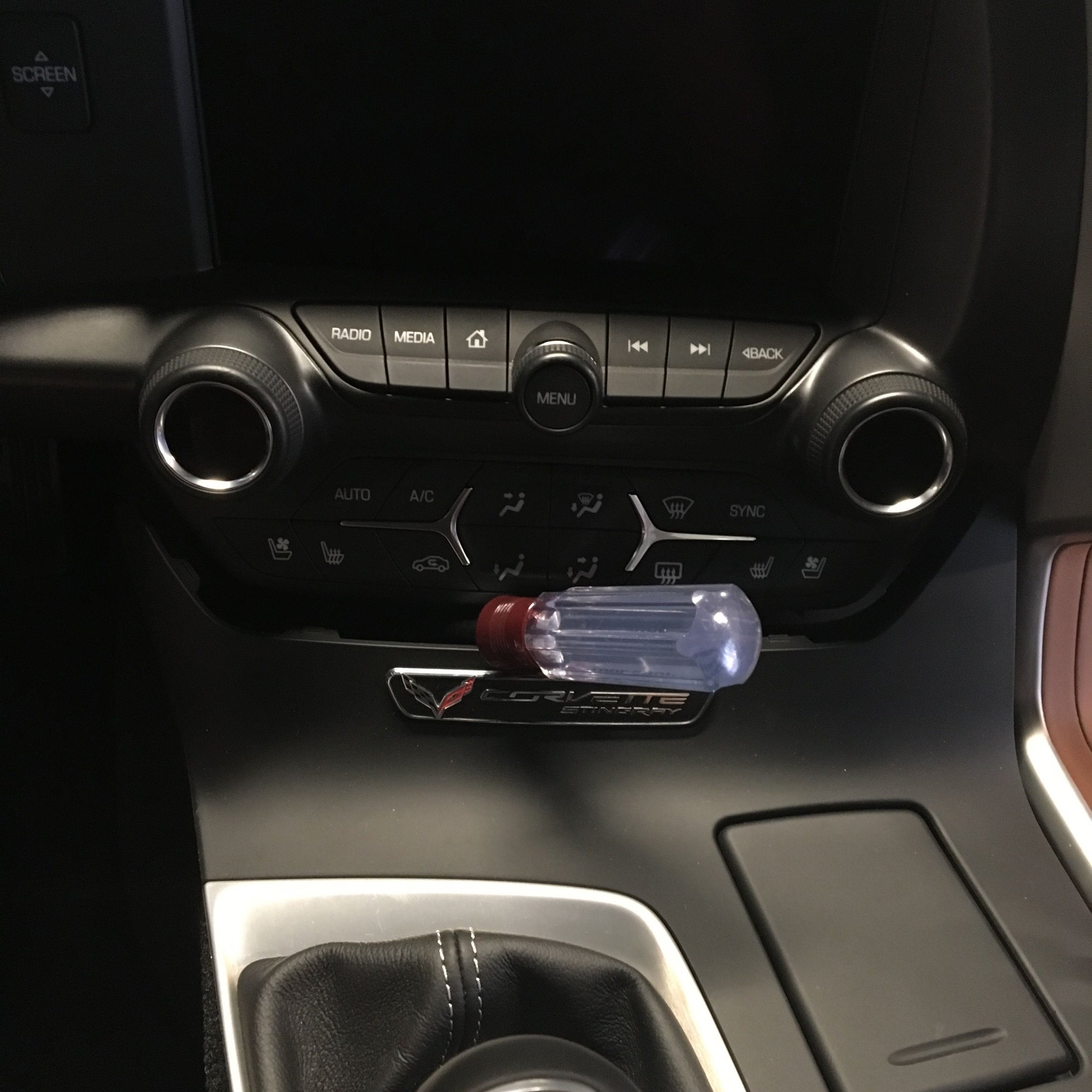

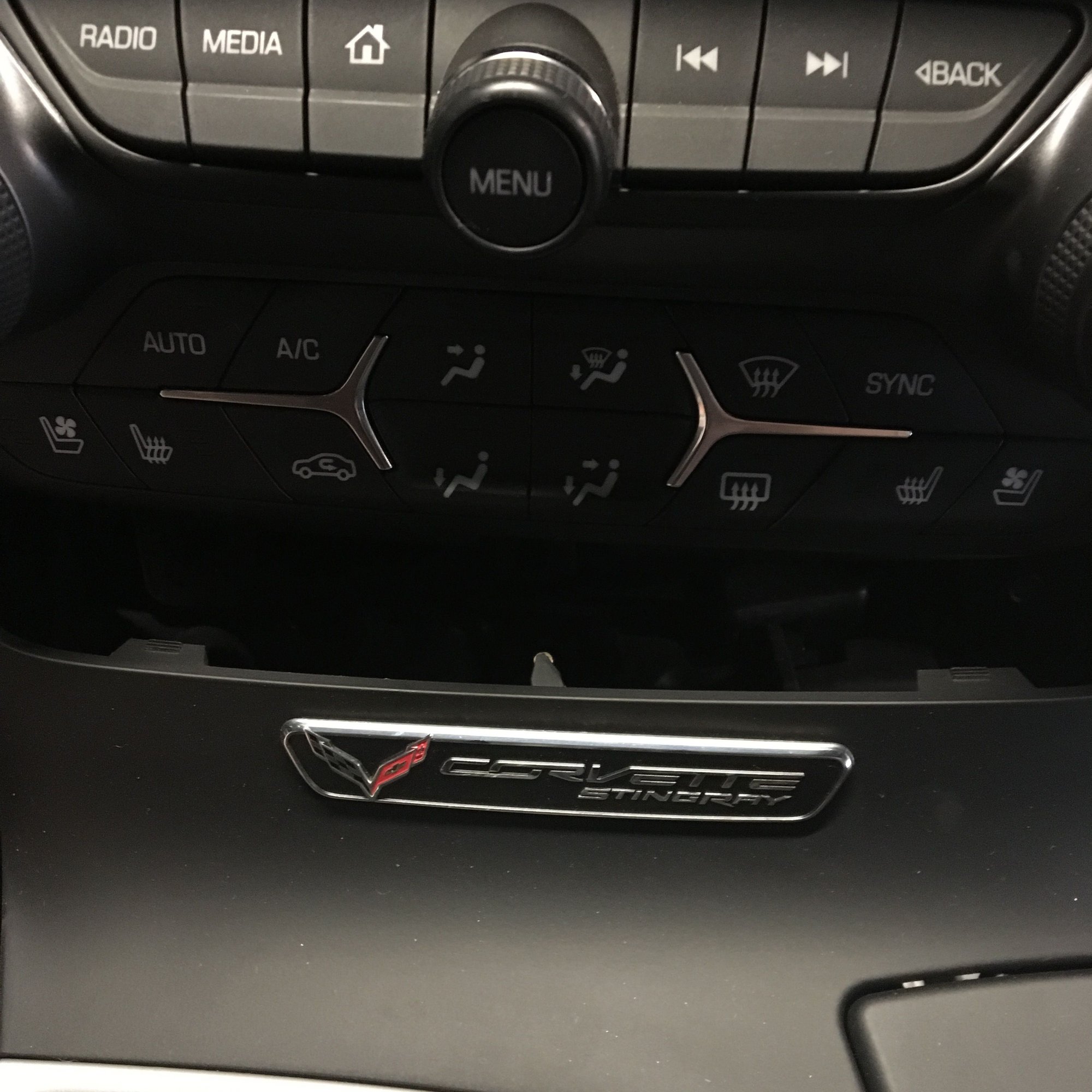

Step 2: REMOVE CENTER CONSOLE DOOR. This is where you will need the TORX 10 screwdriver:

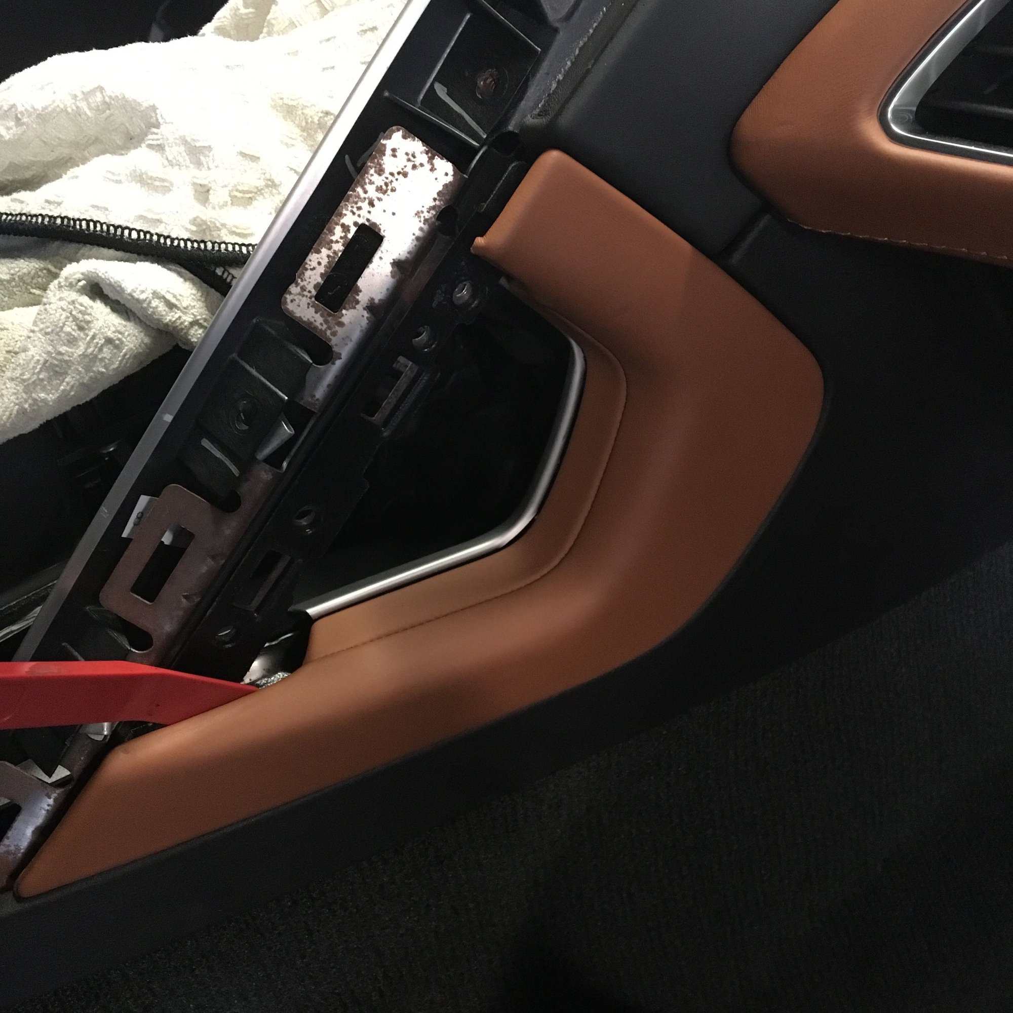

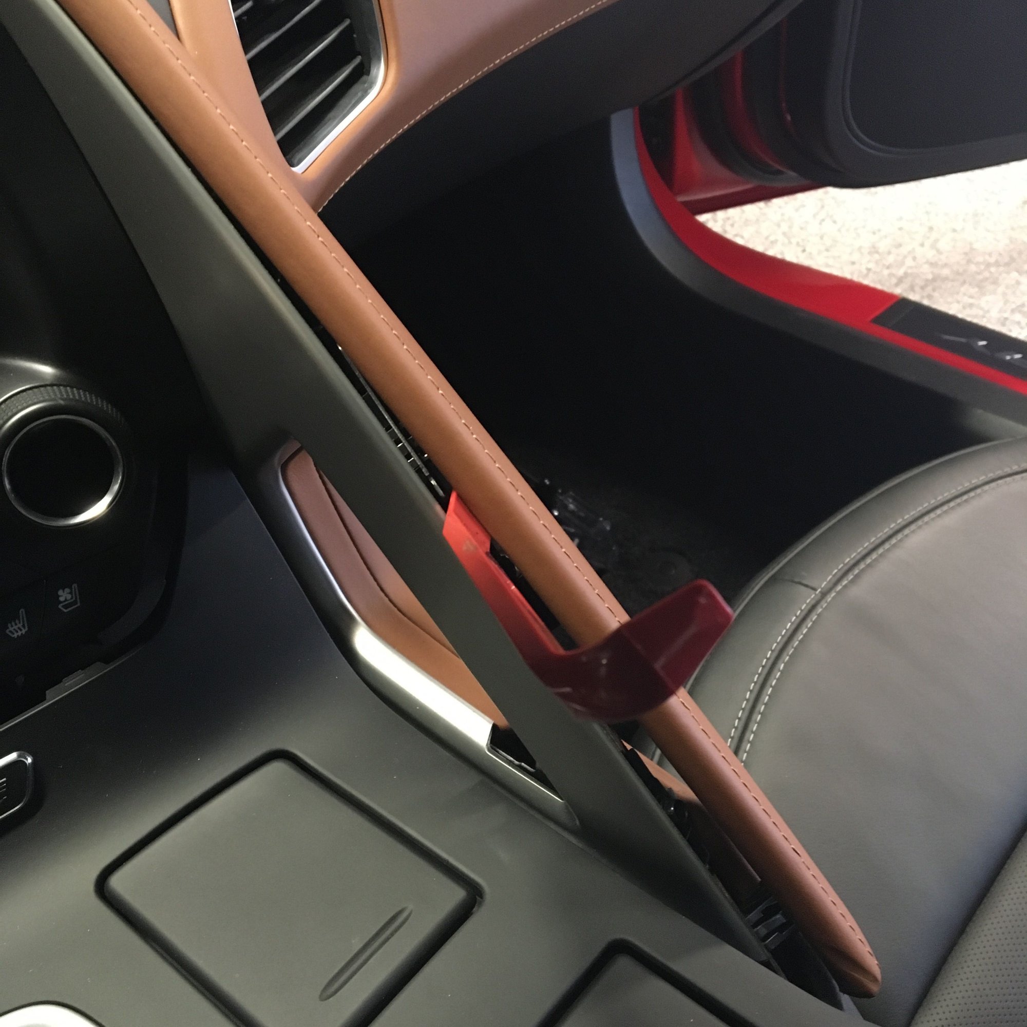

Next remove the side trim piece:

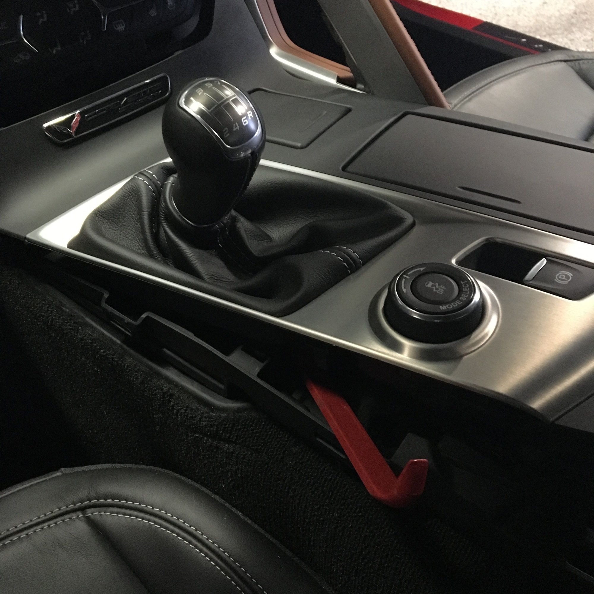

Next pry up the center console and slide it back (I had to put the car in 4th gear to do this):

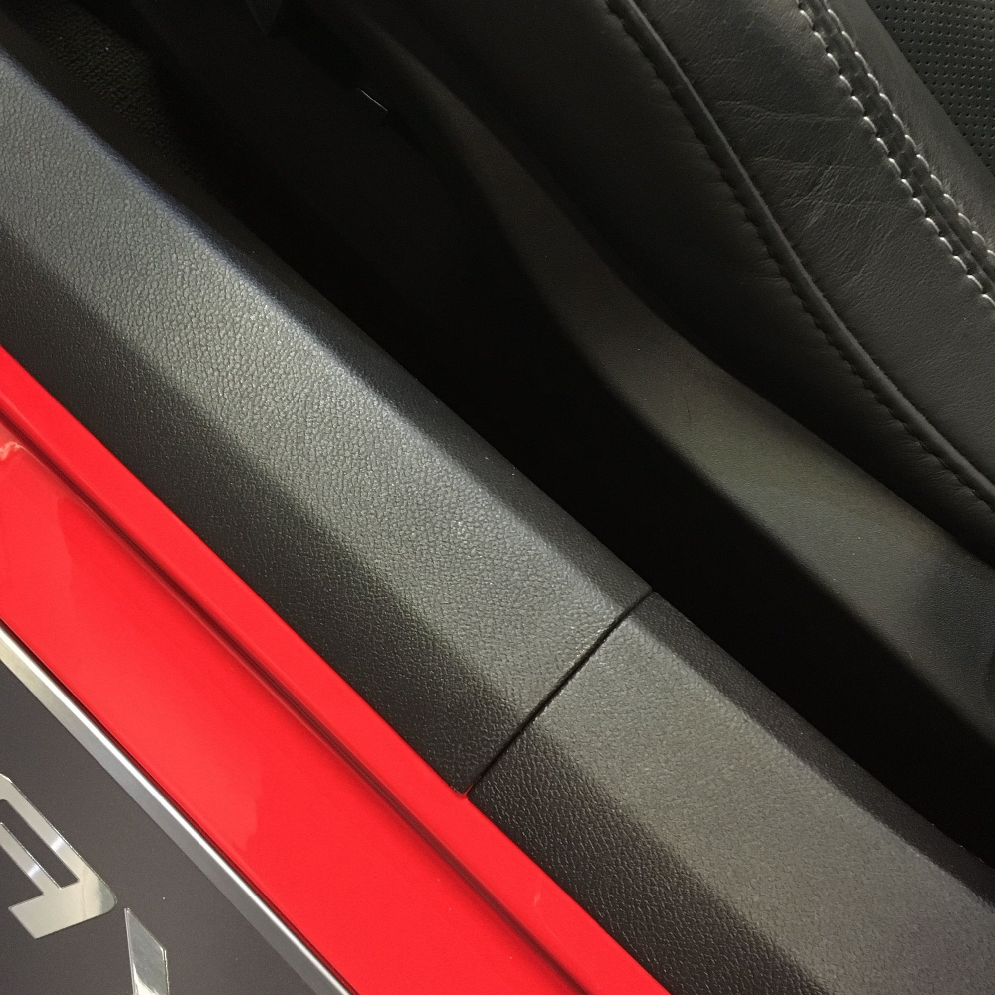

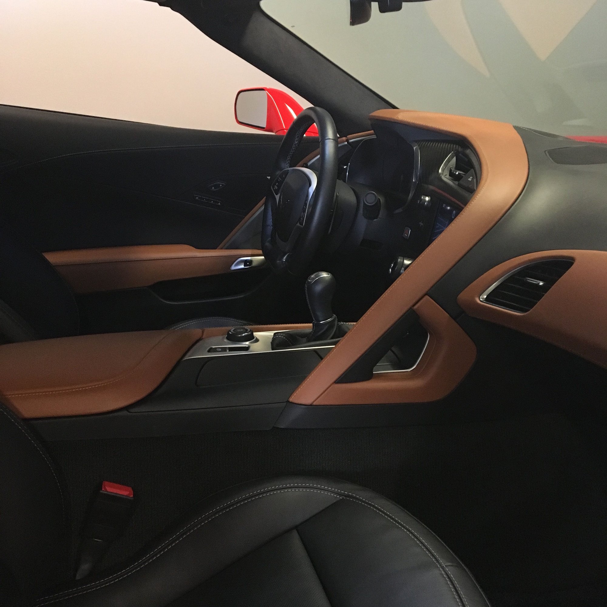

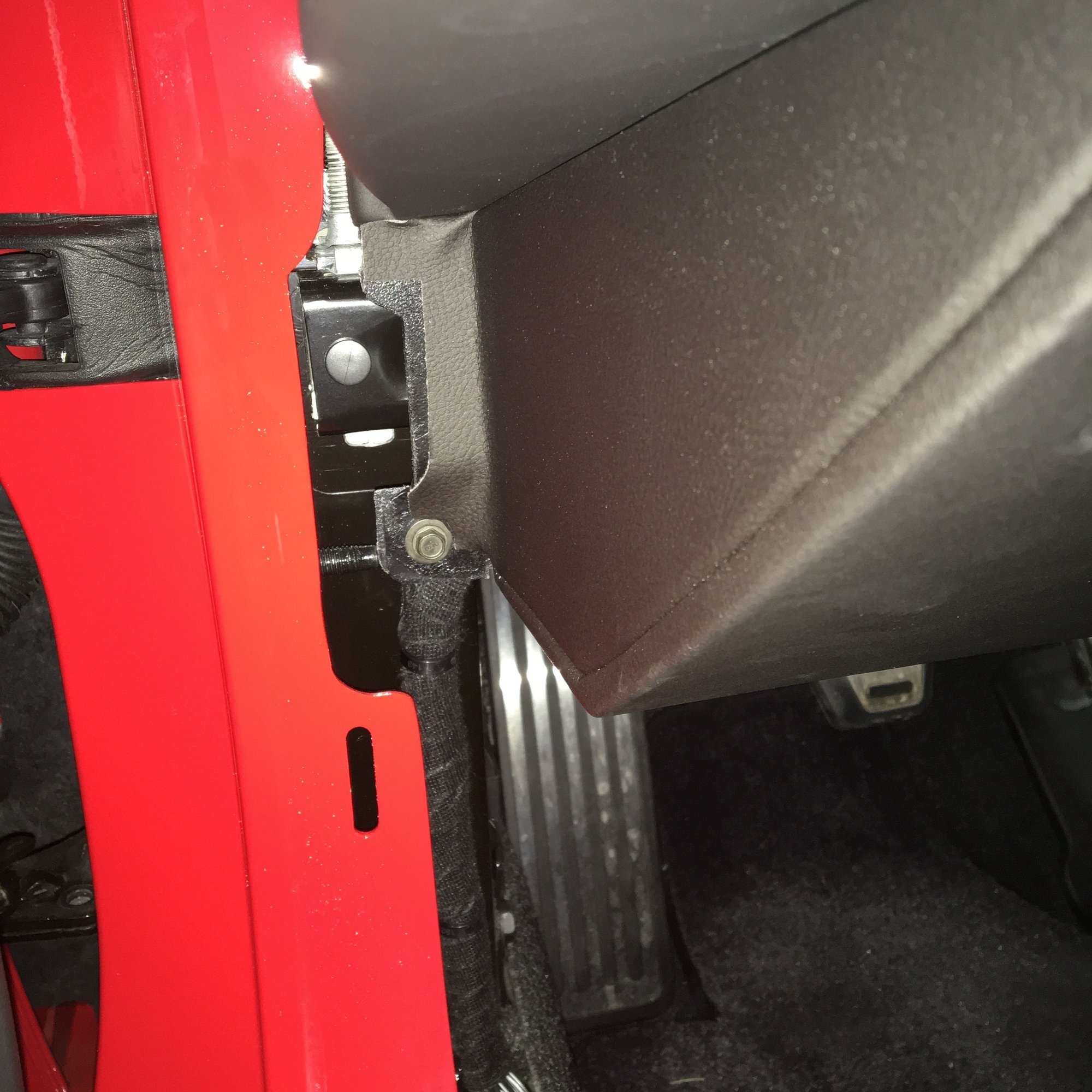

Now you will need to remove the driver side sill pieces, to expose one of the lower dash bolts:

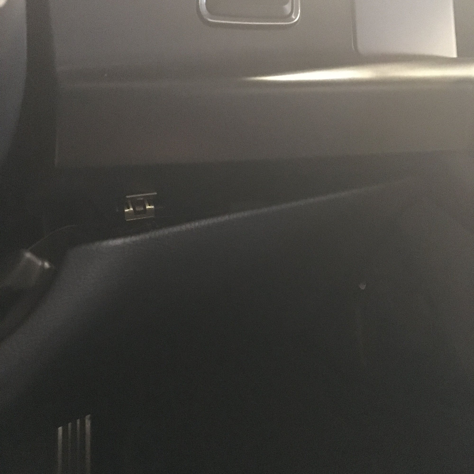

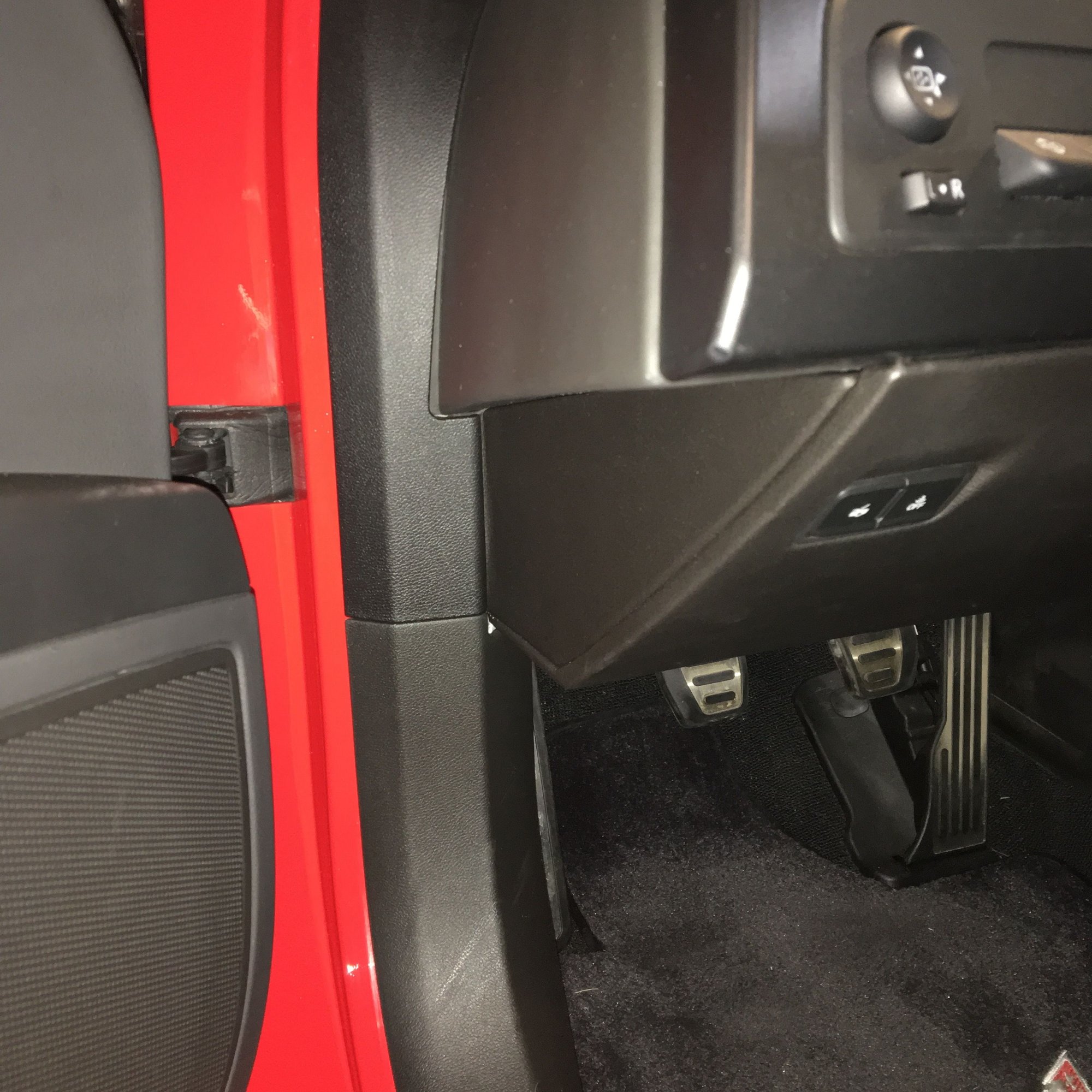

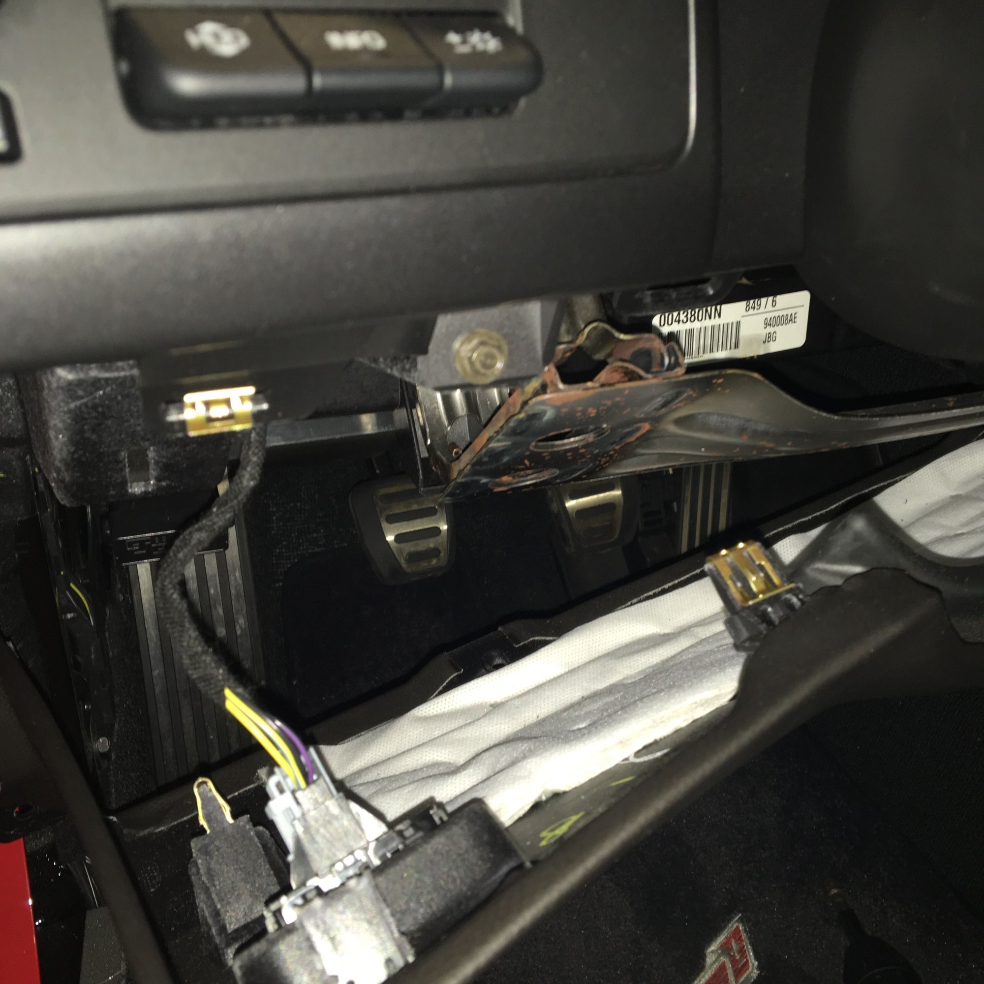

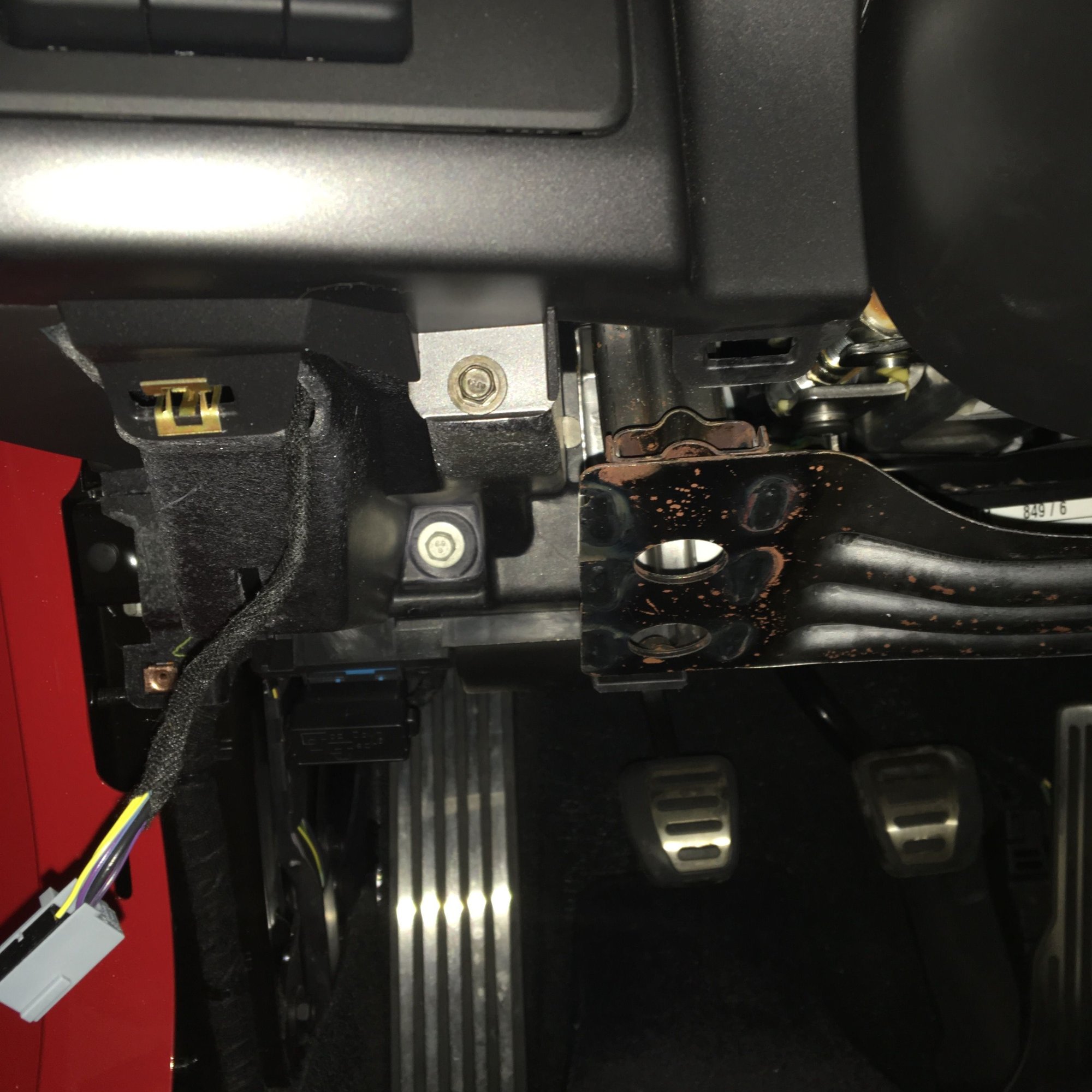

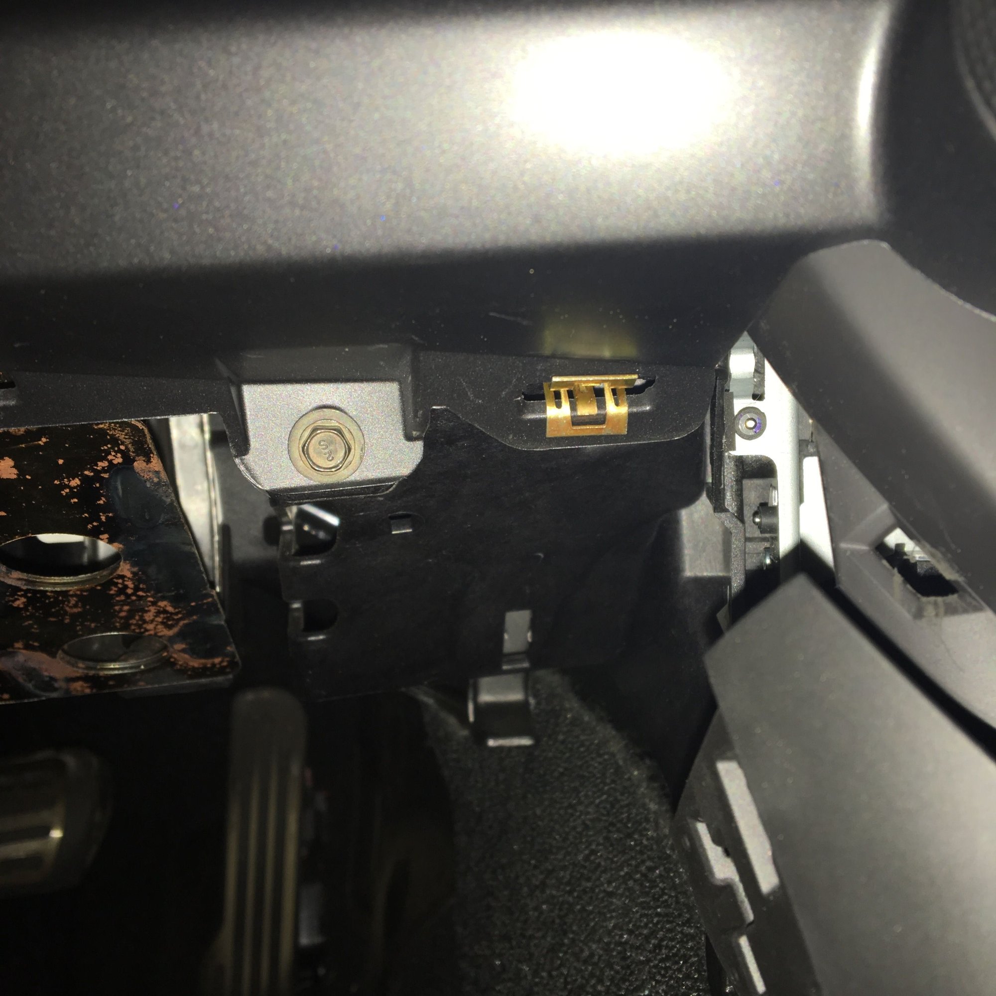

Next remove the lower driver side panel, this is held in with clips and 2 7mm bolts underneath. You will then see 2 more dash holding 7mm bolts:

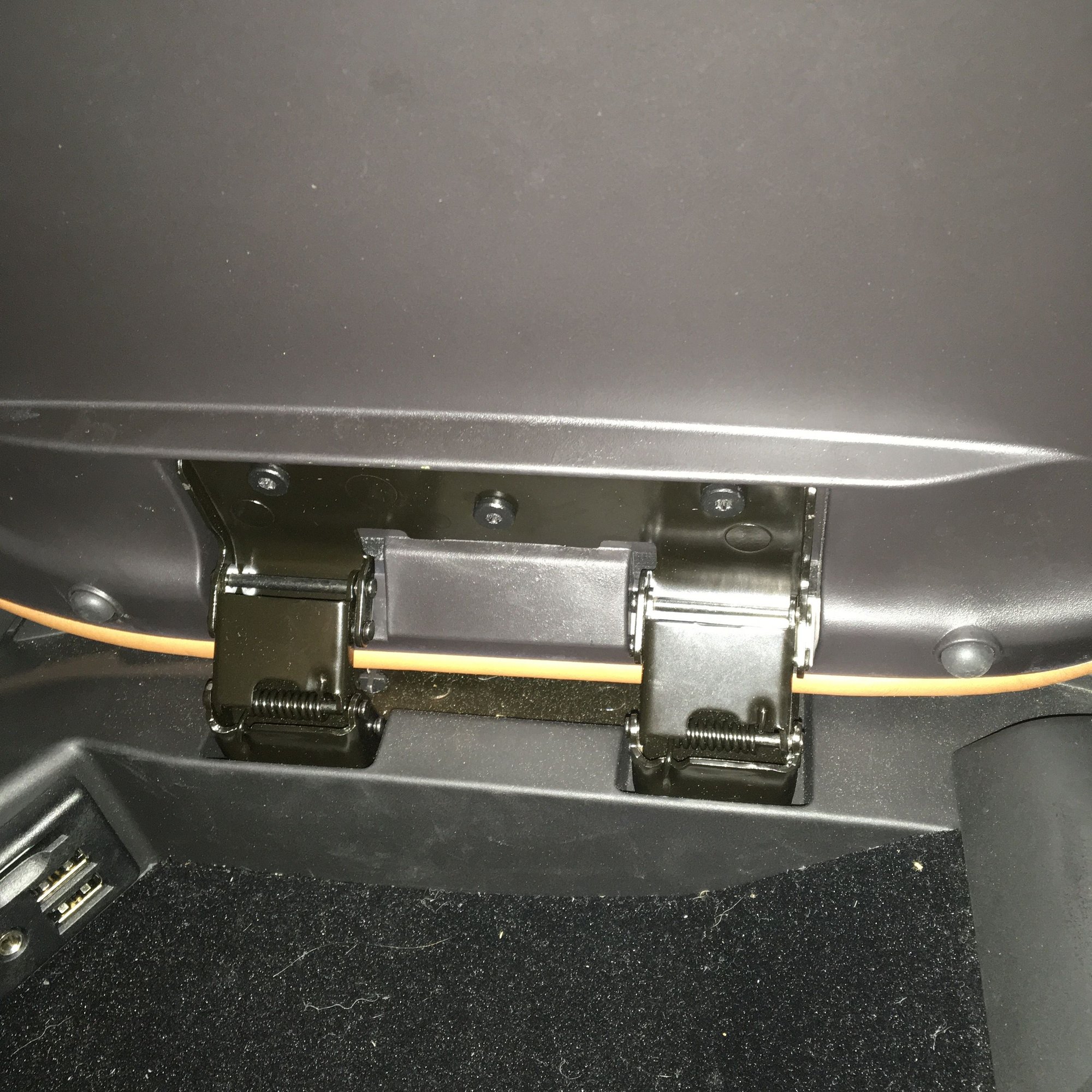

You can now begin to remove the 3 lower bolts that are holding the dash in. DO NOT START PULLING THE DASH YET THOUGH!! There are two more under the front of the center console which you can reach even though its tight:

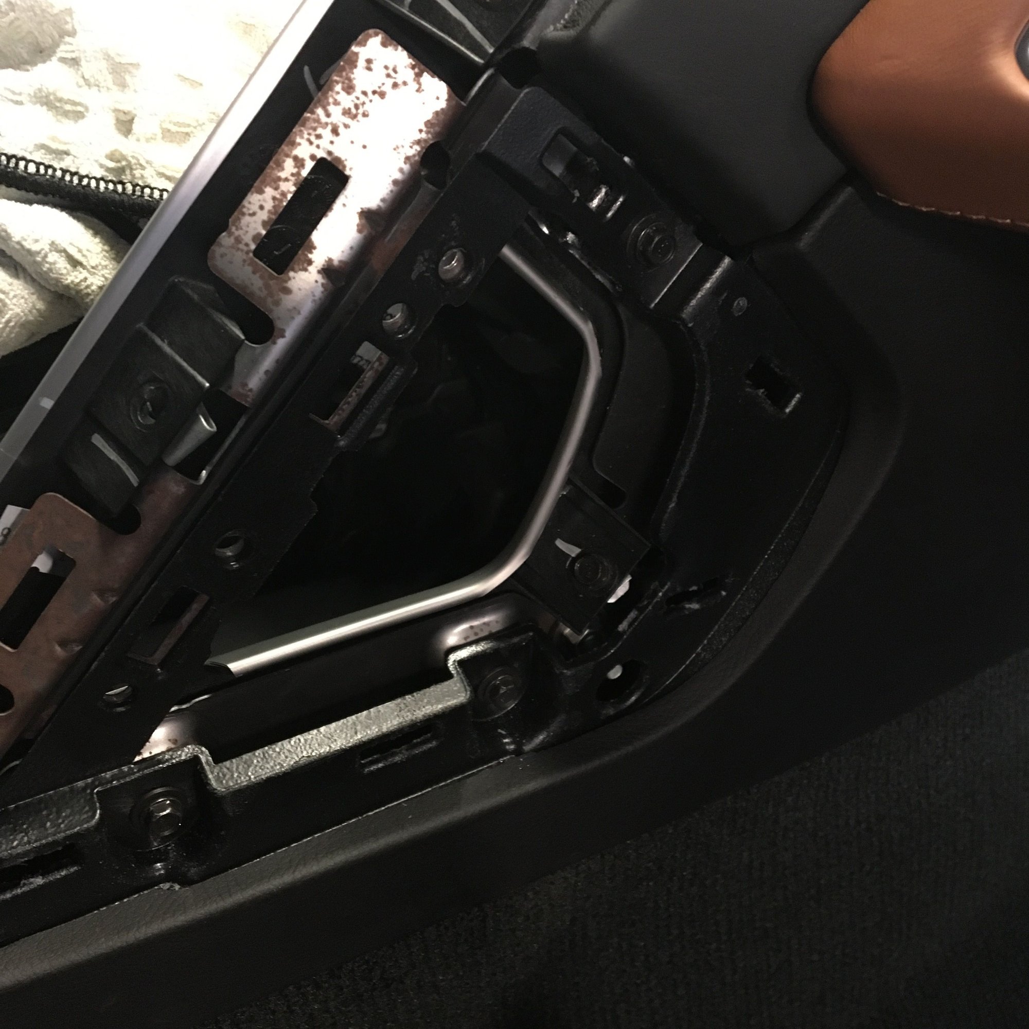

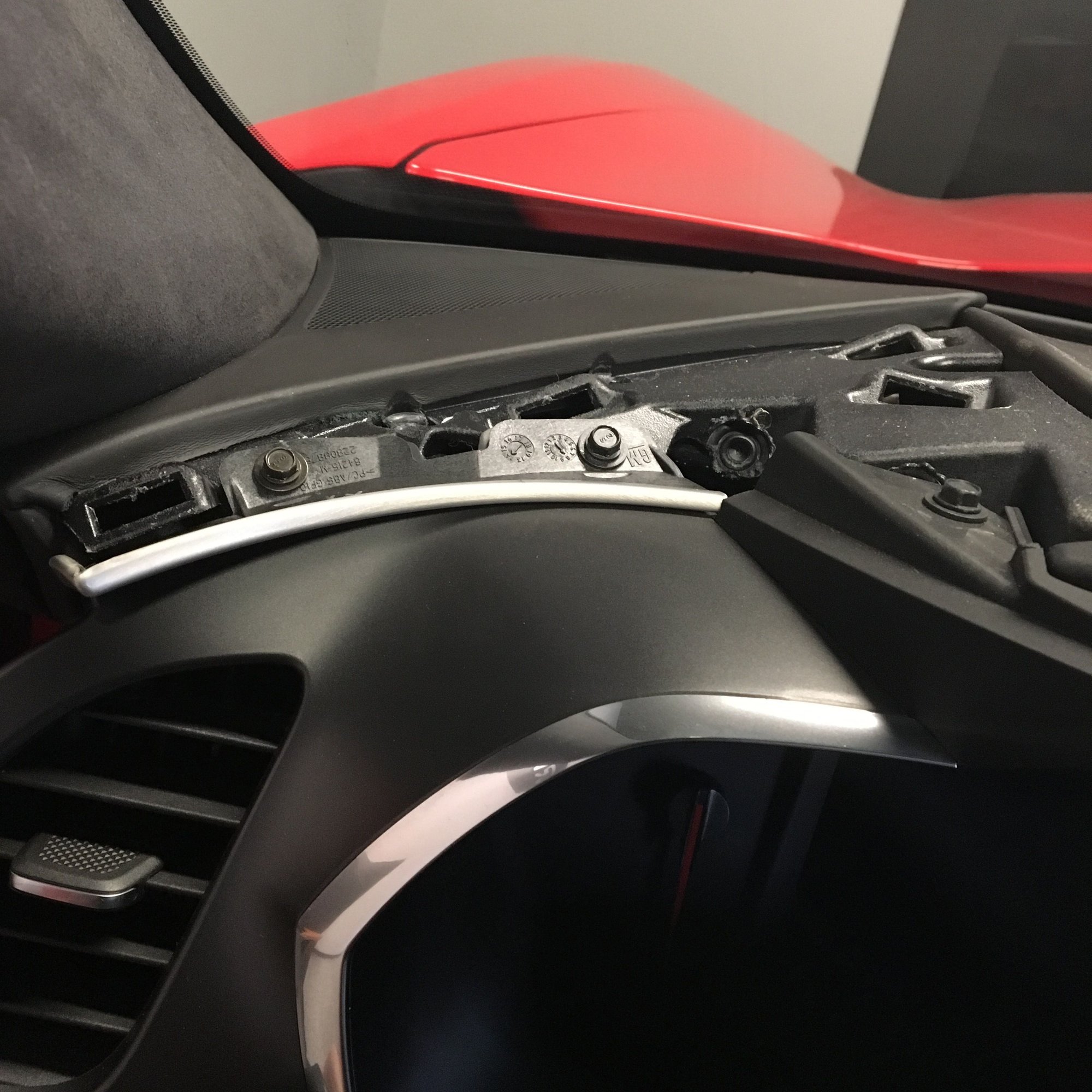

Next you can remove the bolts from the aluminum trim pieces to be able to slide this piece out. You will need to remove the 3 side 7mm bolts on the passenger side as well to get it to move freely (which is why you removed the passenger grab handle pieces to begin with):

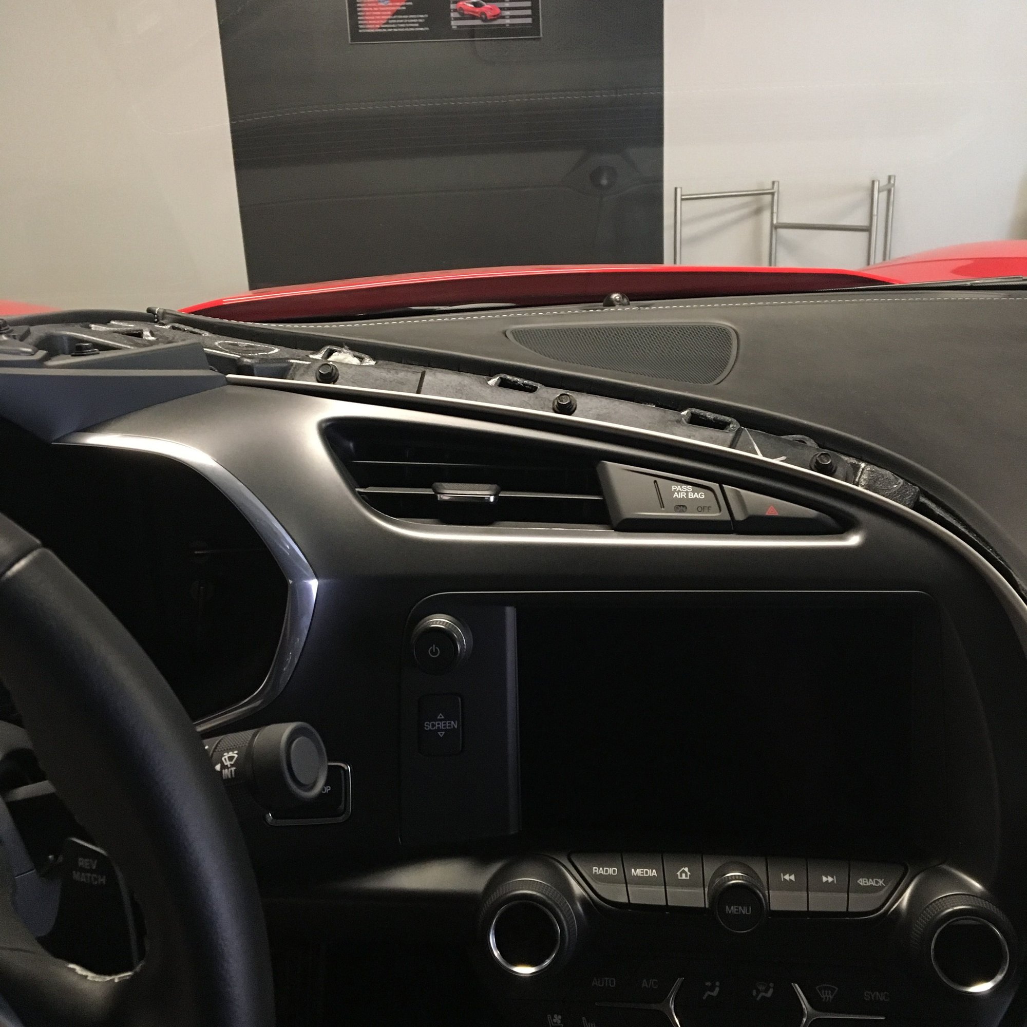

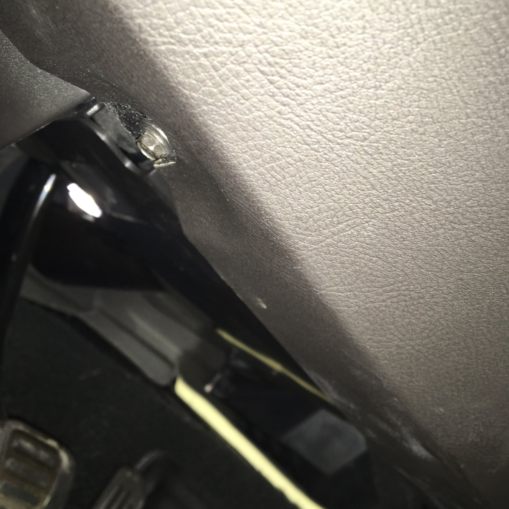

Now the only 2 bolts holding the dash in (aside from it's clips) are the 2 on top of the dash closest to the windshield. Remove those. You can then pull the dash out carefully and unhook all the wire harnesses:

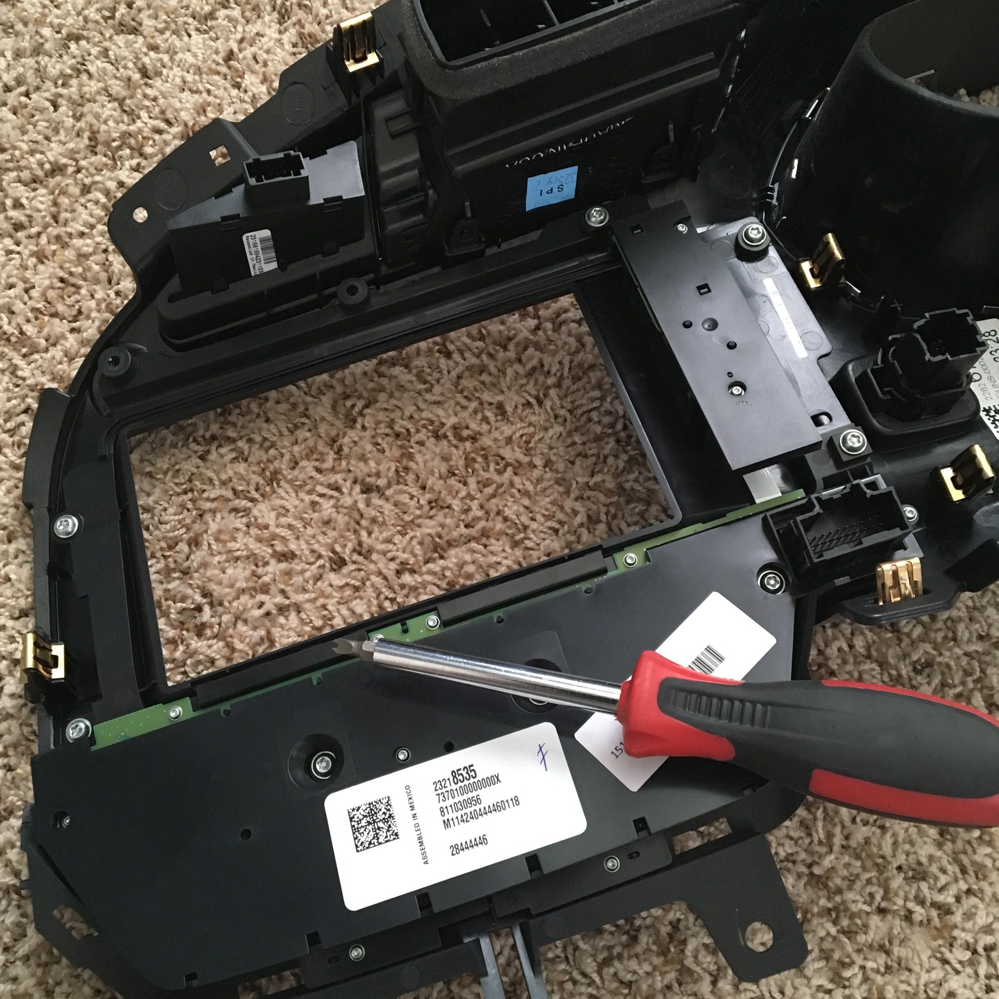

Now that you have the dash out, transfer over all the components to the new one. This is where you will need the security bit set:

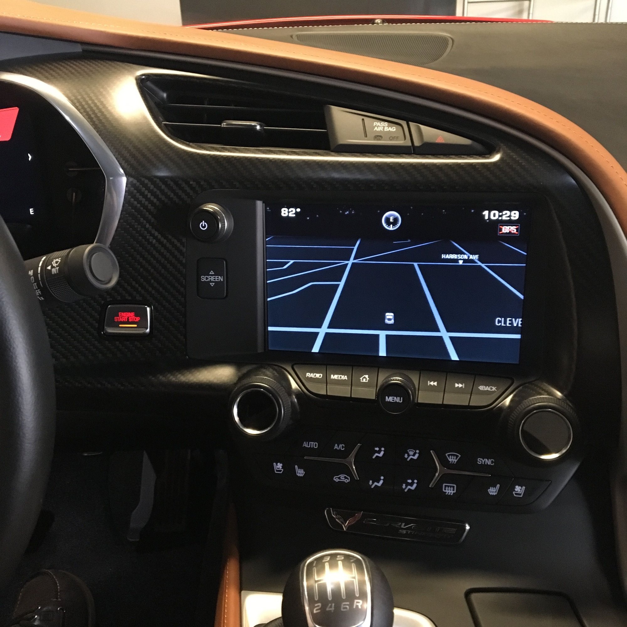

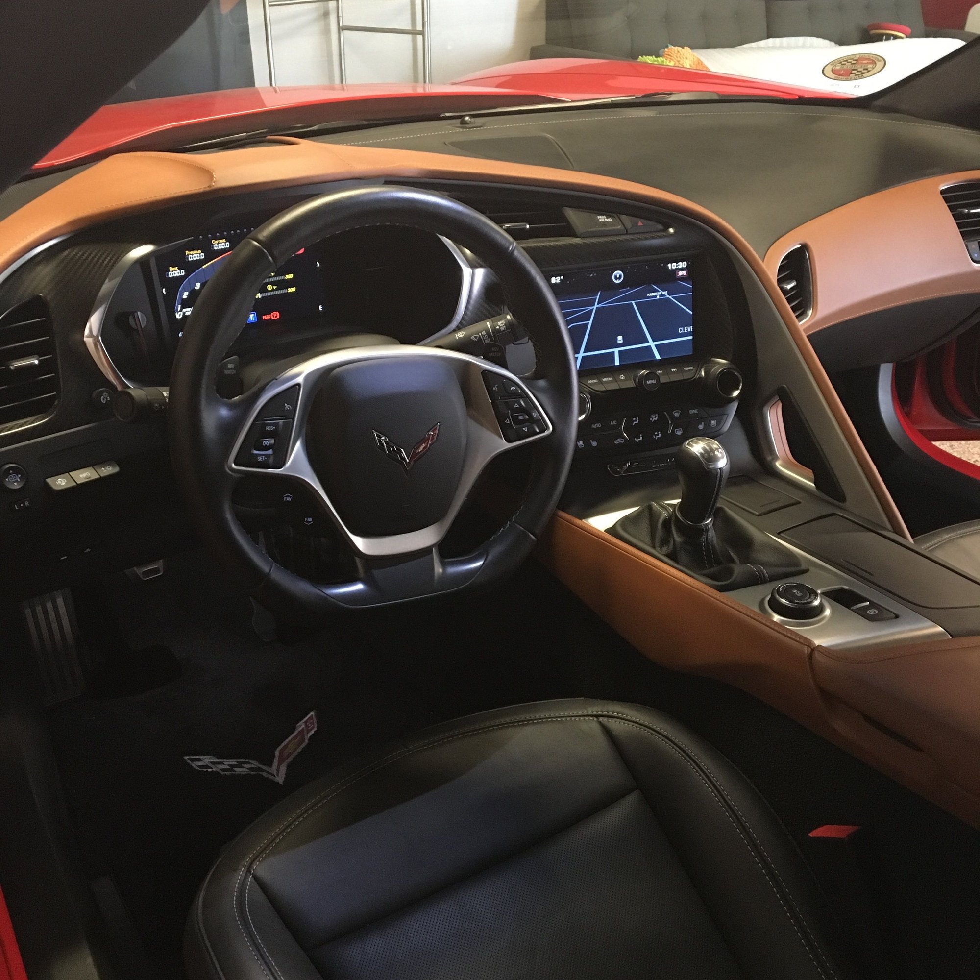

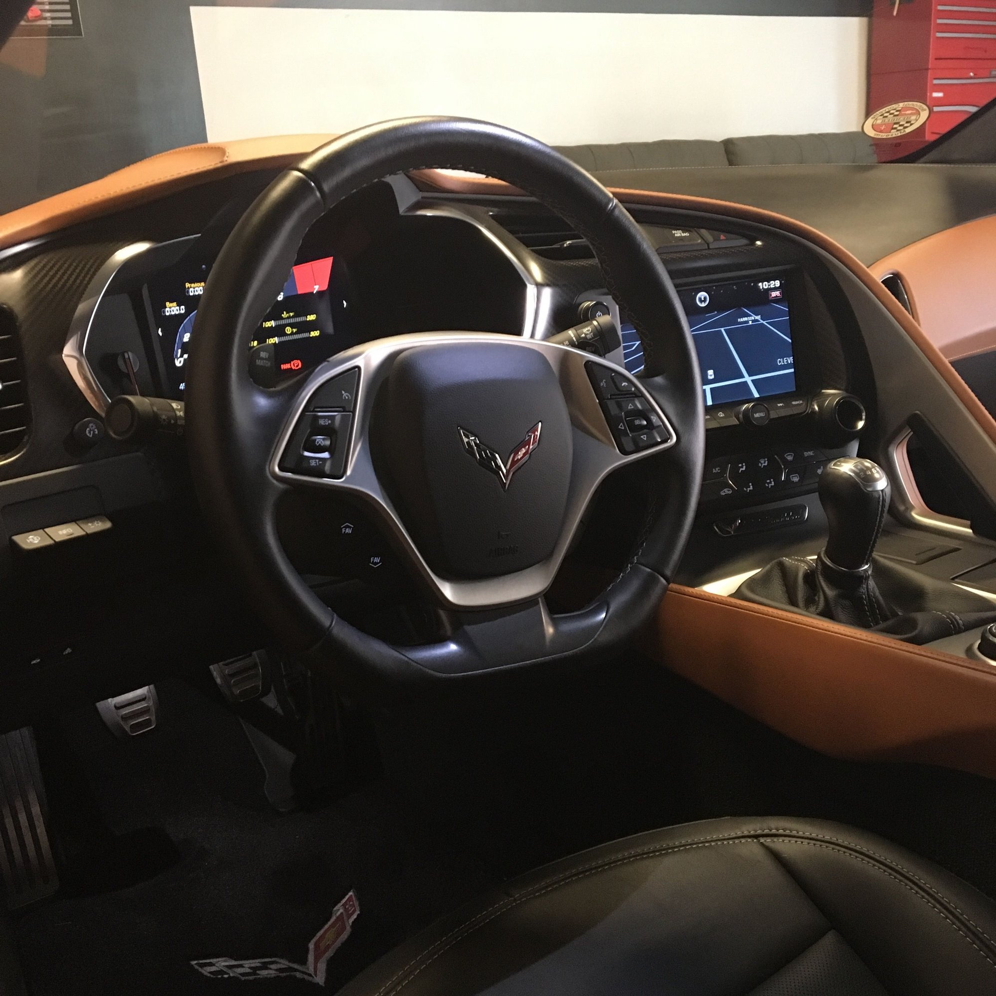

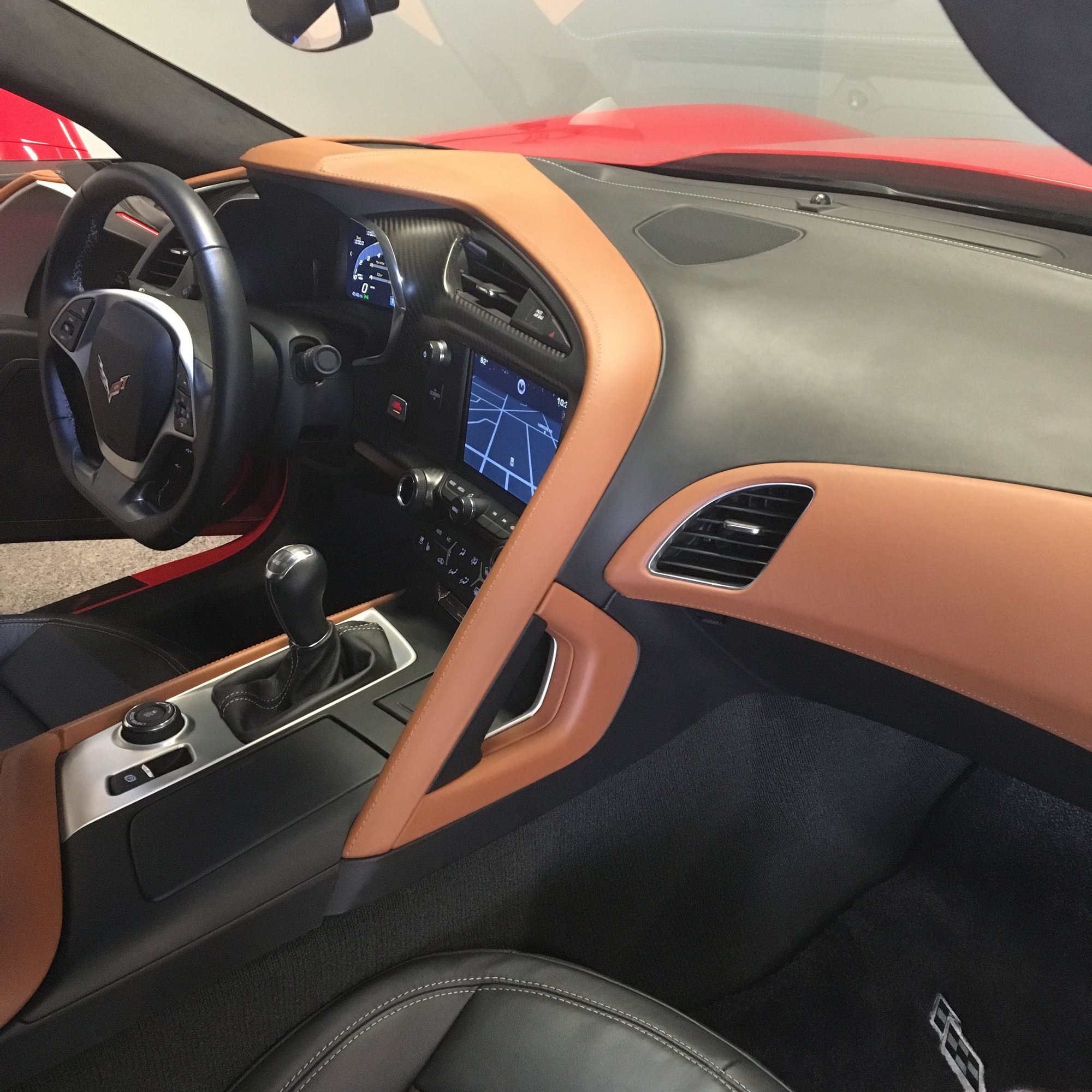

Now just reverse the process and enjoy the final look. Here is how mine came out:
