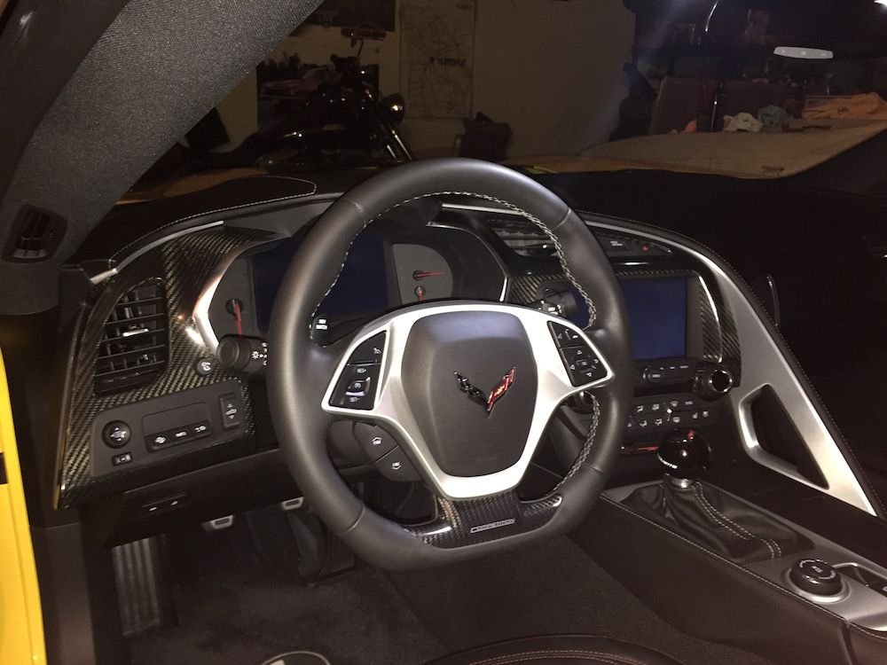

Thanks to Paul's excellent instructions, I was able to complete the task in under 3 hours of actual labor. All of the screws were easily accessed and all of the clips came off without incident. I also installed a CF center console while I was at it. The hardest part was disconnecting the wiring harnesses behind the dash and transferring electrical modules to the new dash. As a side note, what caused me the most grief was finding the right security bit to remove the AC controls. I bought a 100-piece security bit set from Harbor Freight thinking it would include the bit I needed. Wrong. The bit you need is a 5-point T20 torx security bit (mostly used in automotive applications). They are not generally available at hardware stores so after an afternoon of searching, I finally found one at Pep Boys. Anyway, here's the result:
Before and after:

I installed one in my 2014. I sold the original dash panel so did not have it available to remove before I traded it in on my 2017. I already purchased and installed the CF dash in my 2017 ... It is so MUCH easier the second time that I didn't even need directions... pretty sure I had it done in about 1 hour. If you have a convertible the top button is tough to disconnect .. so I just left it connected and passed the entire HUD bezel through the opening to remove the dash. Pass it back through to reinstall.
Also .. if you want more of a Semi Gloss effect ... buy the Matte Version and then polish it before you install. I was tempted to buy the high gloss version but decided not to in case it was too shiny in the convertible. Polishing out the matte version to a semi gloss is perfect. Here is pic .. I also polished the CF steering wheel cap I bought to match my competition seats ...
