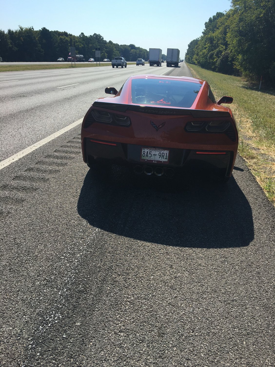

So I'm driving on my daily commute on the interstate and everything is fine.. Next thing I know my RPM goes all the way up to redline on its own and then whenever I press on the gas nothing... When I put it in reverse.. Nothing. No movement at all. The car restarts just fine, no check engine, no nothing but it won't go!!! There's some fluid leaking from the rear but that's about it. What could this be?!

Trans or rear broke

Auto or manual? but yeah tranny or rear went out.

Auto tranny. It was a red fluid leaking if that helps.

Yeah.... that's trans fluid. Hope you can get this sorted out!

Probably just a flexible line from the transmission to the radiator broke. They should not even have to drop the transmission to fix it.

You are absolutely right. The line going into the radiator broke loose and all the fluid spilled right out. Hopefully that caused no damage to anything but we shall see.
