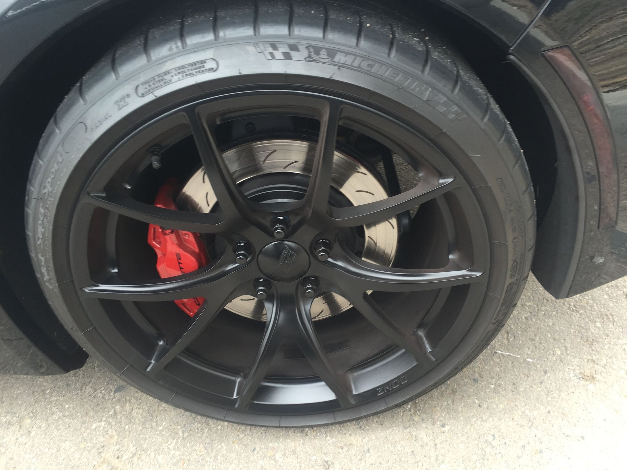

Originally Posted by Grant G
have standard calipers came w/car (2015stingray),I would like to paint them do I need special heat paint ,also do not race car ,if use standard automotive spray paint will they fade after time.
From black to red, painted with G2. Works for me...
