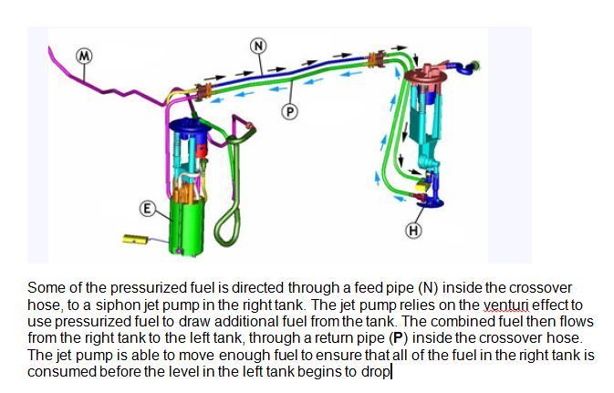

Originally Posted by TEXHAWK0
Don't think so... the fuel just flows through the crossover tube when the first tank gets full..until both tanks are full.
When the car is running, and the level drops in the left tank, the jet pump moves fuel from the right tank to the left tank until the right tank is empty.
As you can see, the fuel pumped from the driver side tank to the other tank is only enough to drive the siphon pump to move fuel to the driver side tank.
The engine only gets fuel from the left side tank (Line M), so the goal is to keep the left side full.
This is cool. Looks like its not a driven pump on the right side...not electric, motor, etc. The main electric pump bleeds some pressure to the venture pump on the right side to "siphon" flow to the left side.
Yeah, if he has tried nozzle position, etc. and that doesn't fix it sounds like its not getting fuel to the right tank.
