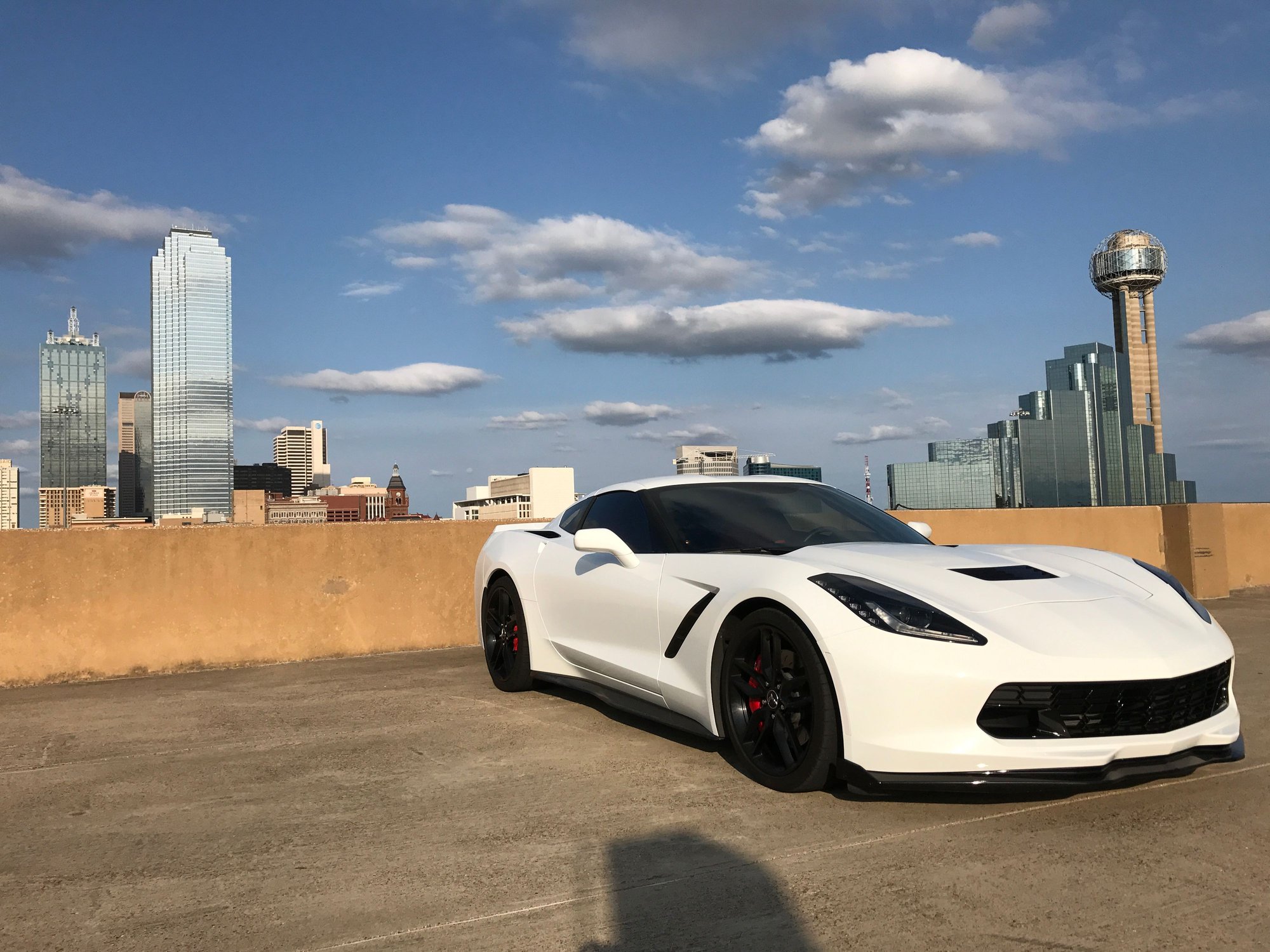

I seriously would NOT use goo-gone. That's a solvent. Not a good idea. Just use fishing line and it will be fine. Then rub your finger over the remaining double sided tape and roll it off.
I went a bit further debadging. I also painted the side markers with plasti-dip to make it even cleaner.
