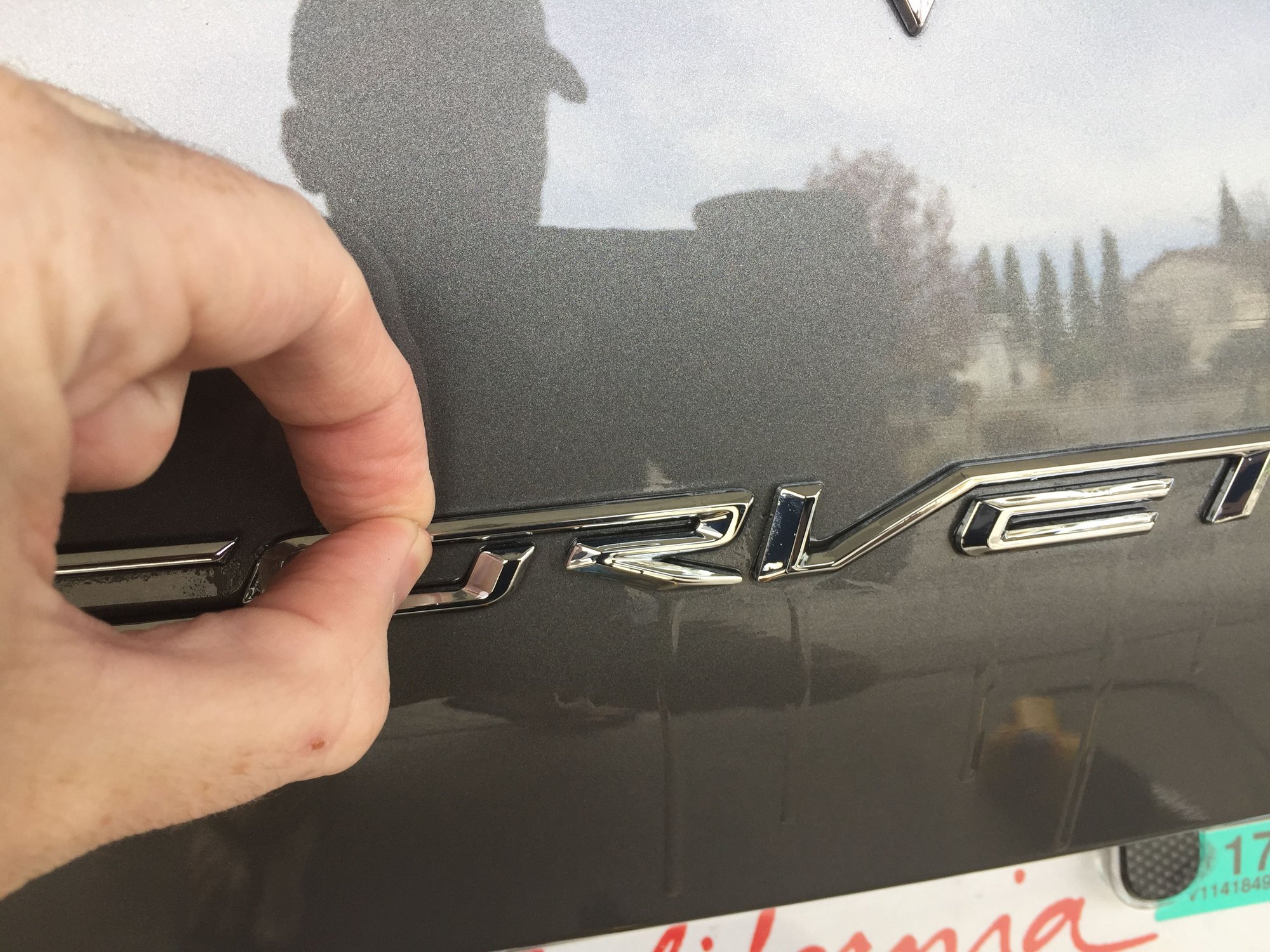

Inspired by some pictures on the forum, I decided to debadge the Corvette lettering, as well as the Stingrays on my 2016 C7. As this was my first time debadging, I was not sure what to expect, so I thought I would take some pictures of the process for others who might tackle this project.

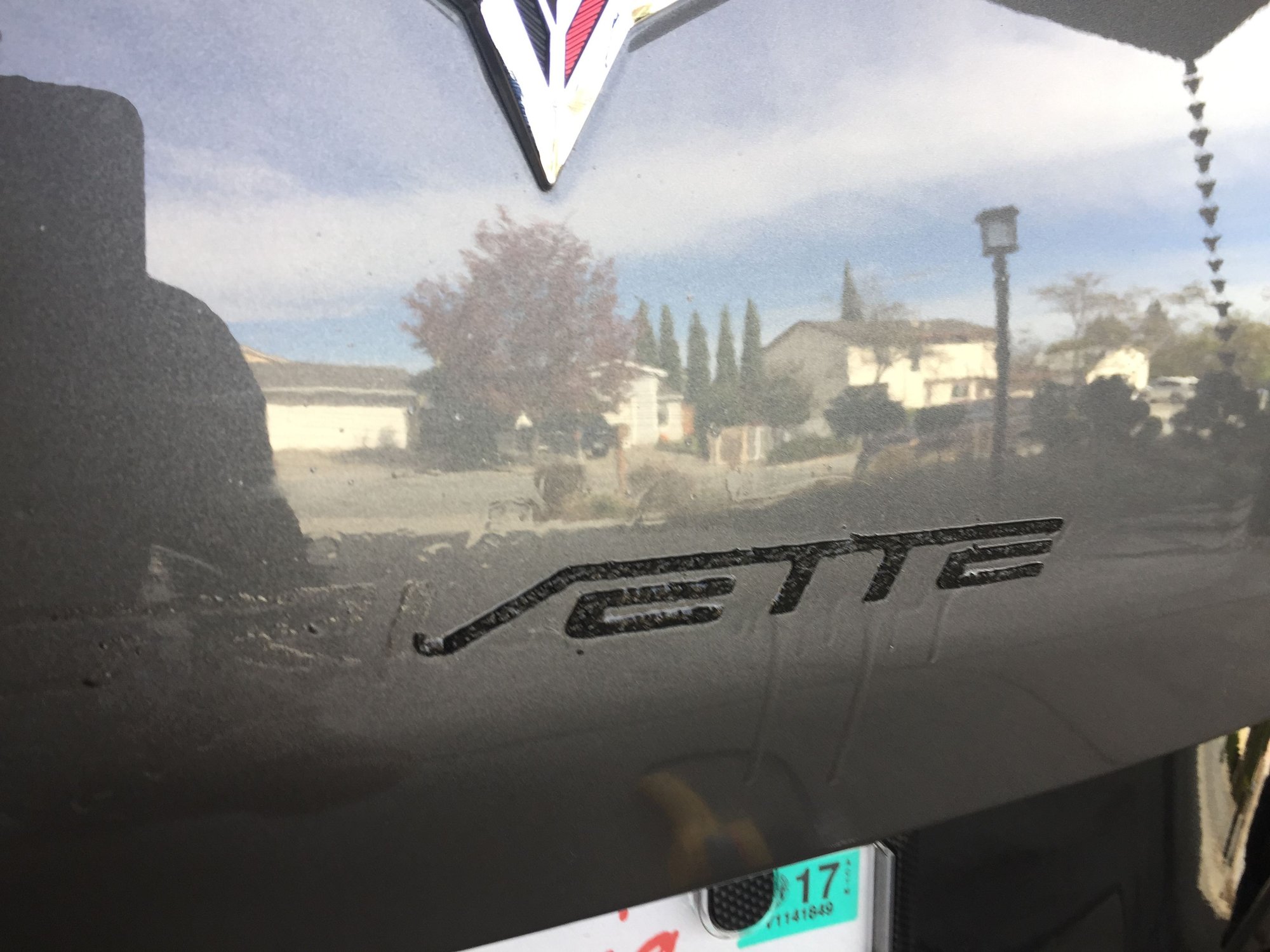

I started off by soaking the Corvette lettering badge with Goo Gone. After five minutes or so, when I noticed the emblem had more give, I started sawing off the lettering with dental floss (you can also use fisherman's line). Lettering comes off rather easy, compared to the Stingrays.
Afterwards you will have some black adhesive to deal with, which requires some elbow grease. (Note: Whether you use your thumb or a credit card, as I have heard others use, make sure you have some lubrication to ensure you don't scratch the paint.) I used more Goo Gone to get the majority of it off. Once it was only small bits of adhesive, I used WD-40, and a Mr. Clean Eraser. Afterwards, used some detailing spray, and a quick spritz of Black Fire Crystal Seal, and it looks great.
Pictures of the process:
Emblem will have some give after soaking...
After sawing off with dental floss (or fisherman's line).
Process of slowly scraping off.
Before and after...
