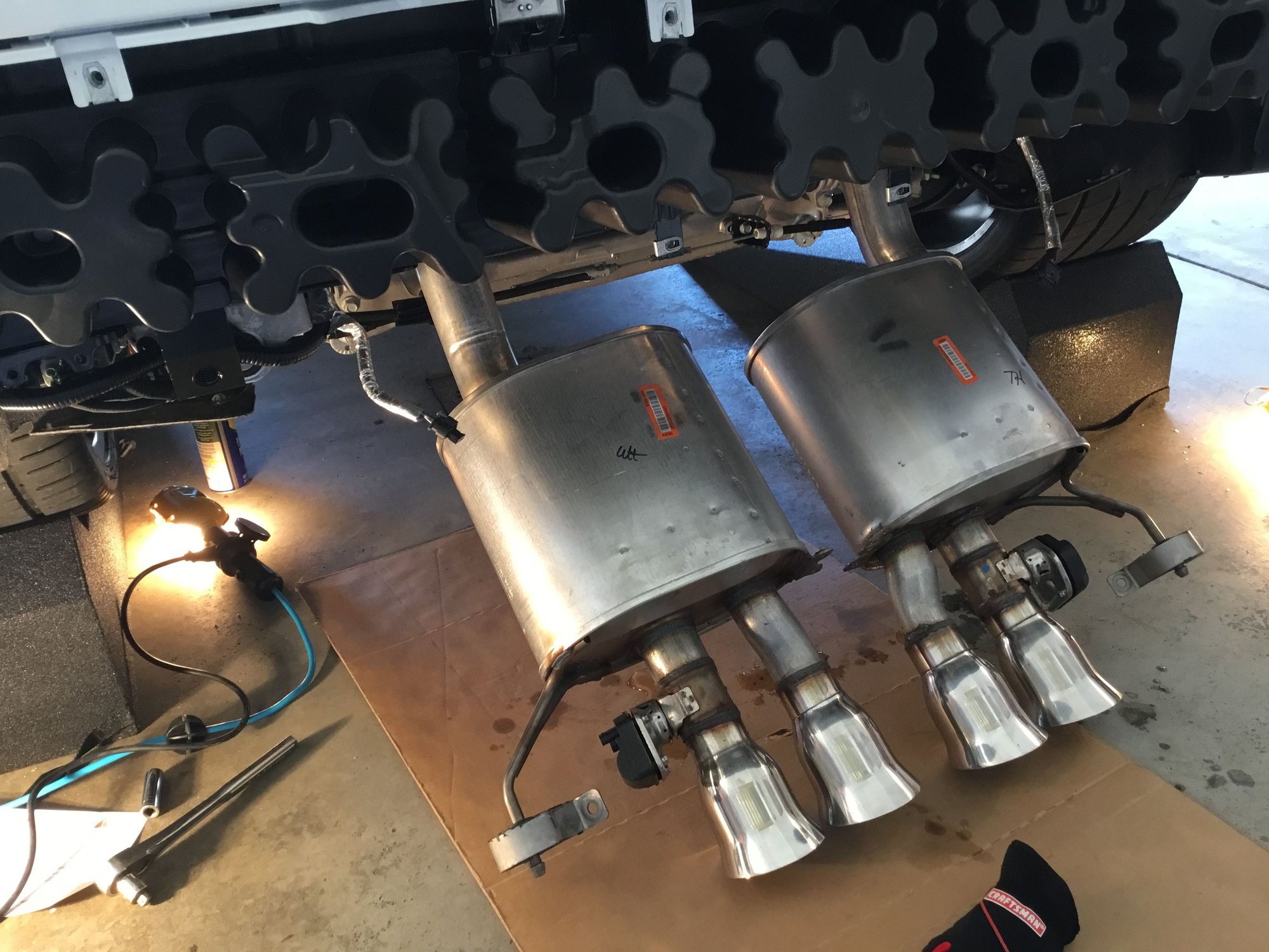

I swapped out my exhaust, but you can see from the pics of the bridge bracket. There is some play/adjustability, but not a lot:

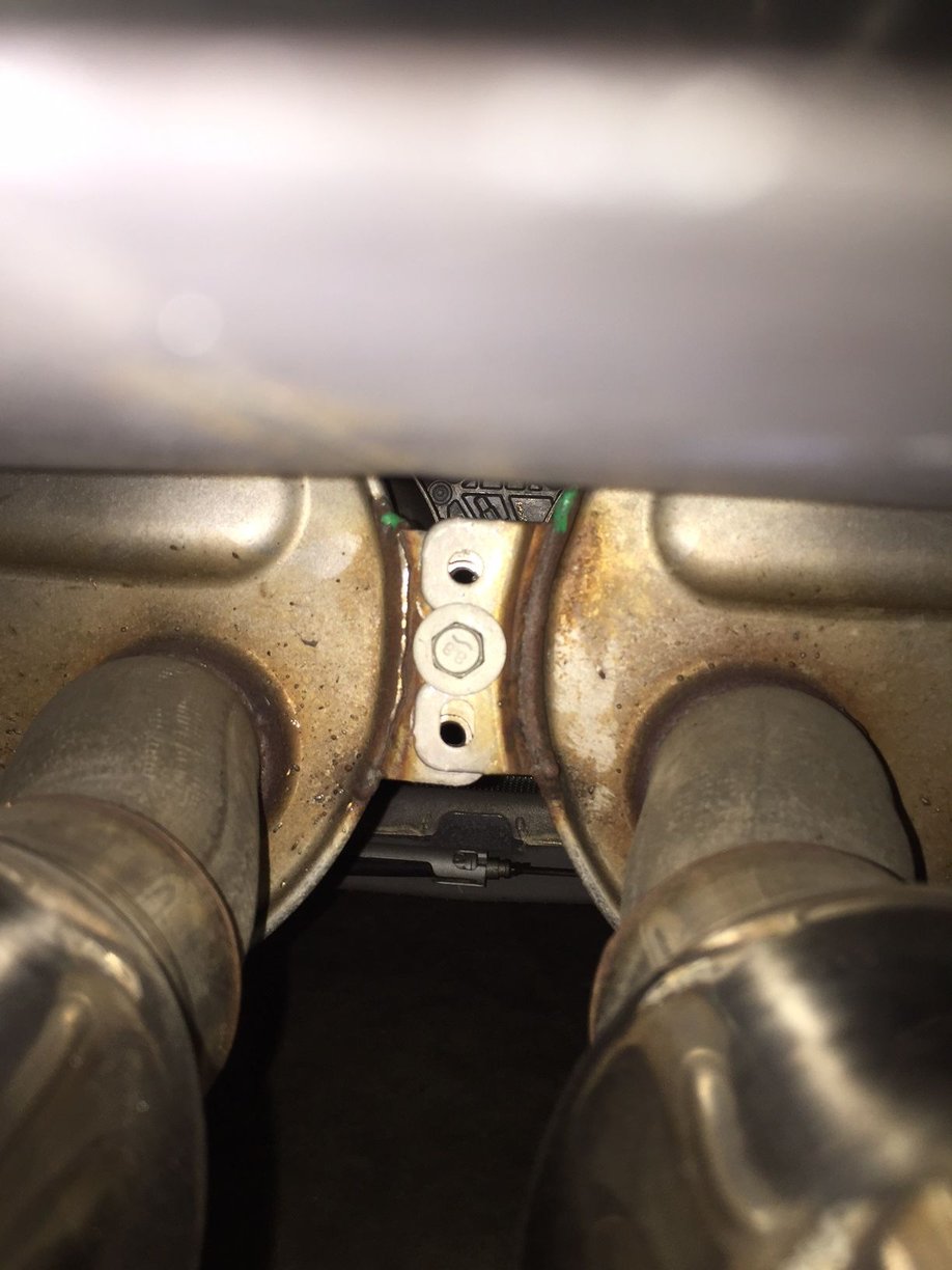

Default Adjusting Exhaust Tips: "The KratosBear Solution"
I loosened the two bolts on the bridge between the two mufflers, put a floor jack under the lowest one, and no joy. There was no adjustment possible.
Fortunately, CF member KratosBear pm'ed me with an amazingly easy and clever solution. As he did on his car, I simply removed both bolts, and inserted one of the factory bolts in the center w/ a locking nut on the back.
Done in 3 minutes, and it sure is it much simpler than drilling out the factory slots.
As can be seen in the picture below, the factory slots/holes are not even close to lined up properly.

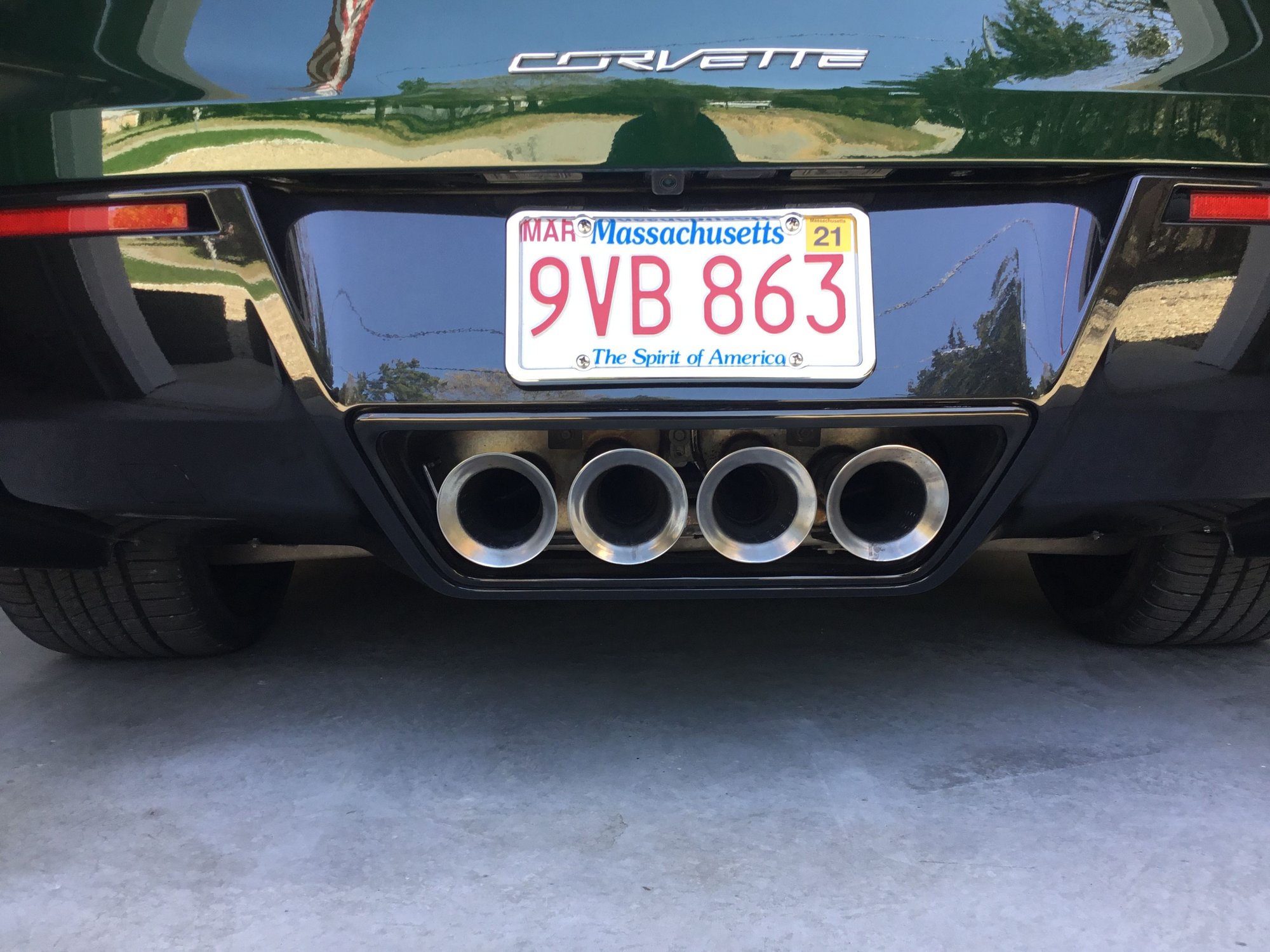

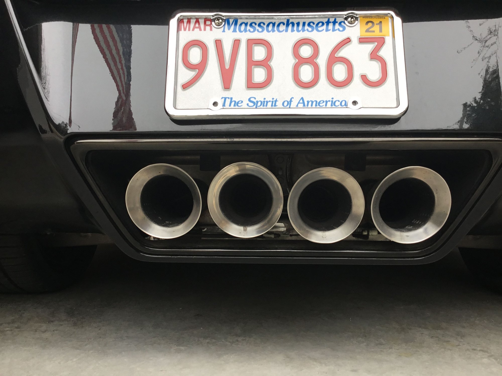

I’ve got the same issue on a used 2014 Corvette I just purchased. Only my exhaust tips have a bit of a twist on them plus one set is higher than the other. See pic. I loosened the two bolts and used a floor jack under the lower set but to no avail. I guess the next trick is the single bolt method although I don’t think it’s going to take cate of the twist. The second from the left is higher than all of them. It bothers me!

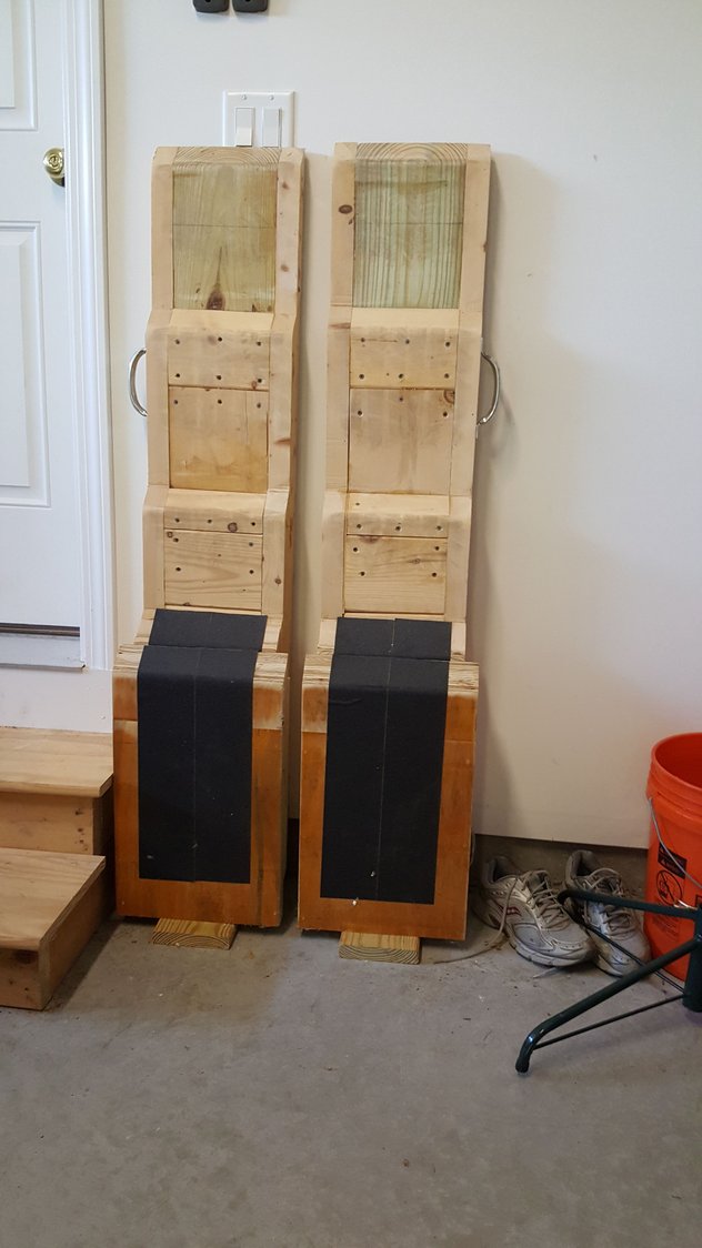

Well I took the advice here and was able to somewhat align the exhaust tips using the single center bolt process. The drivers side muffler has a slight twist in it which I can’t do to much about.
i had an addition put on my house about 4 years ago and was looking for something to do on boring a winter day. So with some left over wood, I built these ramps. Backed the Vette to the 3rd level and was able to get to the mufflers fine. I believe I’ll be able to clear the air dams in the front also. If not I’ll take them off to do an oil change. I’m going to have to purchase a new floor jack however, as my current one is about an inch to high to get under the side of the car to work on the wheels. On the to level I’ve made an add on saddle that’s keyed if I need to get even higher.

Or you could drive on your existing ramps to the 2nd or 3rd level and the put the jack under the car.

You can level the twisted muffler by loosening the muffler clamp, reposition, and retighten. If that doesn’t work, you can try the X-pipe clamp. It helps to have someone hold it in position when you tighten the clamp(s).
The factory uses a jig, but occasionally the mufflers can twist due to the rubber hanger bushings and too much torque. If that doesn't work, you can bend the hanger. There are many ways to align or reposition mufflers/tips...
