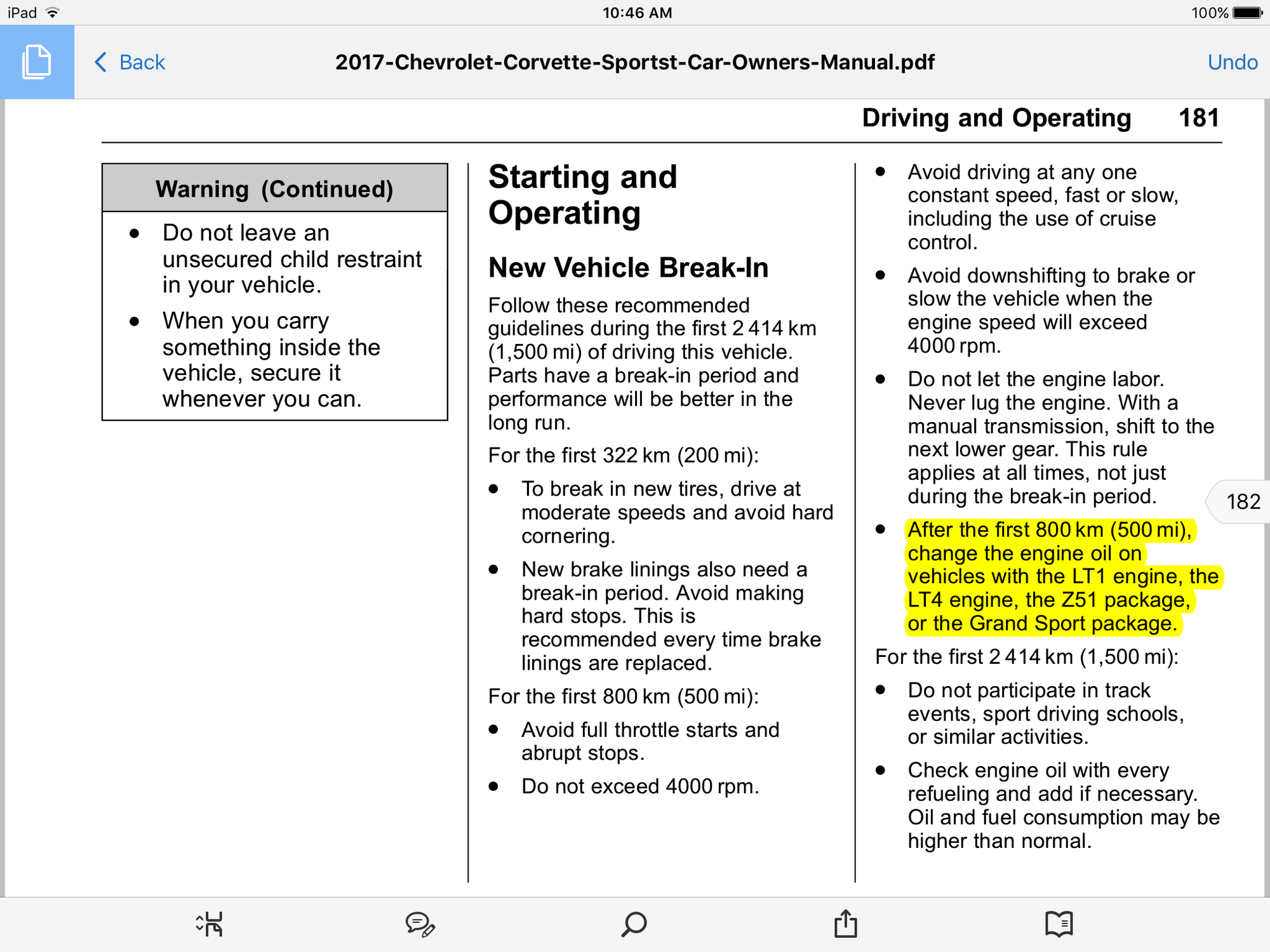

It looks like any LT1 requires the oil change at the first 500 miles :
My guess is that is a typo and the LT1 was meant to be followed immediately with Z51 package and GS in that sentence.
This is what is says on three pages: 24, 236 and 308 of the 2017 Owner's Manual:
Dry Sump Engine Break-In Oil Change
If equipped with a dry sump engine, the initial oil and filter change must be performed at 800 km/500 mi. Follow the engine oil life system for every oil change thereafter.
You could interpret it the way it's written, as it's also needed in a wet sump but will be interesting to see how a dealer reads it! If true, the GM Bulletin logic as to why it's needed would change. Have not seen anything stating it has.
Perhaps the Chevy folks who monitor the forum can clarify if a wet sump required an oil change at 500 miles!

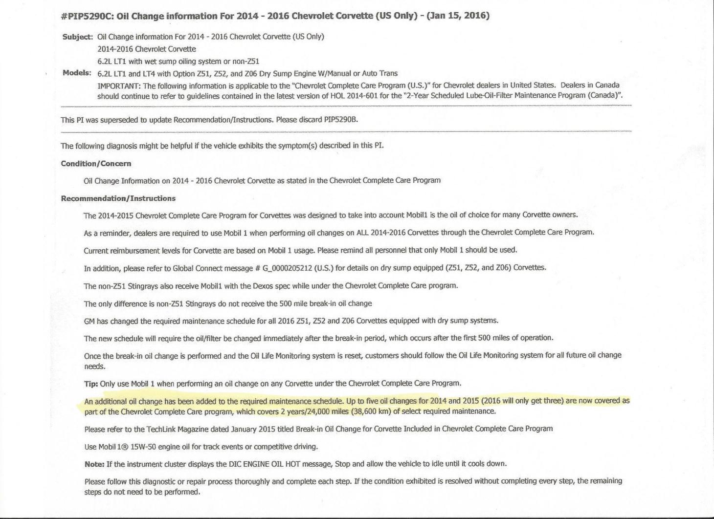

It has nothing to do with "steel pieces from manufacturing or oil filter entering the cylinders." See multiple posts above. It pertains to dry sump cars only and pertains to oil foaming from the new and curing silicone seals getting into the air intake, which can only happen on a dry sump system. It's done at 500 miles, because the seals have had a chance to cure.
It it were what you say it is, it would be required for all C7s, not just dry sump cars.

Sorry, it is a myth. The recommended oil change has absolutely nothing to do with metal in the oil. Some early C7 oil filters were not correctly threaded and a piece of the thread broke off and went through the rod bearings. Draining and changing the oil would have done nothing to prevent the damage.
The oil change recommendation for the foaming issue came almost immediately after the oil filter issue was discovered. People associated the two events and surmised the oil change was to eliminate the metal. It is not and has never been the case. But the myth was born and is perpetuated here.
Anyone who has ever built an engine knows the number one rule is to make sure everything is clean. Metal particles from machining have to be removed prior to the engine being built. If you let them circulate through the engine for 500 miles you have already damaged the engine. Changing the oil after 500 miles will do no good at that point.
