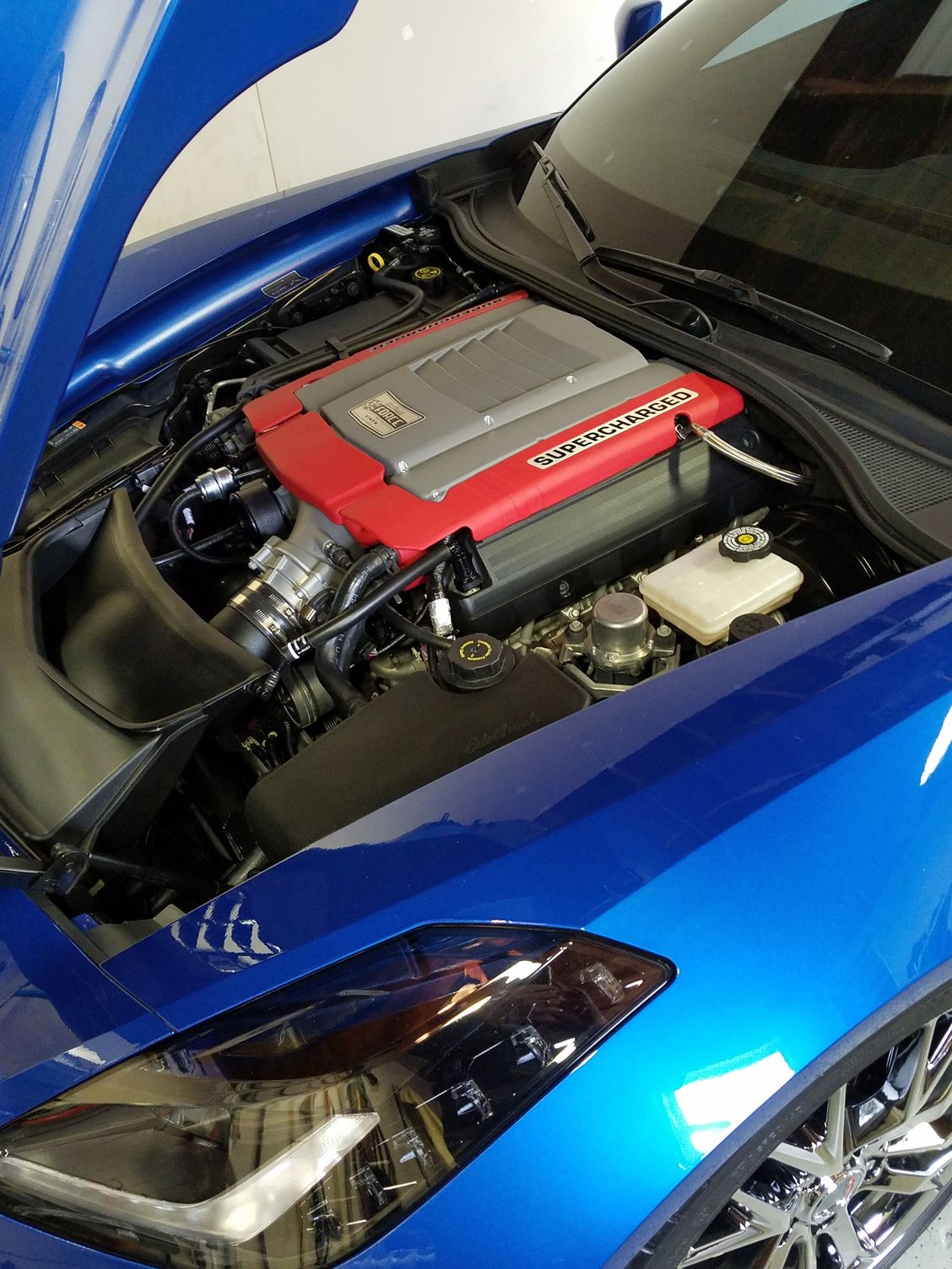

3. You don't have to cut the hood liner. If you don't, the top of the blower will rub on the
liner and will eventually mark up the very front red part. Even with it cut, a few of us still have
a few marks on the corners. I mean, the engine still moves around under hard acceleration.
Once I painted the edges, the felt dust went away and so did the marks. Mostly

This is what mine looked like after the felt was cut but wasn't painted with enamel yet:
I had to wait till it wasn't raining to make sure it was dry before closing the hood.

Same with mine. My hood liner is cut per instructions and it still rubs.

I got pissed and just pulled the hood liner out. No additional mechanical noise without it. I know it's also a fire blanket but...
