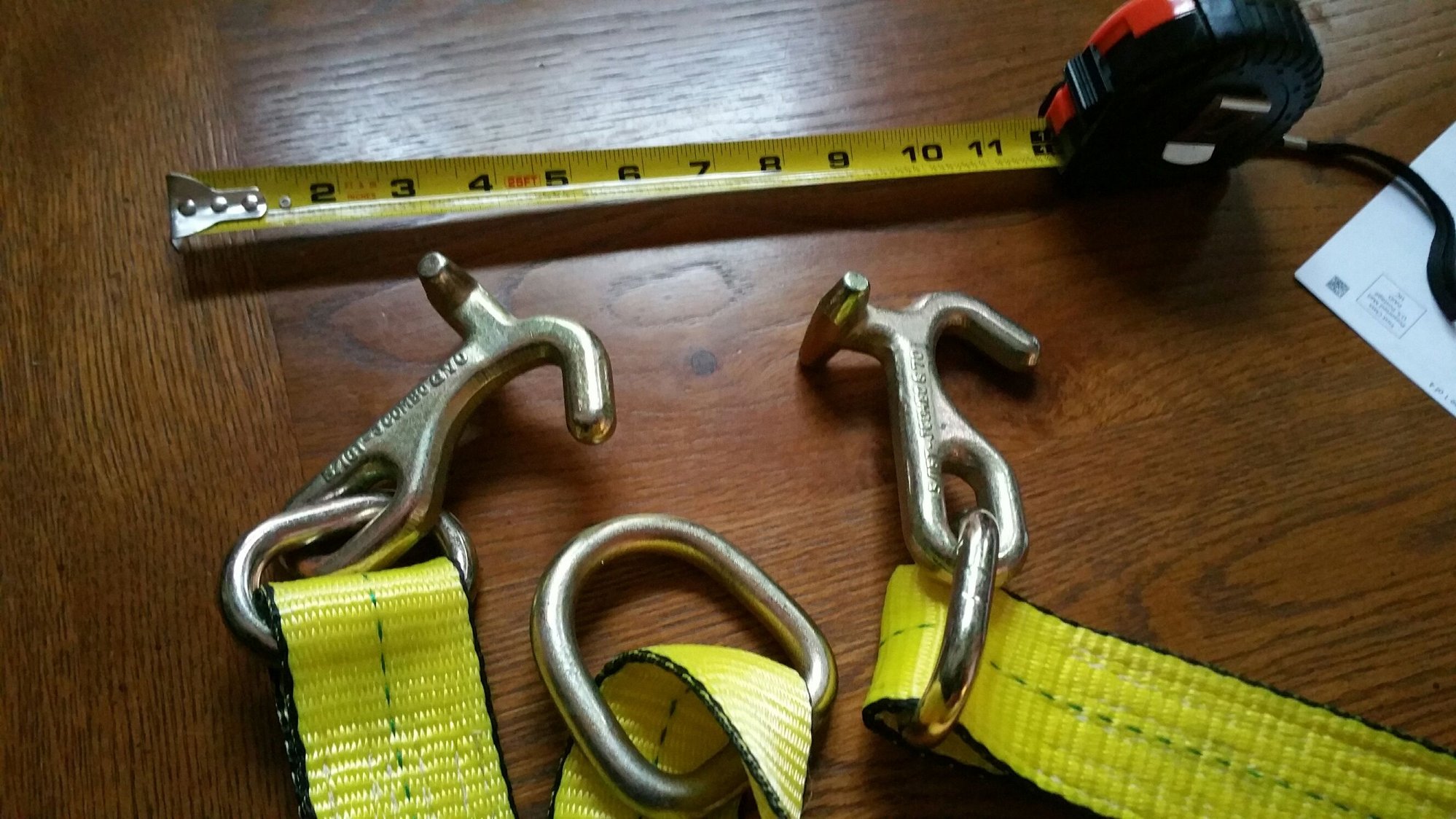

I have a dealer on ebay who makes the recommended tow solution that works for all of us. He will make the double length v bridle shown below at no extra cost if you just call him and let him know.
Thanks for posting, I think I will order one of these [I do wonder why they did not fasten the straps to at the top. If one slips out you will be in a little trouble. But still looks like the best solution for me!]
Here are the attachment points:
Never
The blue circles mark the V bridle front and rear Tee hook points

Originally Posted by felkebg
Got to be careful with that, you can only tow from a point that is very low with that, otherwise you will be rubbing the front pieces. For instance the winch on my trailer is too tall to use that type of tow strap. With the other tow hook you can tow from almost any angle.
Old Jan 12, 2017 | 12:46 PM
felkebg's Avatar
felkebg
Joined: Jan 2001
Posts: 733
Likes: 225
From: Auburn AL
I agree. I have another thread where I describe how tow drivers typically employ a 4X4 over the bridle and under a support piece and also use a small ramp at the edge of a flatbed setup to avoid any contact. They typically only want to load with the C7 going forward facing.
For those who have receivers as I do the other setup should function well. Someone wanted to know why two would be preferred. Track folks like to remove a vehicle quickly and not having to mount or move tow hooks can speed up the process.
