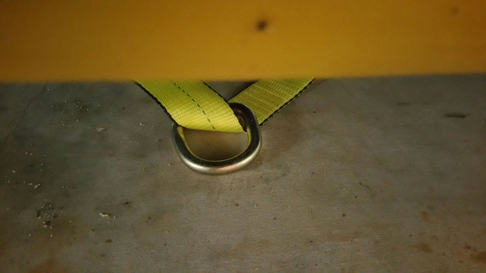

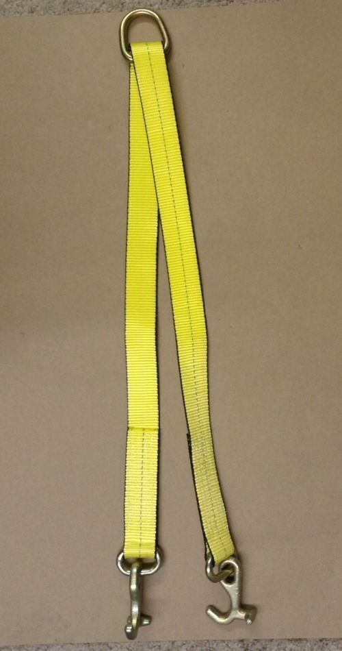

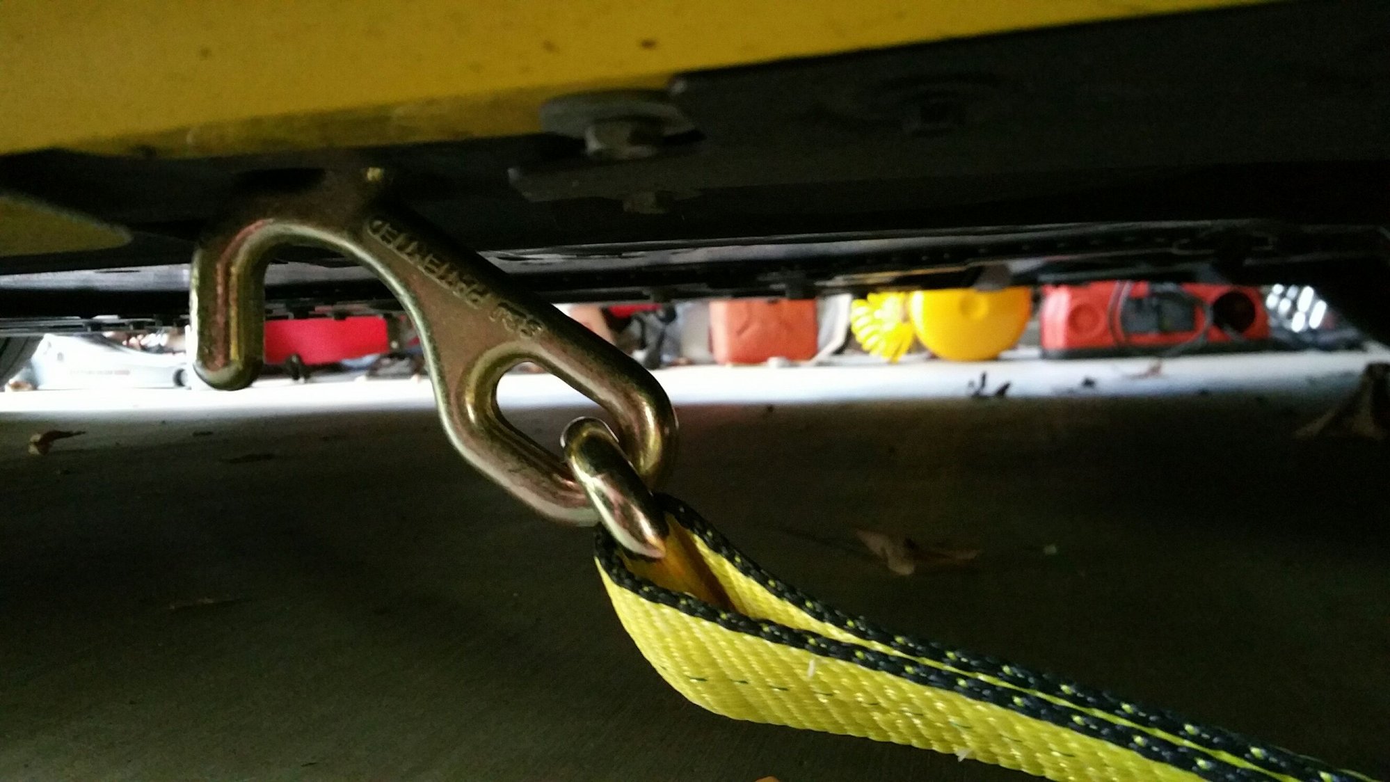

I have a dealer on ebay who makes the recommended tow solution that works for all of us. He will make the double length v bridle shown below at no extra cost if you just call him and let him know.
Works on every C7 with or without tow hook receivers.....
Tee hook to lifting puck slot. Cost $44<br/>
Front or back tow with no damage
Here is the ebay link:
http://www.ebay.com/itm/V-Bridle-wit...mtr&rmvSB=true
To get the double length for free call the ebay dealer Glen at:
864 490-9591
Old Jan 11, 2017 | 10:05 AM
