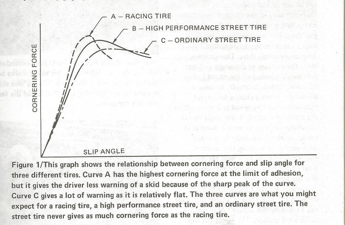

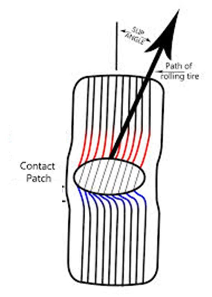

Ackerman got a patent in the 1800's for his compensation for the different radius of the front wheels in a turn. Apparently a big problem with wooden horse drawn carriage wheels!
However it doesn't explain why the chatter goes away in a C7 with the same Ackerman geometry front end and tire width when winter tires are swapped for the Michelin's. Slip angle does!
Below are two pics from my PDF. Have ~5 pages of a steering kinematics text but that can put everyone to sleep! It shows why slip angle is a key to providing compensation in rubber tired cars.
Suffice to say no rubber tired car uses full Ackerman geometry compensation (it has a negative effect at high speeds.) They rely on slip angle providing some of the needed compensation in tight slow speed turns. Race car tire construction has very little slip angle, hence not much compensation!
Slip angle provides some of the compensation for the difference in turning radius on slow speed turns.
Race tires have much less slip angle, which results in less compensation when making slow speed turns. Hence more chatter. That is offset by higher achievable "g" force in high speed turns.

The reason I present these technical issues is to show it's NOT caused by lack of Ackerman steering geometry compensation as some have stated. I never had this issue with the same width front tires on my C6 Z51 and in my first C7 Z51 winter weather in 2013 wondered why it was so bad. So investigated. The sever "chatter" or "hopping" occurred when it was below 40/45F when the tires had less traction not when they were "more sticky!" Turns out the use of the tire surface "squirming" or slip angle has been long known as providing some compensation for the different front tire turning radius on sharp slow speed turns! Validating tire slip angle is the cause is it goes away with more normal slip angle, same width winter tires!
It's important when you have a friend in the car and turn the wheel sharply and it "hops" to understand it is NOT a design fault! It's the consequence of having very high performance tires that provide super traction when they are warm!
