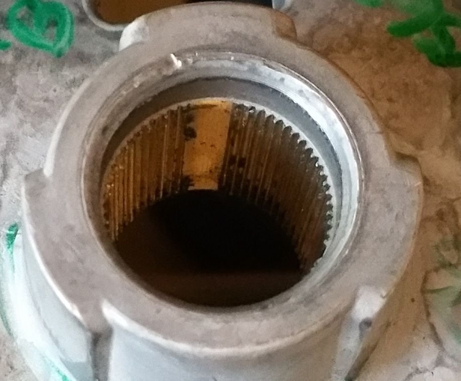

They will have to do an alignment and also adjust the center of the electric power steering so it doesn't pull. Looking at my spare C7 wheel, it appears that there are splines, but there is also a ~1/8" "key" at 6 oclock. Not sure how his steering could end up off unless something happened to knock the car out of alignment.

When replacing the steering wheel, it is easy to not get it back on "straight". I did it myself when I installed a 2016 flat bottomed wheel on my 2015.
I would suggest your friend re-pull the wheel (or ask the original Dealer to do so) and try reinstalling it before getting into alignments, power steering adjustments, etc. There are step by step instructions here in the forum.

Hmmm... Guess I didn't realize that was possible to get it on wrong. When you look at the wheel it does have a key area to it. Guess when we did my dad's car we must've got it right the first time. At least it's an easy fix assuming the OP can get the dealer to do it. Personally I'd do it myself. It's pretty easy to take off. Probably less hassle than taking it to the dealer a couple more times...
C7 wheel splines in case anyone is curious:
