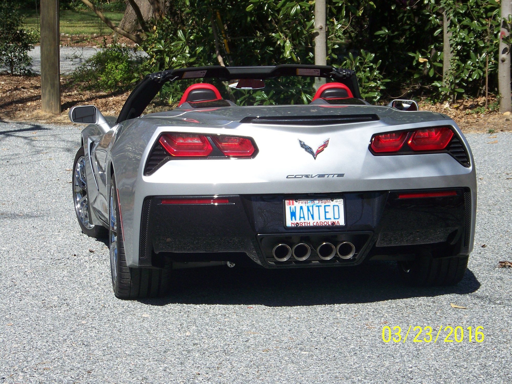

The stock Stingray, without NPP, has only one outlet from each muffler that splits into two exhaust tips and no valves.
The NPP muffler has two outlets on each muffler. One has butterfly valve, the other is open. The advantage of the NPP muffler is that when the butterfly opens, the exhaust goes straight through and essentially bypasses the muffler.
