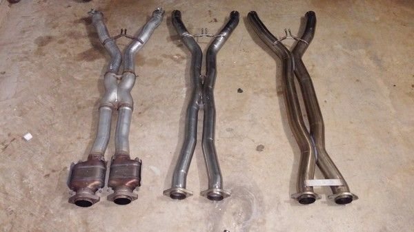

In a recent thread some were surprised to see the OEM C7 has an X-pipe. Vettes have had them for some time. However the Borla and Corsa systems eliminate the small secondary CATs! That is what makes the more aggressive sound. Have to watch for state and possible warrenty issues.
OEM left with CATs, Borla center, Corsa double X pipe right.
