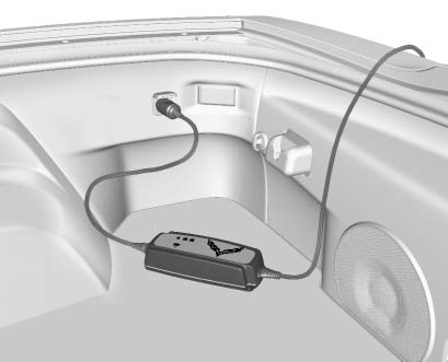

Owners manual 10-30
Plug the battery maintainer into the rear
Accessory Power Outlet (APO). The
front APO turns off after the Ignition
is off.
