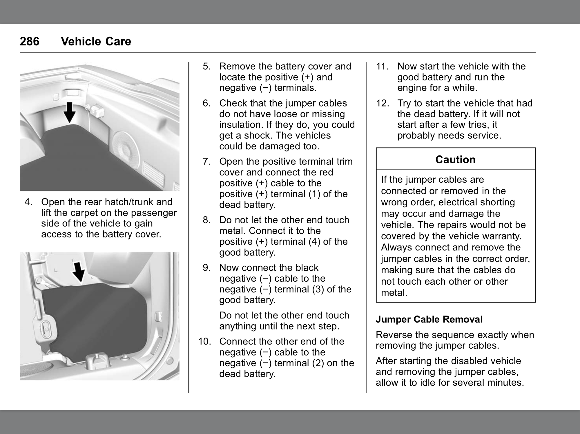

Originally Posted by fredmills
Is there a positive post (and ground) under the hood that can be used for jump starting?
Owner's manual:

1) Yes you can jump start the car using the direct connections to the battery in the rear.

This is what it said on page 1-20 of the 2014 C7 Owner's Manual:
"Jump Starting the Battery
The battery is in the rear of the vehicle. Access to the battery is not necessary for jump starting. There are remote positive (+) and negative (−) terminals under the hood for this purpose. See Jump Starting on page 10-65."
For several months forum posters were defining where those "terminals" were and showed pics (positive on the input of the front fuse box!) However I looked at the size of the wire and it was far smaller than I used in my Street Rod that has it's battery in the far right corner, like the C7! I had used starting current draw and wire length then calculated and used a much large gauge wire! As someone mentioned, starting currents can exceed 300 amps.
I sent a PM to the Chevy Customer Service folks who monitor the forum (much more so in 2013/3014 than now.) I asked: "Is the Owner's Manual correct? I pointed out that the page referenced, 10-65, said nothing about jumping from the engine compartment!" They replied after some time, "Their Sources" said "the manual was correct."
I then asked, if it was then were is the positive terminal location. After several attempts to get an answer I was told "They cannot get an answer from "Their Sources!"
It was finally resolved when that obvious error in the front section of the 2014 Owner's Manual was printed for 2015 and subsequent years. It was removed!
