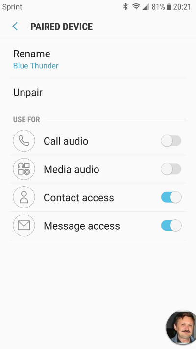

Don't know. Never "set up a media profile" for my phone or rather when I connect my phone to the car (pairing it or later when it just connects) if I go into settings Bluetooth there are two profiles listed.
On my S7 running Nougat (though other Android phones are similiar) I pull down on the shade and tap and hold the Bluetooth icon. I named my car "Blue Thunder" which you see at the bottom. It's not connected right now:
Next I tap on the gear icon and it shows me the Bluetooth settings for Blue Thunder:
As you can see, while they are not currently toggled on, there is a "Call audio" and a "Media audio" setting. When I get in my car it will flash up on the DIC - Bluetooth Connected. You get that when "Call audio" (for the phone) connect. You get no such indication for Bluetooth Media audio connection. Apparently most people think that Bluetooth and phone means phone calls only. Witness most Bluetooth headsets that only occupy one ear!
In any event, when connected to your car, check the properties for your Bluetooth connection on your phone. If it doesn't say phone and media, tap on the gear and toggle on media.
