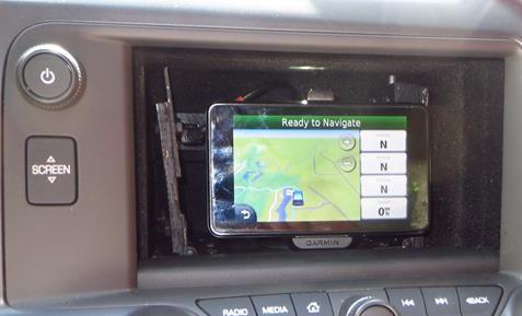

A forum poster suggested I could put it in the cubby! Works great. Just drop the screen when I want to use it or just look at the MAP when I want to know the speed limit on a road etc!
I made a holder to mount it. Prevents it from moving when going over bumps etc. Plugs into the USB in the cubby-no wires coming outside.
This is a PDF of my install and a thought of a simpler way to make a mount shown at the end. Lots of pics:
http://netwelding.com/GPS_In_Cubby.pdf
PS: I don't turn my cell phone on when driving the Vette! Have enough to do watching out for distracted drivers to keep my 55+ year record of never having had an accident with another vehicle! The Garmin doesn't call with useless text or voice messages that tempt me to listen!
Cubby is covered with fine felt so suction cup mount won't work. Used an 1/8 inch thick aluminum base with side that press in the top so the Garmin doesn't move over bumps.

FWIW, always have my ~5 year old Garmin connected to the USB in the cubby. Initially there were a few times when it took 5 minutes to find a satellite. How it's connected instantly as long as it was connected to a satellite when I stopped as when in town.
When pulling out of the garage where it looses the signal in takes 2 or 3 minutes to find the satellites again. Have not removed it from the cubby or disconnected from the USB plug since installed.

With the screen open it's cool!
Have checked and with the screen closed for the times I tried and when I opened was not hot to the touch. Will use my infrared detector after it's been close a while and quantify. Specs for my Garmin say it's operating range is 32F to 140F. Doubt it will get close to that hot!
Details of USB Cable:
Just looked this up as all I put in the PDF of my install was the cable part number I used:
"GPS devices such as Garmin come equipped with a USB cable. It's primarily intended for connecting the GPS to a computer, enabling users to install or back up new maps, points of interest, and tracks or routes. The supplied USB cable won't power the GPS directly, but there are alternative methods:
Various companies manufacture aftermarket chargers and cables wired to power Garmin GPS devices."
The power cord that plugs into the USB that I used was sent to be by a Forum Member is Redband USB Cable for Garmin Novi Power 9 inches Long. Part number 202-0063-09
I had mentioned in my PDF introduction that I had posted about planning to use a ProClip mount for my Garmin that attaches to the passenger grab handle. It comes in two parts and cost $60. It would have remained in place even with the GPS not connected. Was planning to use the power cord that plugged into the receptacle on the console. The ProClip is also one used to hold a phone but does look like a wart when mounted!
Fortunately a forum member sent me a PM and said, "why not mount in the cubby as I planned." He had sold his Vette but had a 9" long cord that was designed to power the Garmin-not the one I connect to update the MAPS! It's apparently wired differently. He sent it to me FREE!
With the screen up the GPS is not visible and when needed it looks fine, IMO, compared to a phone/GPS external mount.

Originally Posted by JerryU
Sorry man but to me that looks hideous!
Think you posted that before! Form follows function, so I think it's beautiful!
Suppose if I put the GPS (or a cell phone ) on a ProClip mount secured the passenger grab handle you'd think it looks better! I don't!
When not using the GPS and the screen is up you can just look at whatever! Since I listen to the ~1000 sings I have playing on in shuffle mode from a thumb drive as soon as I get in the car, don't need to see the name and song! If I do I just raise the screen!

Decide to get actual data re your comment of excess heat in the cubby.
TEST DETAILS:
Drove the car into town to get a Certificate of Origin from the Chamber of Commerce. It was operating for about 1 hour of which 10 minutes was parked waiting for the raised seal and notarization (some countries are a PIA!) The screen was up all that time and the Garmin operates when the car is running.
Came back home and with the kept the Vette running while I got my Infrared thermometer. Checked the reading by pointing at the large thermometer mounted on a white metal holder in the garage, which read 80F as did my Infrared thermometer!
GARMIN TEXT RESULT:
Lowered the screen for the first time since the car was started in the AM. The cubby black interior reflecting off of the felt and the wood holder read 85F on the Infrared thermometer.
The center of the Garmin screen, where it was white read 96F on the Infrared thermometer.
The outer black boarder around the center Garmin screen read the highest at 103F. Note the color of the area being read does affect the temp reading.
BOTTOM LINE:
On a cloudy SC day with a temp of 82F and Vette air set at it's usual 72F the cubby reached 85F with the screen closed for 1 hour. Interior car surfaces read just slightly less accept for the air-conditioning vents that read ~65F.
The Garmin on the outer black edge of the screen read 103F. That is well under he 140F max allowed temp shown in the specs!
FWIW
