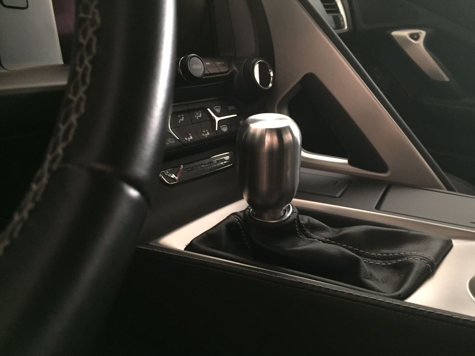

Thanks. Yes, it was a piece of cake. Once I put the channel locks with a microfiber towel around the ring it turned and dropped immediately with no damage to the ring. The boot stayed attached to the ring.
The #20 Torx screw which some have said was a bear to get out was not. I used a Torx bit in a small ratchet and it released immediately.
10 minutes later, and my new TWM Performance, brushed billet, solid aluminum, weighted shift **** is in place. It weighs 1.32 lbs., and height is adjustable. I have it considerably lower than the stock shifter for a shorter throw.
I haven't test-driven, but did test shifts in the garage, and it seems like a lot less effort with the shorter throw and weighted shifter. I think it's a nice compliment to, and matches, the brushed aluminum on the console.
It doesn't have the shift pattern etched into it, how on earth do remember which gear to go into next?
In all seriousness I like it. Looks more appropriate than an "old school" **** on a completely modern vehicle.

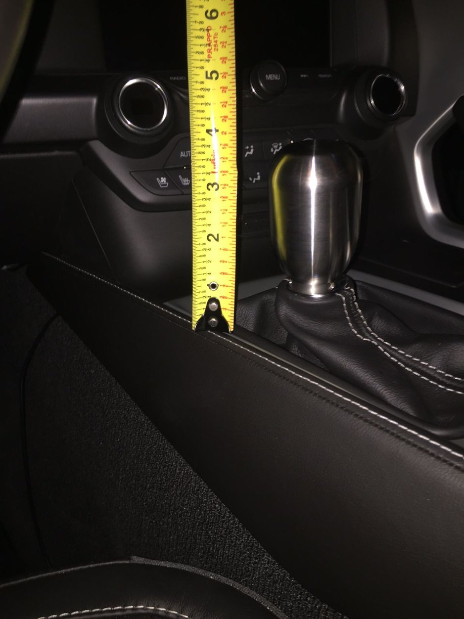

It's quite a bit lower than yours right now, but could be adjusted much higher with the collar design that can be tightened almost anywhere on the OEM shaft. I tried to duplicate your picture.
I did test drive it tonight, and the shifts are very precise with a much shorter throw and a resultant less effort. The weighted **** does make a difference, and the shorter shifts make me happier.
Yep, that's pretty dang short.

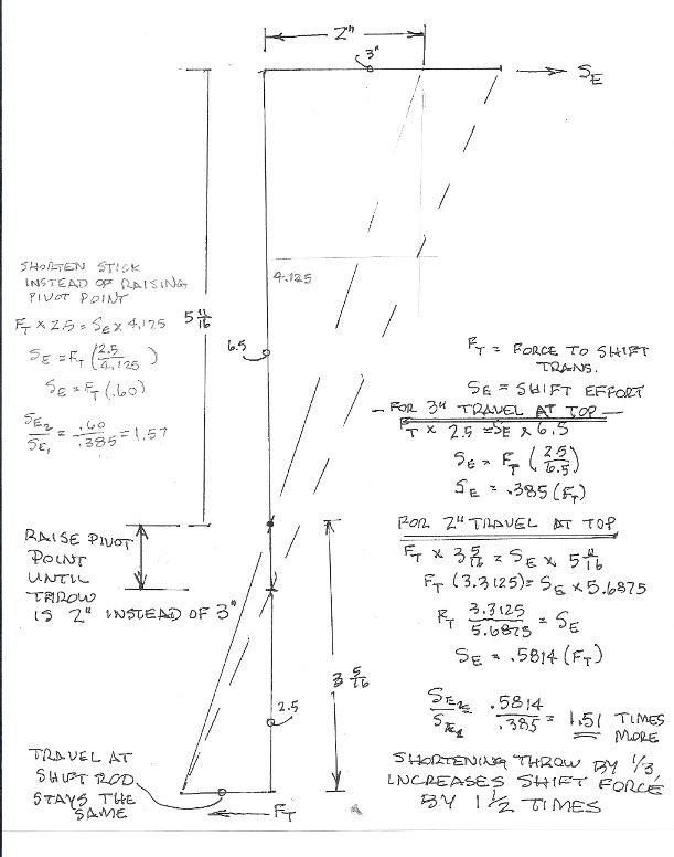

I am surprised that you can get into 6th and 7th without a lot of effort, but if you never really use them, it does not matter.
I think even MGW reached a point where they thought the throw was getting too short and backed off a bit. I have seen some comments about the Hinson shifter being too short, and the increased shift effort was not worth it... Let us know where you settle out....
I did a rough calculation a couple of years ago that shows if you decrease the throw from 3" to 2", the shift effort increases by about 1-1/2 times.

Just measured my cue ball height and it's 3 3/4 inches from the console. But went a step further as outlined in my PDF and measured the actual stroke reduction=~12%.
But as you note, there is no free lunch! Decreased stroke creates an equal percentage increase in force. Then you could always grab the OEM **** from the side, below the top. I'm reminded when I had a "Three on the Tree" in my '50 Ford and grabbed the shift lever at the column! Took more force but we thought that was cool!
Archimedes is quoted as saying in 300 BC, "Give me a long enough level and a place to stand I shall move the earth!" Considering his height and weight the most he could move it with an infinity ridged lever- it would not have move very far!

Drove it 30 miles to work today in DC, which is a combination of twisty, country roads close to my home, highway, and stop-and-go city. Thus, I shifted frequently, upshifts and many downshifts, and frequently used all gears. Shift effort was very light, throw was much shorter, very precise, and I never missed the gear I was selecting, but then again, I never do. If anything, 6 and 7 are easier to get into without the long throws of the OEM set-up. Reverse is easier as well.
The shift action is definitely smoother, and I perceive it to be lighter and more precise, but that's tough to quantify. I think the inertia generated by the weighted 1.3 lb **** helps lighten the effort.
For comparison purposes I've always loved the OEM shifter, so have never seen any reason to change. The shorter shifts, without losing any of previous precision and light effort is a definite enhancement. There is definitely no extra effort. If anything it's less.

Well, it was plenty hot today, in a 30-mile (45 minute) commute where my oil temps were above 225 degrees, and the **** wasn't even warm, just cabin temp. On the twisties I do have "bad" habit of keeping the revs high . . . simply can't help myself.
The way the **** mounts is on a relatively small metal collar, which is attached to the shifter shaft. The **** then screws on the threaded part of the collar. That small collar doesn't present much surface area for heat transmission from the shaft. The area above the threaded part of the **** is hollowed out such that it doesn't touch the shaft.
I could see a metal **** getting hot if it was directly screwed onto the shifter shaft, but in this case it's far more isolated from the heat source.
Yes, sitting in direct sun it would get hot, but so do black seats, the black stock shifter, as would a black plastic ****. At any rate, I think the primary reason this thing works so well is because it's a weighted ****. That's the whole idea, and the only ones on the market are metal. It's also incredibly attractive, and a beautifully machined, stainless steel piece.

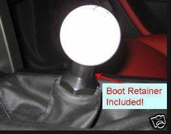

Still looking for a vendor that makes the Delrin ****.
Loved it on my C5Z.

Are you talking about one that looks like this?
All you really need is an adapter to fit the threads.
Core Shifters could make you one..
