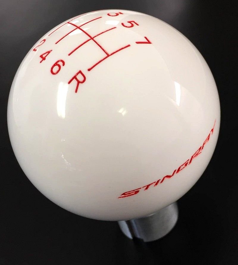

Installed this cue ball last night, took about 10 minutes and I know nothing about changing stuff etc.
purchased this off ebay, forum member SCCARACER46, a pleasure to deal with item as described and fast shipping. He also went out of his to explain install better than the instructions provided

Looks old school John.

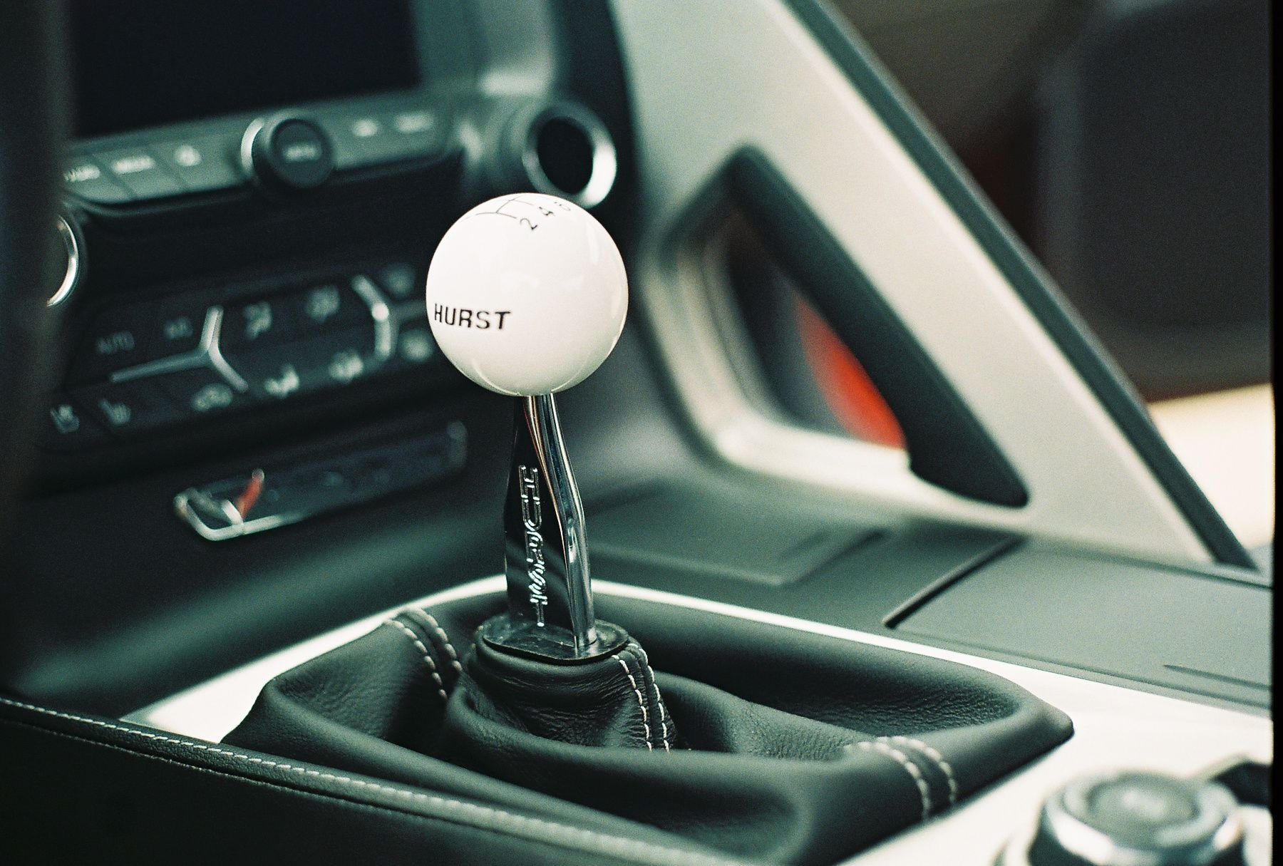

This is old school....
Had it in my C5Z06, and moved it to the C7

yes! Was thinking that, I'm 36 so I wouldn't know. my dad said the same. Chevelle days and such. I like it for now.

thats nice! Someday I'd like to get the highly recommended MGW with flatstick.

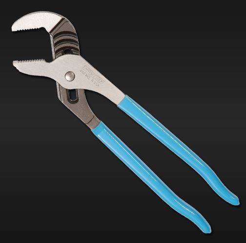

Channellocks

Yep, got plenty of those, and that's next up. I haven't even received the new shift **** yet so wasn't trying all that hard. I was just trying the 1/4 turn w/ thumb and forefinger.

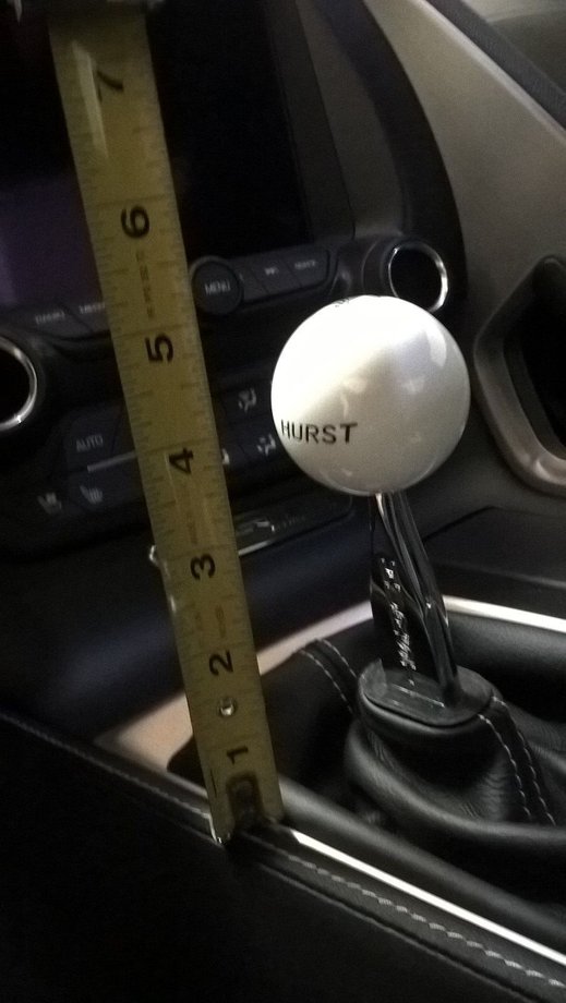

Mine seemed really tight, but with just a little extra above what I could do with fingers, it turned.
Does your new **** us the same collar?
When I took mine off the boot came loose from the ring. It was actually stapled to the plastic ring.
My shifter came with its own grommet, so no big deal.
Oh, and be sure you are turning it the right direction...

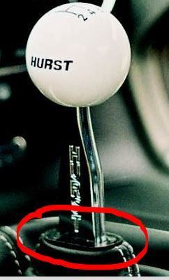

I think you need to "lift" just a tad before you turn.
Look closely t the shape of the slot above..

Thanks. Yes, it was a piece of cake. Once I put the channel locks with a microfiber towel around the ring it turned and dropped immediately with no damage to the ring. The boot stayed attached to the ring.

So, is it about 4 inches from the console?
