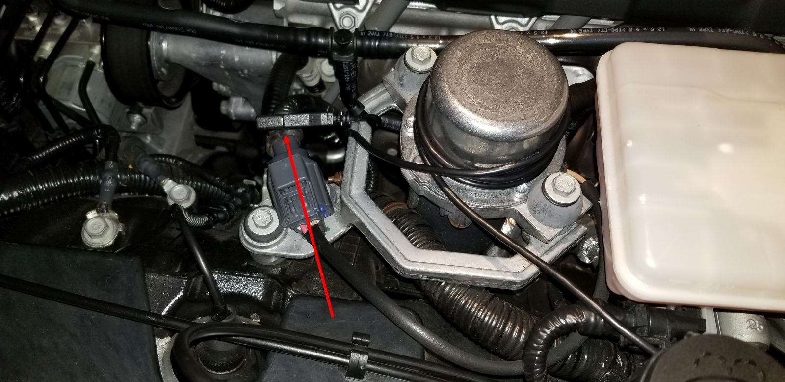

I used plain old WD-40 on the Controller pins as a Lubricant.
This was to prevent the pins from galling, bending, or being forced down into the Controller when inserting the Controller into the wire harness.
My USB cable has been plugged in for close to 7000 miles in all weather conditions.
Including a 3 hour drive in Torrential rain and steaming hot days in Florida.
After multiple pdts file installs and 3-4 different Firmware installs back and forth, no problems.
The USB cable runs into the engine bay and looped around the Washer Fluid filler tube.
I did not use anything (grease etc) around/on the USB end that's plugged into the Controller.
But do have a zip tie securing a rubber tip over the other end in the engine bay to keep it clean.
Also because if that end is not covered, I presume it's powered up when the cars running and could possibly ground out, maybe ?
As far as heat affecting the cable or the Controller.
IMO, It should not be an issue whether the cable's in the engine bay or not.
The cable and Controller, are still subject to excessive heat in the fender sitting next to the engine bay.
And the heat also flows over the Controller as it exits through the Fender Vent
Just my experience and info for what it's worth
PS: anyone needing rubber end caps, do a search for .. Round Vinyl Plastic Caps ... lots to choose from in all sizes

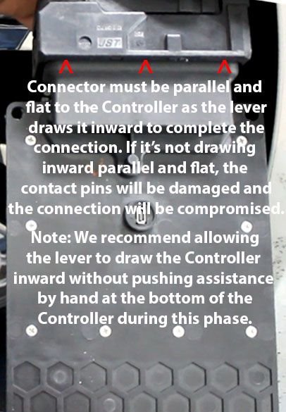

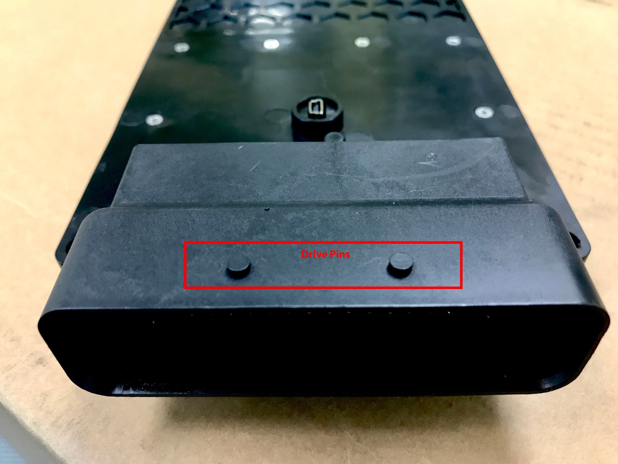

We would like to take this opportunity to chime in on the thread and help DSC users diagnose the “Service Suspension” light by illustrating potential causes. When the service suspension message comes on, it is typically the result of a contact pin in the connector having a poor connection. Below are items to look for as well as installation tips.
Pin Lock- Pin Lock is the white plastic rectangular frame that locks the female contact pin in place in the factory connector assembly. The Pin Lock is also a guide for the connector and the controller. When installing the controller, make sure the Pin Lock is seated flush onto the factory connector assembly. An unseated Pin Lock will cause misalignment of the contact pins (shown in Figure 1). (MAKE SURE TO VERIFY ORIENTATION OF PINS TO WIRING HARNESS CONNECTOR. It is possible to install the Pin Lock backwards to the controller!)
Drive Pins- Drives Pins are the four dowel pins that are molded to the controller. When installing the controller make sure that the Pin Lock of the connector assembly is perfectly aligned onto the Drive Pins (shown in figure 2 and 2.1)
Lever on the connector- The correct way for installing the controller is by using the lever to draw up/pull the Drive Pins inward onto the connector EVENLY. You will be able to see right away if the connector is not drawing in evenly this is imperative; the connector must be parallel and flat as shown in Figure 3. DO NOT use your hand to assist the controller onto the connector while using the lever because the assist can cause misalignment.
Completing the Install- After you are sure the pins of the controller pulled into the connector evenly and fully clicked the lever into final position, give a GENTLE push on the connector to the controller (as shown in the video below).
Misalignment of Contact Pins- Mis-aligned pins (pins are not the right height) after the DSC controller install (as shown in Figure 3), if this is the case, you can pull the mis-aligned pins outward back into position with a small needle nose plier. If you don’t feel comfortable doing this procedure we ask you immediately contact us so we can further assist you.
As shown in Figure 1 mis-aligned contact pins. This indefinitely can issues and service suspension warnings. Figure 2/2.1 show the drive pins and how the contact pins may all be straight, but the key is to check that the orientation to the wiring harness connector is correct and the height of the pins to be within reasonable tolerance. Figure 3 explains the process of drawing in the controller using the wiring harness connector lever (it must draw up perfectly even!!!). We have first hand seen that if any of these steps are overlooked it can cause contact issues.

We want to provide this link to a video on our YouTube channel of the DSC Controller install on a customer’s C7 Corvette to explain the install procedure to draw the controller into the wiring harness connector.
DSC Sport C7, Camaro, and Mustang Installation (Connector)
We have reviewed the entirety of the thread and wanted to assure this has only happened on a small percentage of controllers. The WD-40 will help only with contact issues and the lube reduces friction which makes the connector go on easier. The main focus is to be aware of the pins lining up correctly and the use of the wiring harness lever for proper installation.
