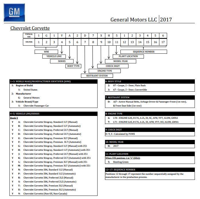

C7 VINs include a code that indicates trim level, transmission and Z51/non-Z51 or Z06:
2017 VIN Decoding:
This is an example of a VIN # for a 2017 Corvette Coupe (3LT, Z51, MN7):
1 G 1 Y L 2 D 7 X H 5 1 0 0 0 0 1
There are 17 characters. Starting with first character on left the codes are:
01. "1"= Built in US
02. "G"= General Motors
03. "1"= Chevrolet
04. Denotes the car line: Corvette is a "Y" body.
05. Provides more info about the car:
.. A=1LT M/T
.. B=1LT A/T
.. C=2LT M/T
.. D=2LT A/T
.. E=3LT M/T
.. F=3LT A/T
.. G=Z51 1LT M/T
.. H=Z51 1LT A/T
.. J=Z51 2LT M/T
.. K=Z51 2LT A/T
.. L=Z51 3LT M/T
.. M=Z51 3LT A/T
.. N=Z06 1LZ M/T
.. P=Z06 1LZ A/T
.. R=Z06 2LZ M/T
.. S=Z06 2LZ A/T
.. T=Z06 3LZ M/T
.. U=Z06 3LZ A/T
.. V=Grand Sport 1LT M/T
.. W=Grand Sport 1LT A/T
.. X=Grand Sport 2LT M/T
.. Y=Grand Sport 2LT A/T
.. Z=Grand Sport 3LT M/T
.. 1=Grand Sport 3LT A/T
.. 9=export (Non US, Non Canada)
06. Body style: "2" = Coupe, "3" = Convertible
07. Restraint code: D – AJ7 Active Manual Belts, Airbags – Driver & Passenger and Seat Side
08. Engine: LT1 = "7", LT4 = "6"
09. Check Digit – 0 to 9 or X
10. Model year: H (2017)
11. Plant: Bowling Green = "5"
12-17. Production sequence number that starts with the #100001 for each model yr. Z06s will start with #600001

Needs to be updated for GS cars. Position 5 = "Y" on mine.

Done. Original post has the updated info.

There are separate VIN decoders for each year. This one is for 2017.

Yes, but GM issues a new GM VIN Card each year and we have a separate thread for each year (links to each are in the Manuals, Reference Material, Online Order Guide, Order Tracking, etc. sticky thread) . Some letters/numbers were not used in some years. For example, there were no Z06's or Grand Sports in 2014, so those codes are not appropriate on a 2014 VIN Card.

Your sample shows "G" for the year (2016) when it ought to be "H" for 2017.

Thanks, fixed it.
