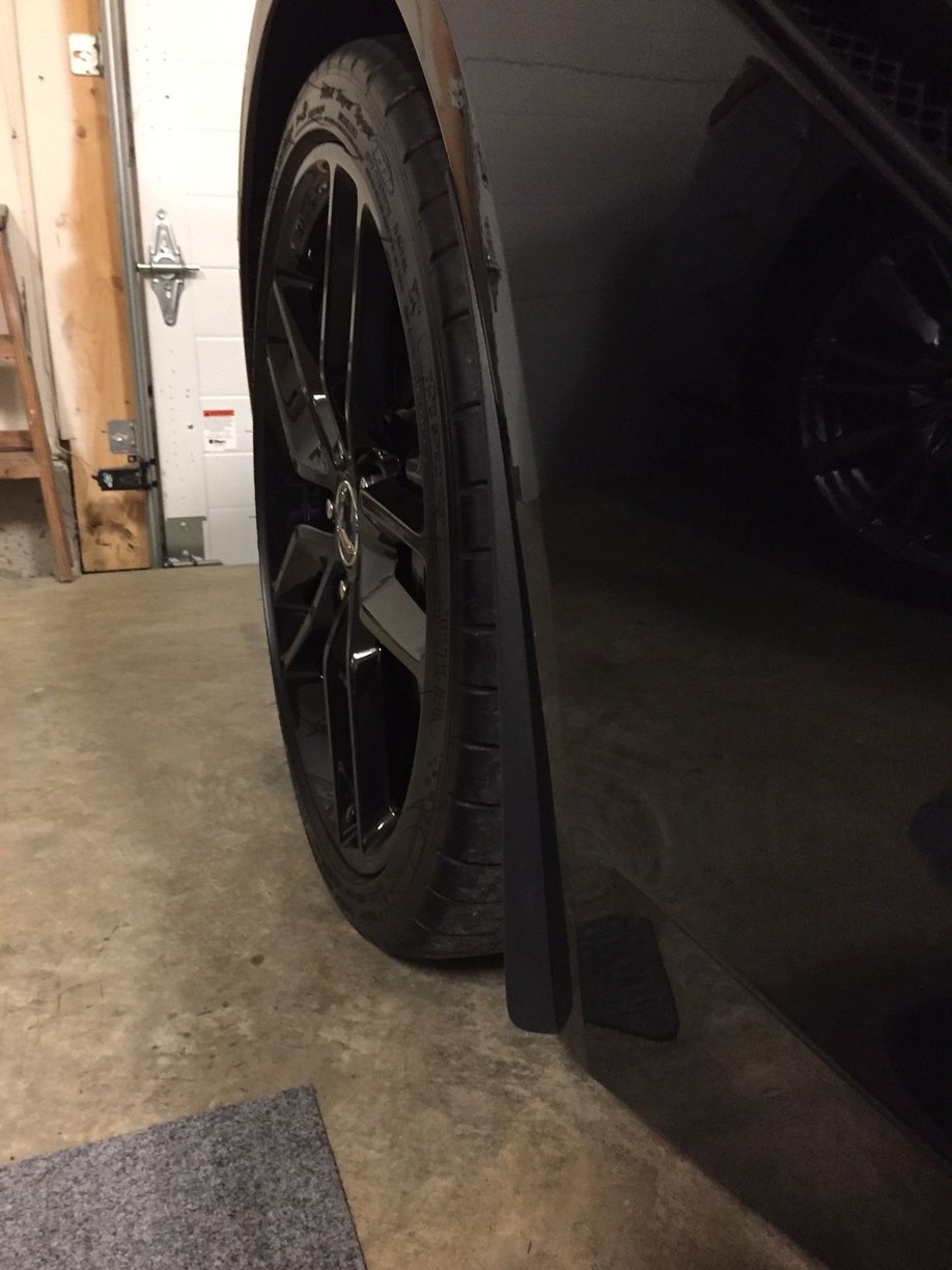

Originally Posted by snomuncher
Here are photos of the CRE flaps installed on a C7. They extend out far enough to align with the outer edge of the tires and are wide enough under the car to cover most of their width, most importantly under the painted rocker panels in the front.
How did you install the front mud flaps? Did you remove the factory mud flap/liner and utilize those mounting locations, etc.
thanks
Bruce

On both front and rear I removed the factory pieces and used them to template the holes in the aftermarket flaps once I finalized the installed position on the car. But before removing them I traced their outline onto the aftermarket flaps. To finalize the installed position on the car I used blue masking tape to temporarily hold them in place and also used pieces of wood to support the lower edges and ensure they were parallel to the ground.
I also trimmed the top edges of the new flaps to be slightly shorter and radiused. So the fronts are retained by screws and one push pin retainer and the rears by three screws. From the stone and dirt impressions left on the flaps by stuff thrown up by the tires, these flaps are absorbing impact across their full width and I see no evidence of rash anywhere on the car behind the flaps.
